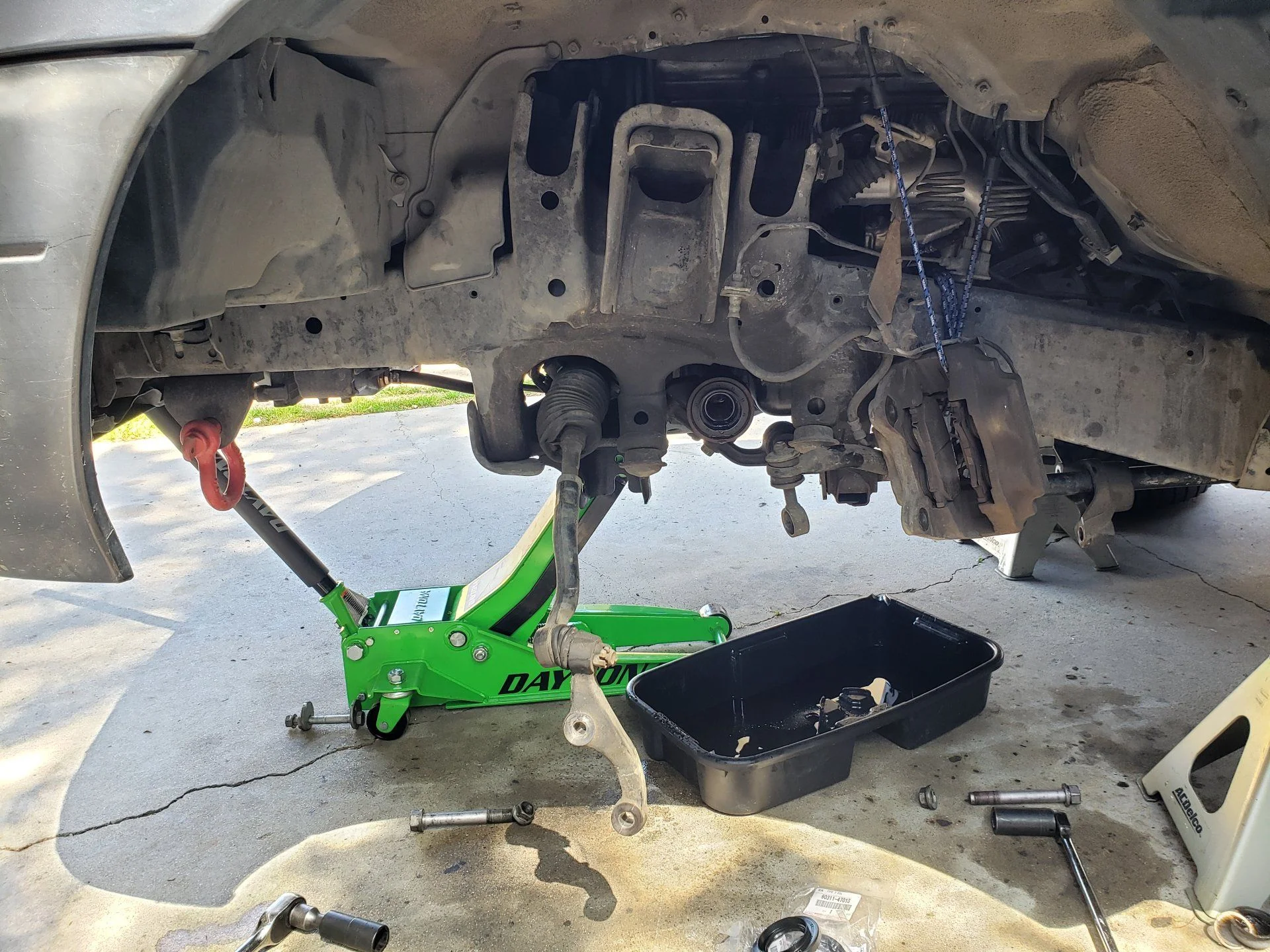

Lots of preventative maintenance this week.

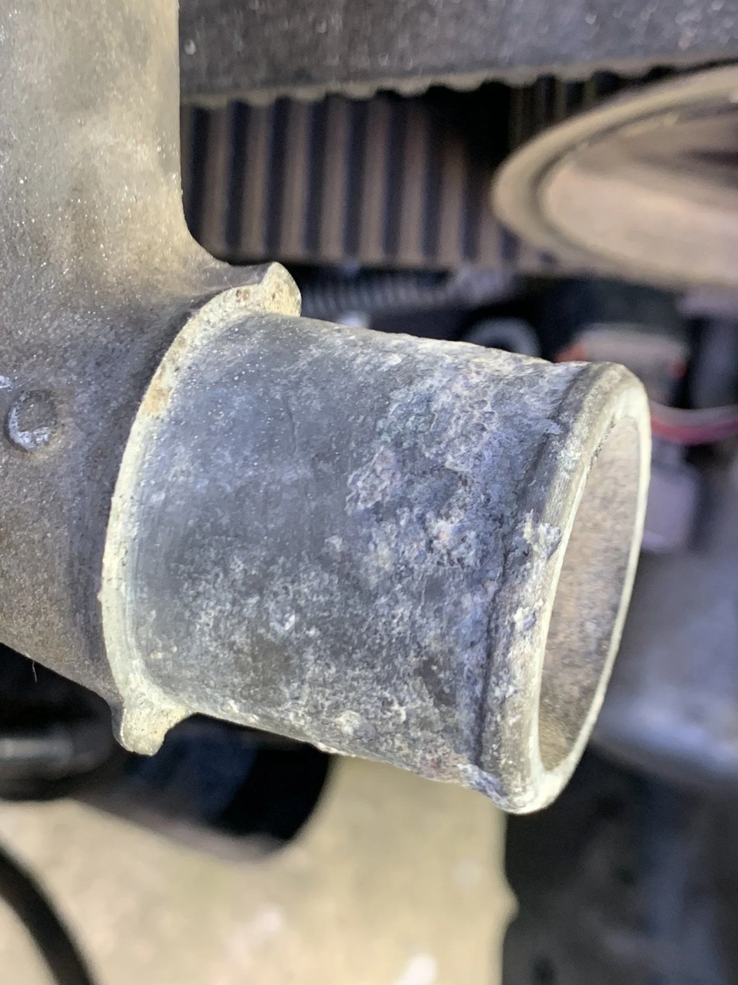

My upper cooling pipe (unsure of technical name) is blown to hell, can anyone recommend a filler they’ve had good luck with?

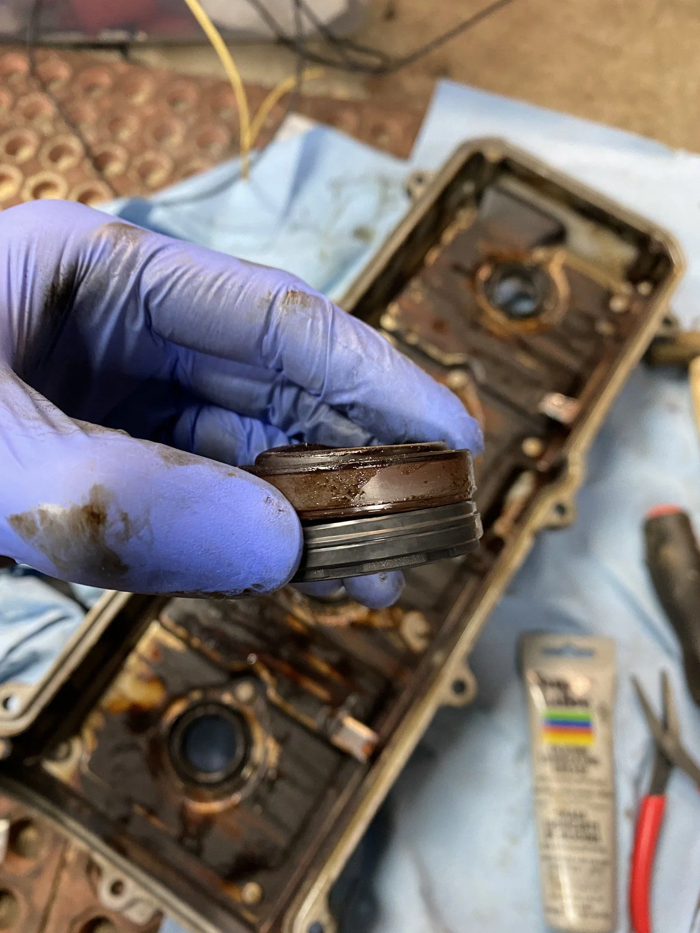

Finishing up install of the valve cover job and figured out the old spark plug tube seals are excellent drivers for the new seals. Rubber coated so they won’t damage the new seals and cup around the old seal nicely. :)

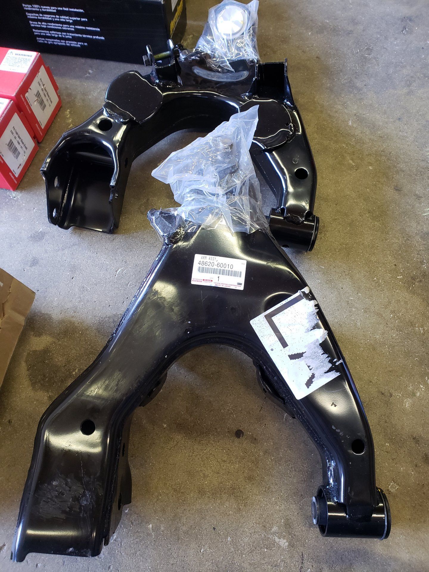

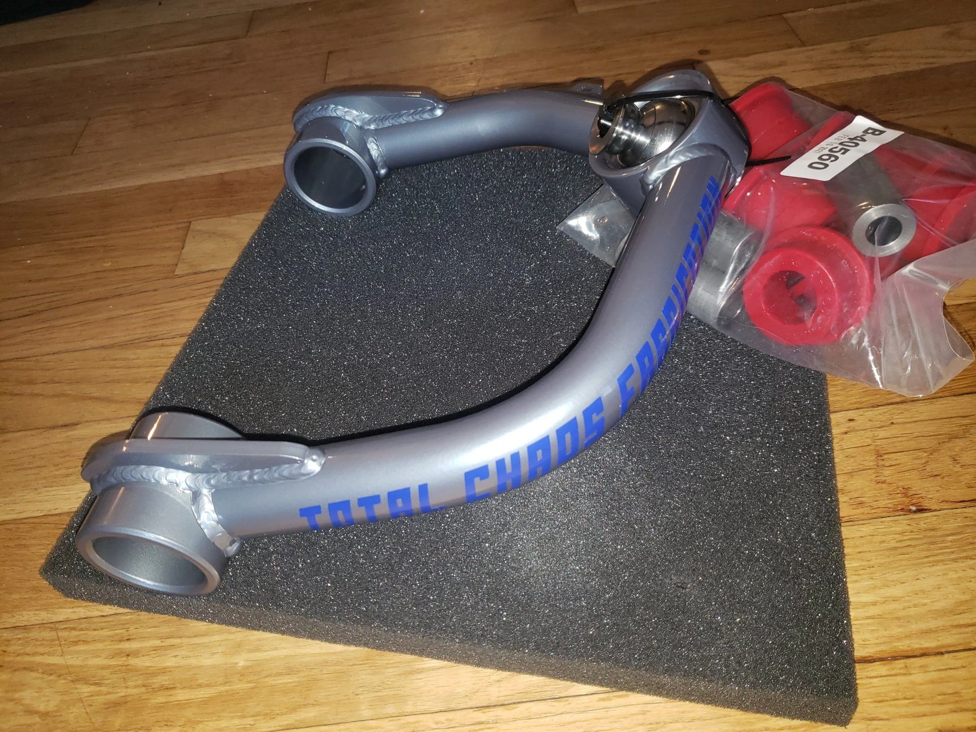

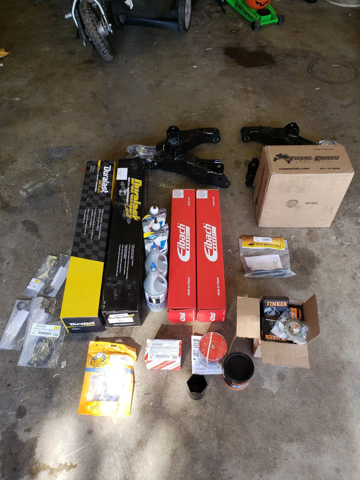

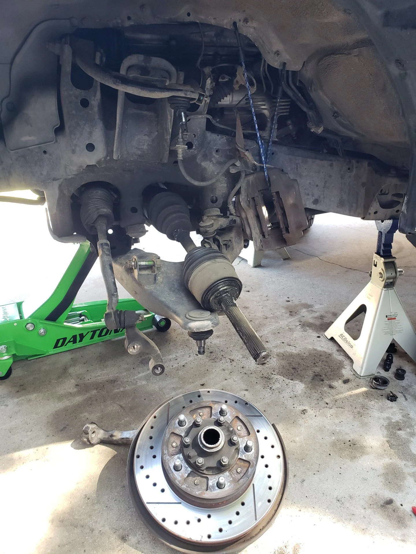

My UCA's arrived! Doing a huge list of parts in the front end starting tomorrow:
Eibach shocks
Total Chaos UCA's
New OEM LCA's
New rotors
OEM pads
Timken wheel bearings/races/washers
New CV Axles + axle seals
Changing diff fluids + t case fluid
LCA braces ARB/OME
THis happening to mine also, as well as some leaks still after I went to it with a file. I just shaved back the scum wiped it a few times. Made sure I tightened the hose clamp about 3 seperate times after driving. Replacement is probably better.
This happening to mine also, as well as some leaks still after I went to it with a file. I just shaved back the scum wiped it a few times. Made sure I tightened the hose clamp about 3 seperate times after driving. Replacement is probably better.
Yeah I will end up replacing it, but I dont think i need to remove the intake again to get at it. Right now im gonna seal it up w pifg; I need to get this pile running again :steer:
It will be very rewarding once you get it all buttoned up.
Are brake pads being replaced too?

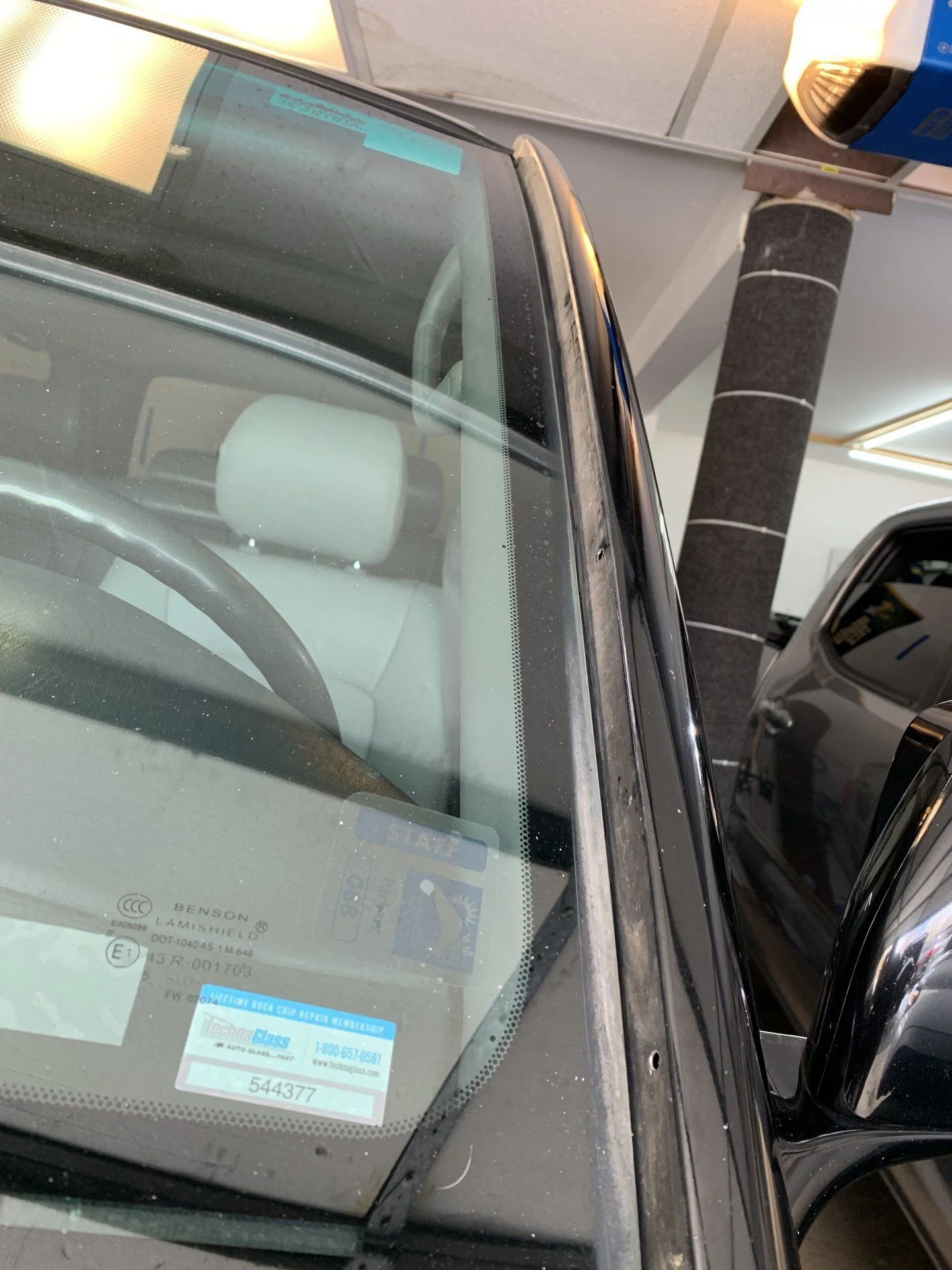

Took off my loose drip moldings and was pleasantly surprised to find no rust. The molding was bent and held in by only one T15 bolt (an interesting choice) and the wind noise was pretty bad. Thankfully it looks like the holes were only slightly enlarged by the screws. I have all new parts on order. Fingers crossed that I can get the factory rivets to work.
Anyone have a recommendation for a cheap rivet gun?
