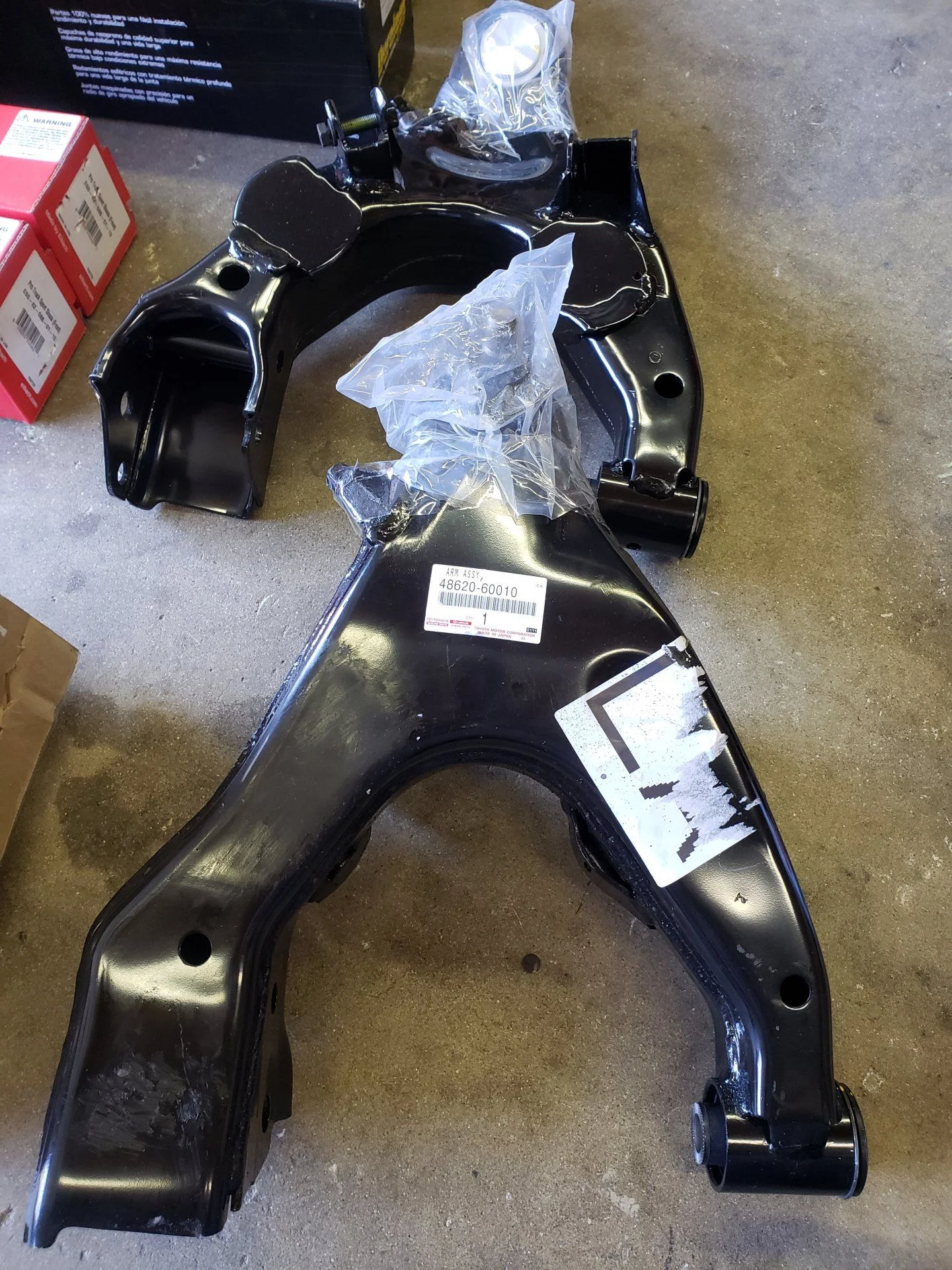

Did you get the other LCA bushing? Seems a shame to get that far and not replace it while you're in there.
ETA: I'm definitely not telling you what to do. Just mentioning it because it's not necessarily obvious that one of the bushings doesn't come with the control arm, so I wanted to make sure you had a heads up so you can get one if you want.

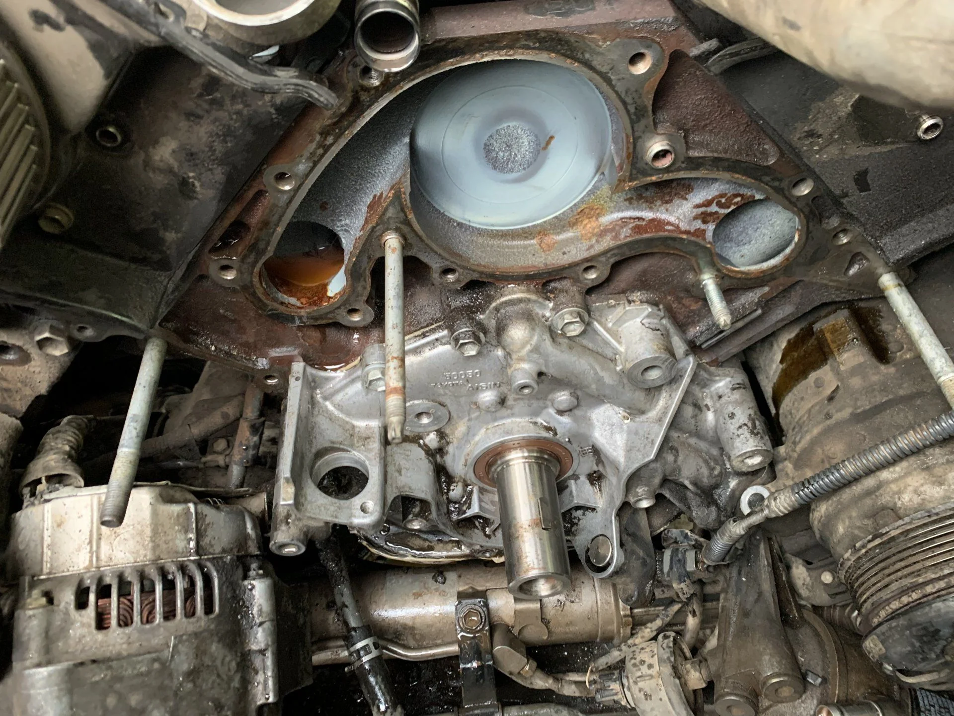

PO supposedly did the water pump and timing belt about 25k miles ago, but I seriously doubt it.
after market tb, the wp/gasket was in a terrible state, and the whole area around the crank was caked in oil and dirt. This is after an 18 oz can of non clor brākleen.
Vcg’s are new as of yesterday, cam seals are dry, crank seal is getting replaced.
how bad of shape am I in?
Thanks, but did not get that bushing. Inspected it. Is in good shape.
Not in too bad of shape since you caught it early, and assuming you replace everything with OEM Toyota/Mitsuboshi/Aisin/Koyo. However, there does appear to be some rust on the block and in the main cooling passages, suggesting PO ran straight water for a while at some point. Consider running some thermocure through to clean that rust out before putting new red coolant in.
Ok, great. Thanks for the tip! Everything goin in is what you’ve recommended above 👍🏼

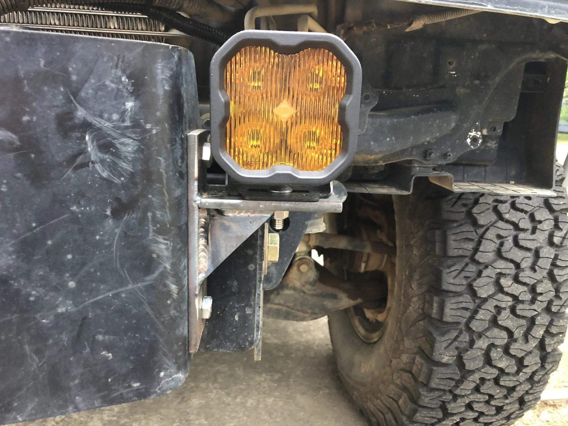

SS3 MAX fogs baby!!! Made some temporary mounts, and wired up with their “light duty off-road harness”. Should have just made my own but this works. Every inch is in split tube and heat shrunk, etc. They seem 5 times brighter than my low beams. I likes em!
I’ve since painted them, etc.
I am seriously considering to do this too. Did you get the sport / pro / max SS3? We drove through Cajun pass at night in San Bernardino CA and wife was driving, it scared the hell out of her, we couldn’t see anything because of the dense fog. I am running 55watts 6000k MiniH1 Morimoto projector clear lenses on my headlights and and Matchbox 2.0 35watts on the factory foglights and the light isn’t piercing through the white fog. I think I need an auxiliary yellow light that can do the job. Any output shots at night?
They are the Baja Designs Squadron Pro, Amber LED Driving/Combo . I figured with all of the work I put in to mounting them, I was going to step top from the Sport. I never got a chance to wire them up when my alternator took a dump taking the battery with it... now the truck is in the shop getting a replacement motor put in... long story. I've seen the lights on other vehicles and they are bright with a great light pattern.

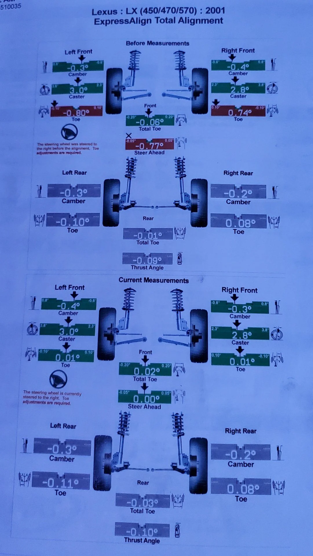

Got Blue a fresh alignment. Asked them to max out the camber caster and would you look at beautiful 3 degree camber caster on stock UCAs!
