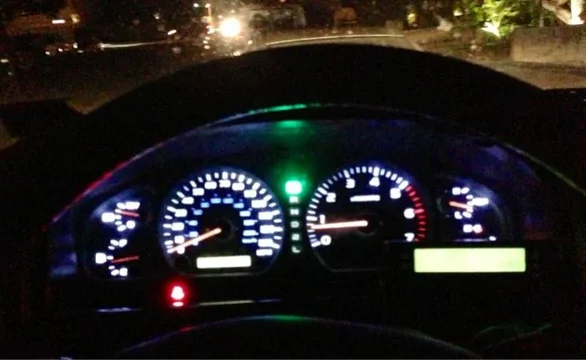

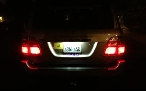

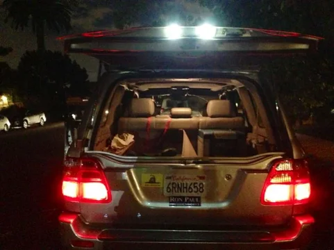

Replaced the dash lights with LEDs. Replaced the license plate lights with semi high powered LEDs and replaced the brake lights with dual stage LEDs. The new brake lights turn on noticeably faster and are slightly brighter. (I had the old lights in the tailgate light and the LED in the corner brake light. So I could def tell the delay).
Brake Lights: 3W Dual Stage Red 7743s http://www.superbrightleds.com/more...x-3-watt-high-power-led-w-reflector-lens/920/

License plate lights: 194 5 SMD wedge LEDs in Natural White http://www.superbrightleds.com/more...led-bulb-5-smd-led-wide-angle-wedge-base/206/

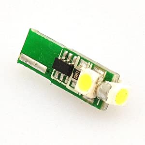

Gauge Cluster Lights: 6x 3 SMT T5 Mini Wedge Leds in White http://www.amazon.com/gp/product/B002XIQGR8/?tag=ihco-20
Just headlights on. Brake is not pressed.
Anyone know if the license plate lights can we wired to turn on when the lift gate is opened?
Do they dim? I did PFRAN's set up in my 1989 Grand Wagoneer, it's almost to bright for me to drive at night as I personally like a dark cabin at night.
Yeah they dim. The range seems smaller though. I have to figure out what the other dash bulbs are so everything matches. The brighter ODO and whiter numbers on the gauges look better IMNHO.
I left the D light burned out. That being bright would be annoying. I also left all the warning light bulbs OEM. Just changed the illuminating lights. there are 6 along the top. The cluster of three in the middle at the top are for indicators not illumination.
