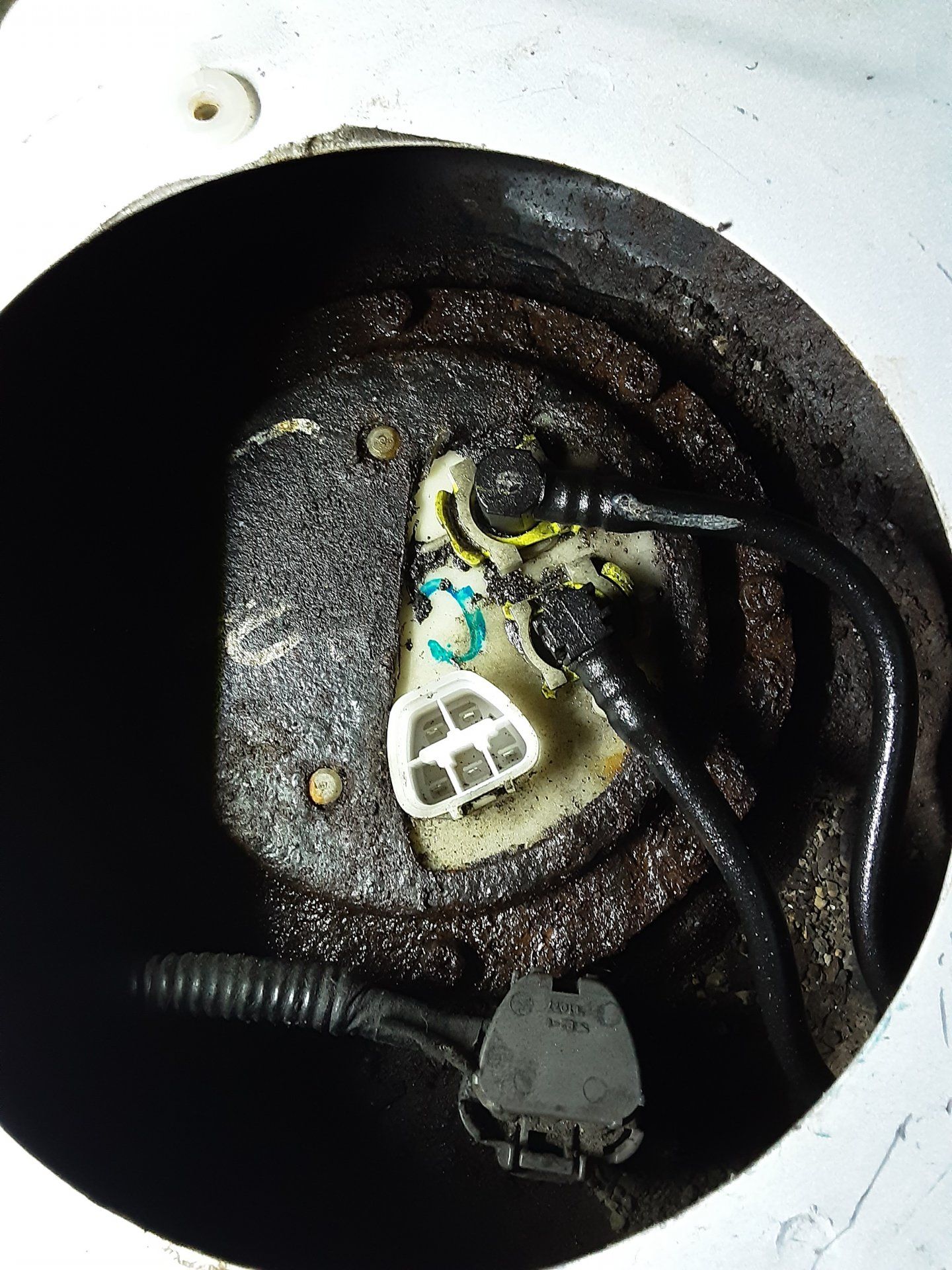

This week I went into the hell hole and replaced the original fuel pump on my 99 with 166k. This was one of the last foundational maintenance items, having done the timing belt, pulleys, hoses, etc.. this past summer. Also installed a pioneer 2600nex head unit and programmed a new key using techstream installed on my wifes old windows 7 machine (now dedicated to techstream). Rounded things out by cleaning the MAF sensor . Purrs like a kitten now.
As you can see from below, the hardest part was getting the small bolts that hold the pump onto the tank. Love that midwest salt. After much cleaning and copious quantities of pb blaster, all came off in good condition.
Damn urs is crusty!

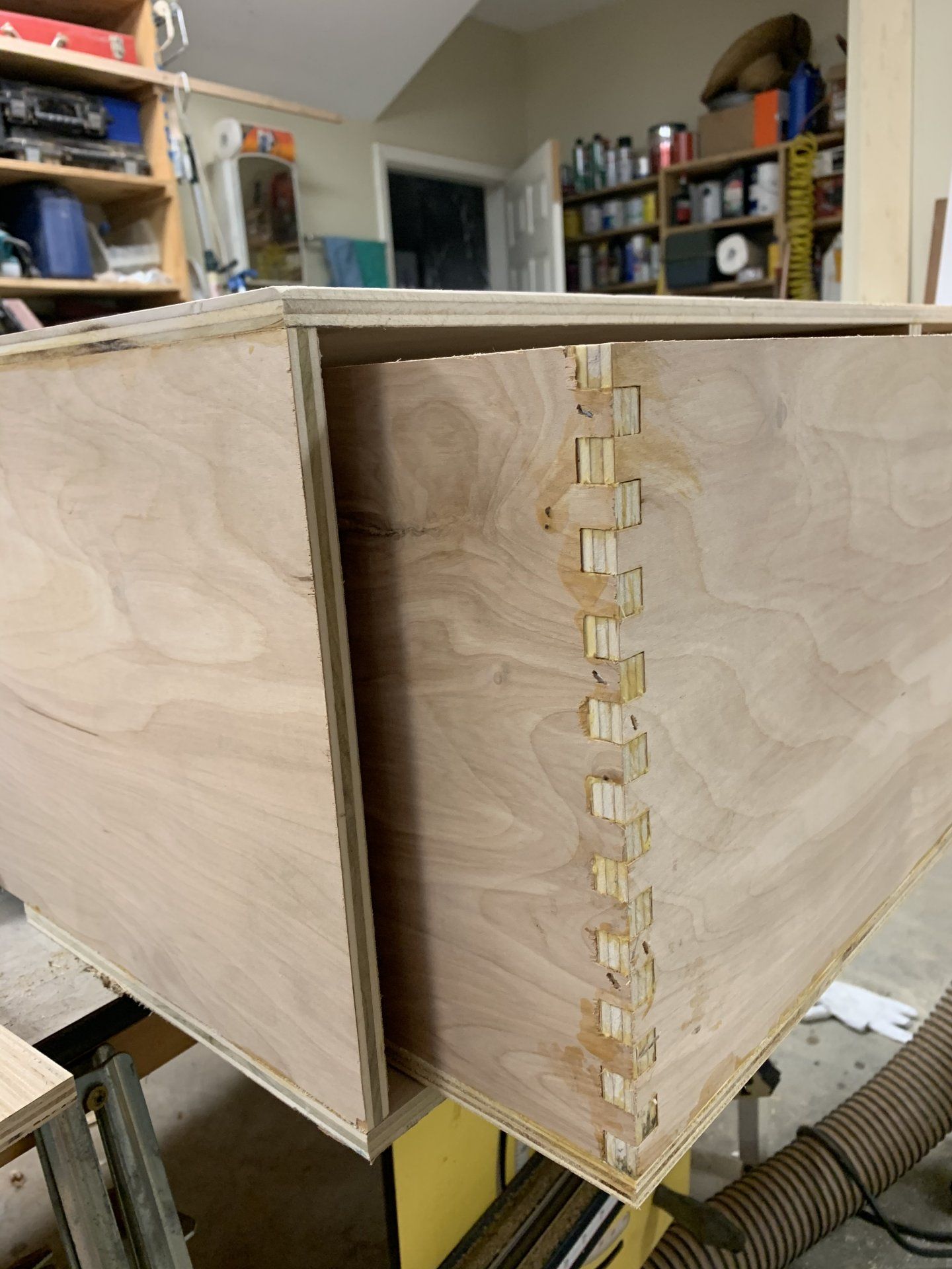

Just another drawer build. All 1/2 in cabinet grade plywood, lots of glue, staples and screws. Mahogany drawer fronts, waiting on slides to come in. No slides for the big drawers, just the fridge that will sit on top and the stove on the passenger side. Will post update when completed Happy New Year all, can’t be worse than the s*** show of 2020
