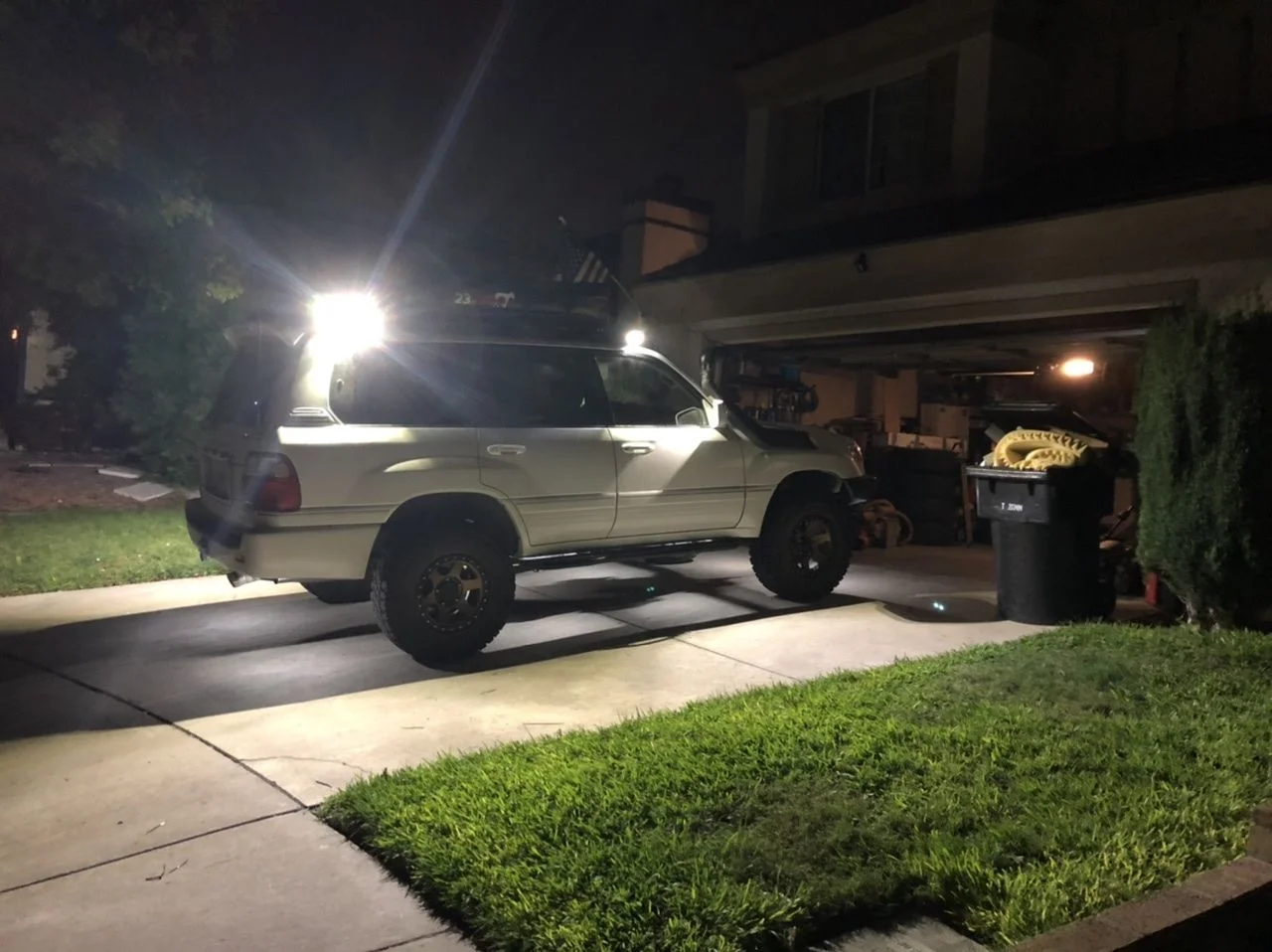

Added 10 hp
Beauty! When are they hitting the market?

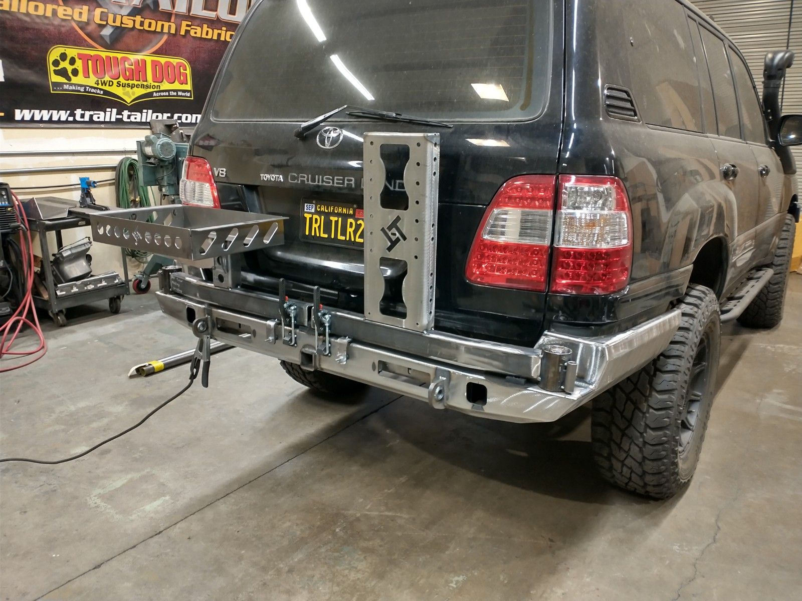

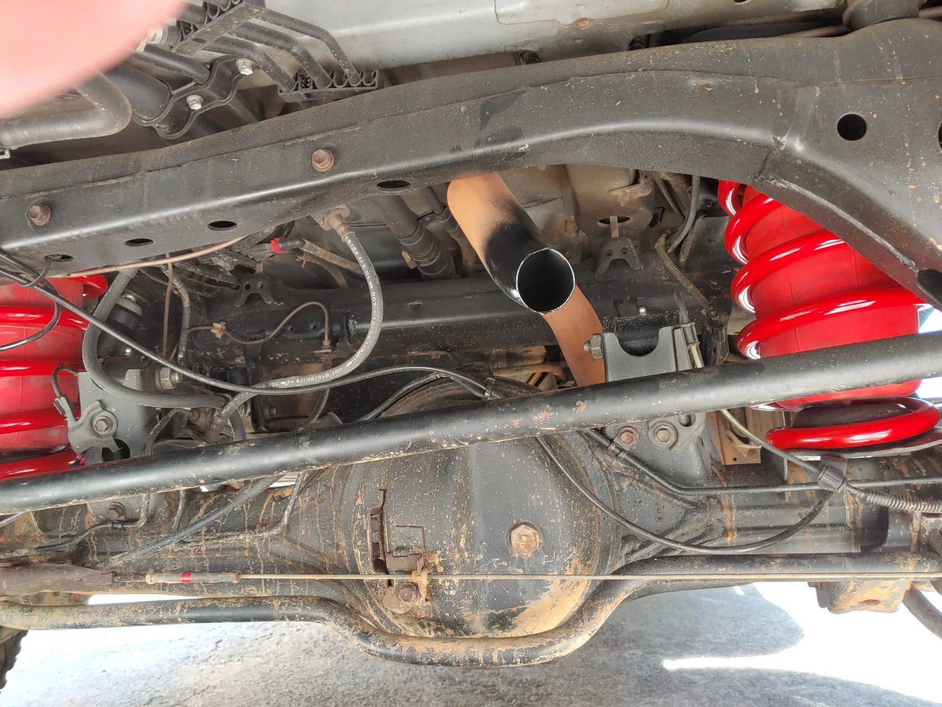

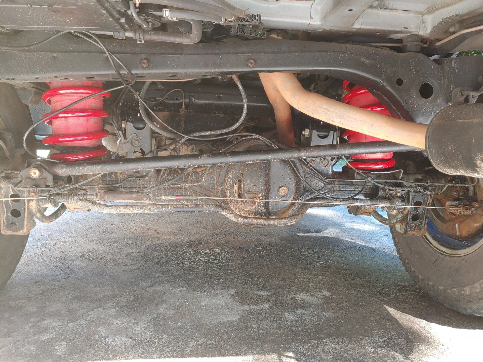

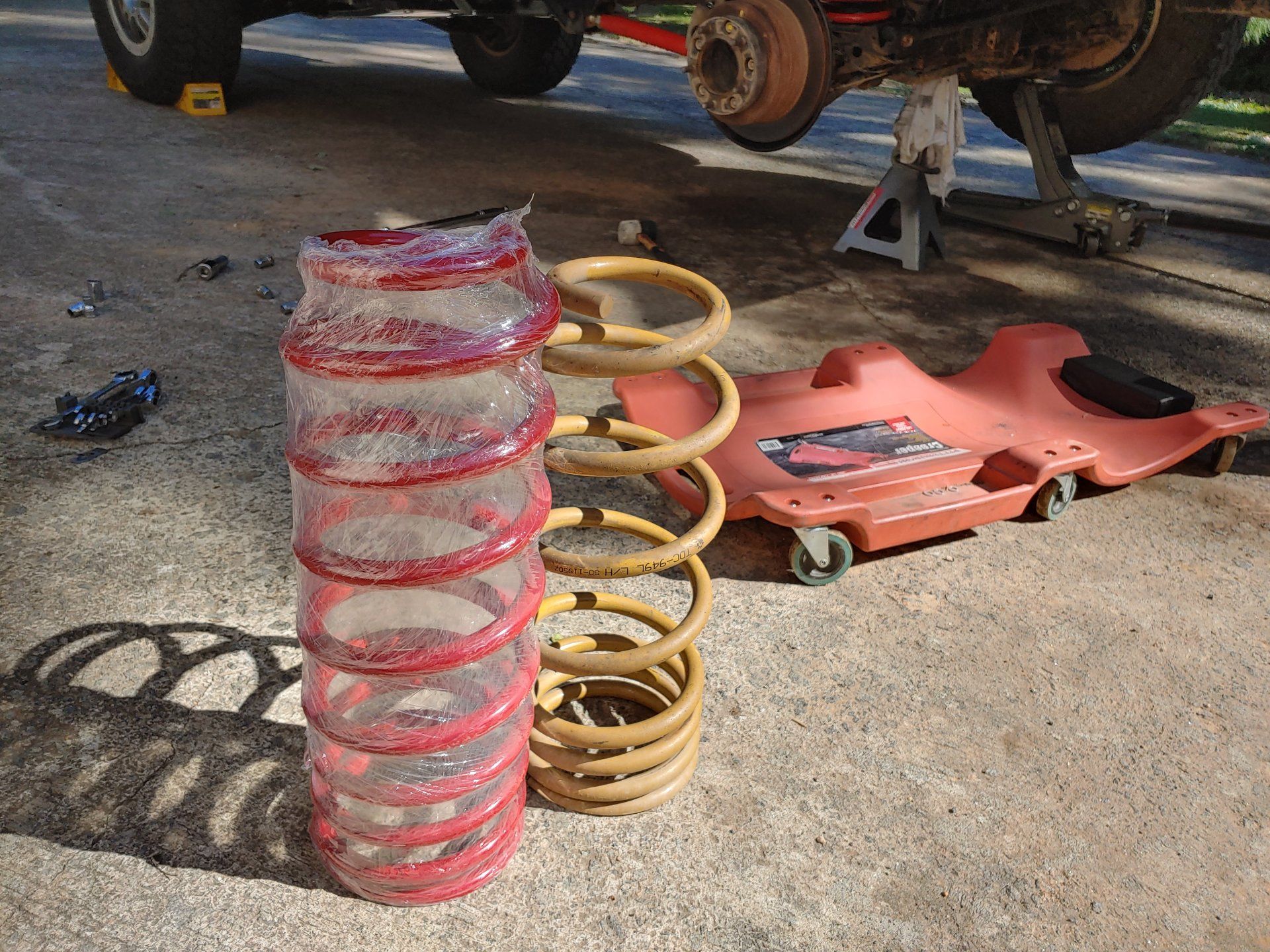

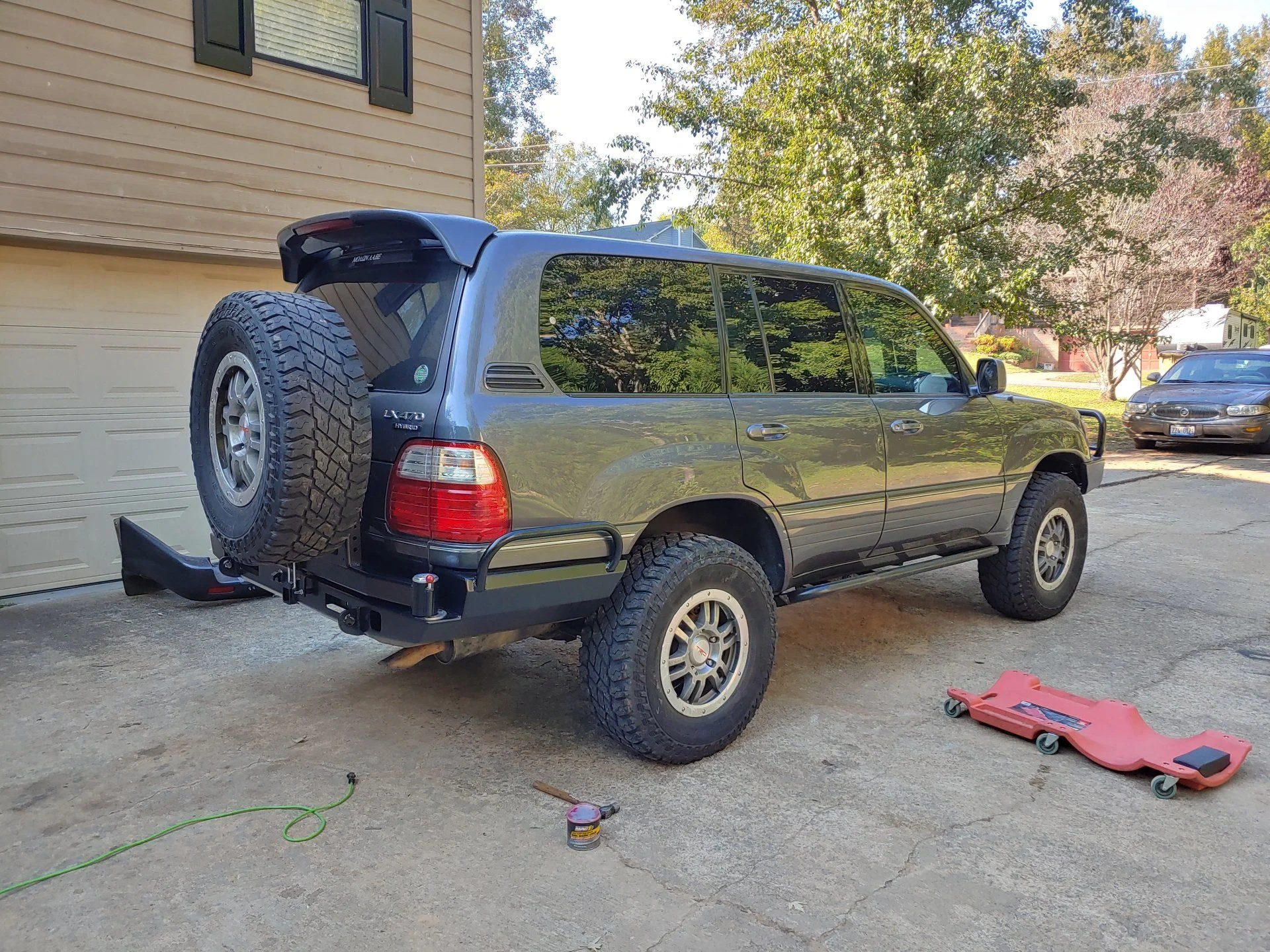

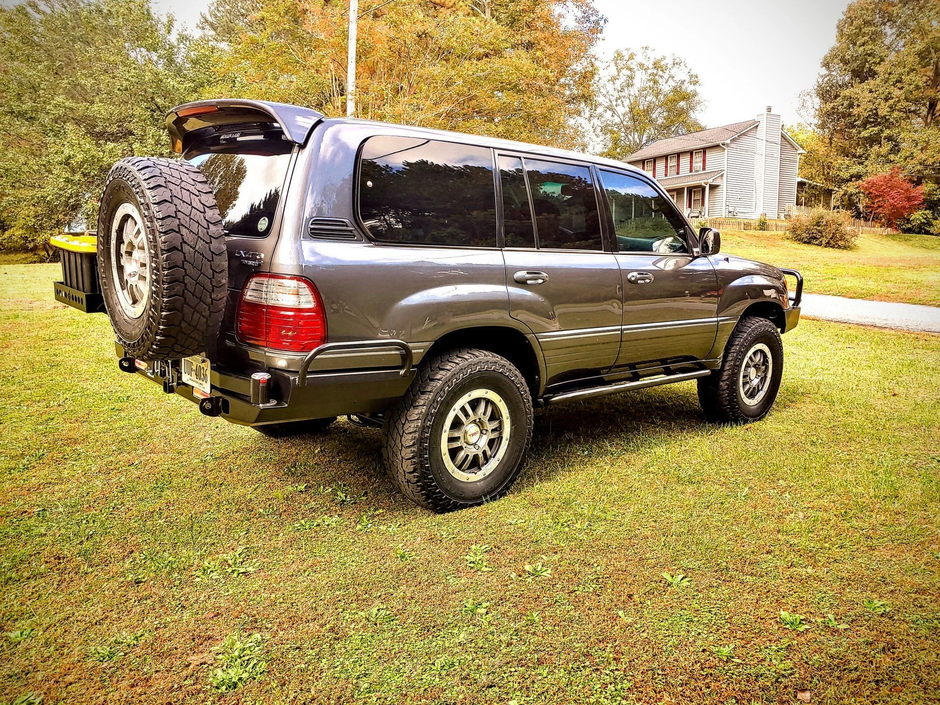

This week I installed new TourFlex springs, chopped off my mangled resonator, and installed the @TRAIL TAILOR rear bumper pictured elsewhere.
Shiny! I like it a whole lot.
One of the Best looking 100 series I’ve seen... awesome build!!

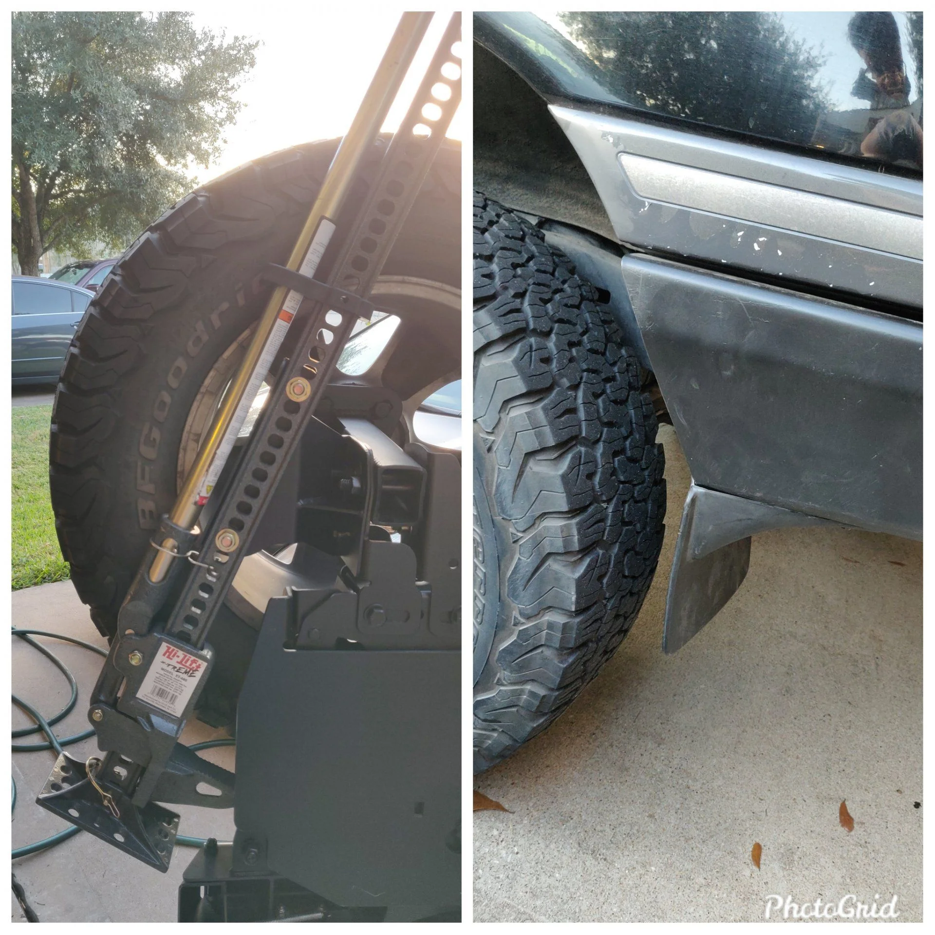

Installed hi-lift jack using dissent mount and, retrofitted factory mud flaps to the dissent. I know this won't a popular thing here, hoping this will reduce the number of rocks flying off from ko2s.
