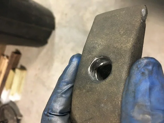

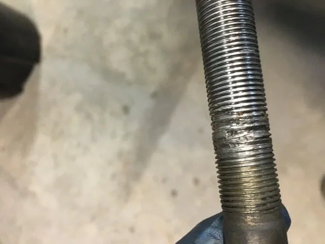

It was too tight...
It took about 6 full turns before it would loosen with an impact. Then I saw the threads that had been inside the adjuster were majorly boogered up. I got it apart, and half the threads in the adjuster were also bad.
I reindexed the bar (all that for only 2 or 3 teeth). I tried to put it back together, hoping it would hold for a few days, but no luck. When it got enough tension on it, the remaining threads stripped out (kind of exciting when it let go).
So, we’ll see if one of the local dealers happens to have a bolt and adjuster, and which leg they want for it. Otherwise I’m dead in the water until I can get them.
