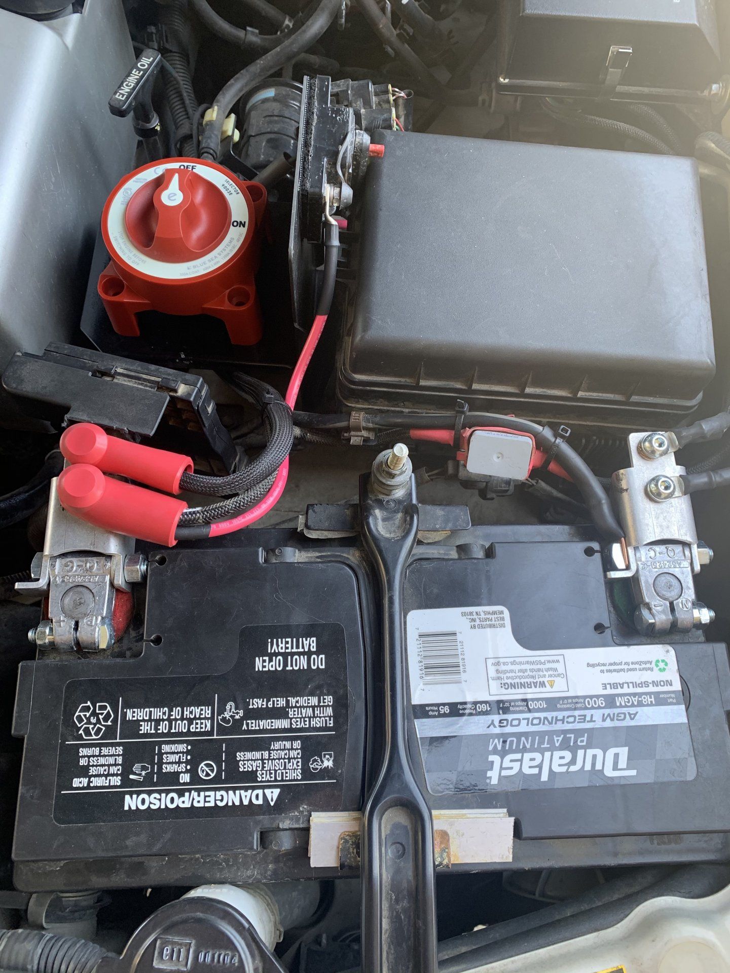

Spent the last few days taking care of all the battery connections. Often overlooked, but for safety and reliability, keeping all your connects in order is always a good idea!
Looks good, did you build the bracket for mounting the breaker and switch yourself?

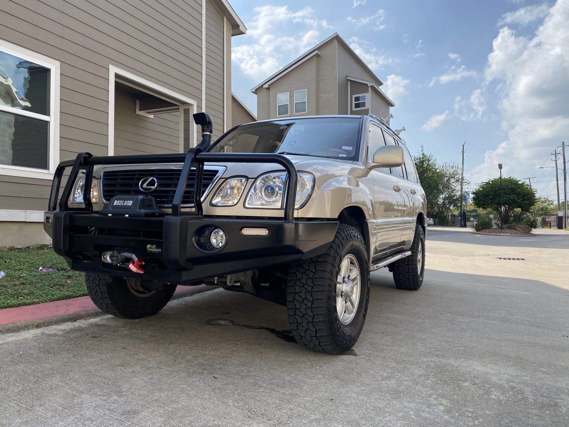

Finally installed my new Ironman4x4 front bumper and Harbor Freight Badlands APEX 12K winch.
This last photo is aligned just so, and it looks like you have a tiny snorkel coming off the bumper. For some reason, I want one now.

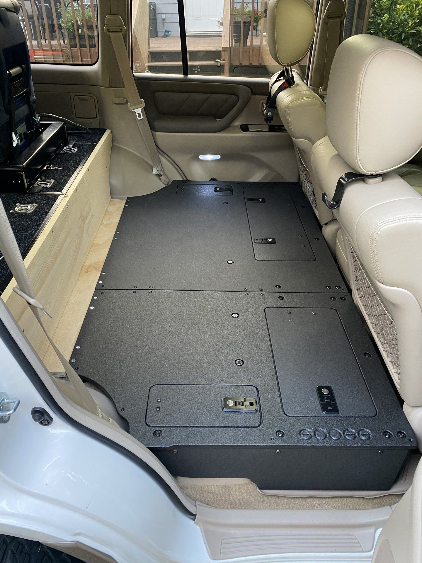

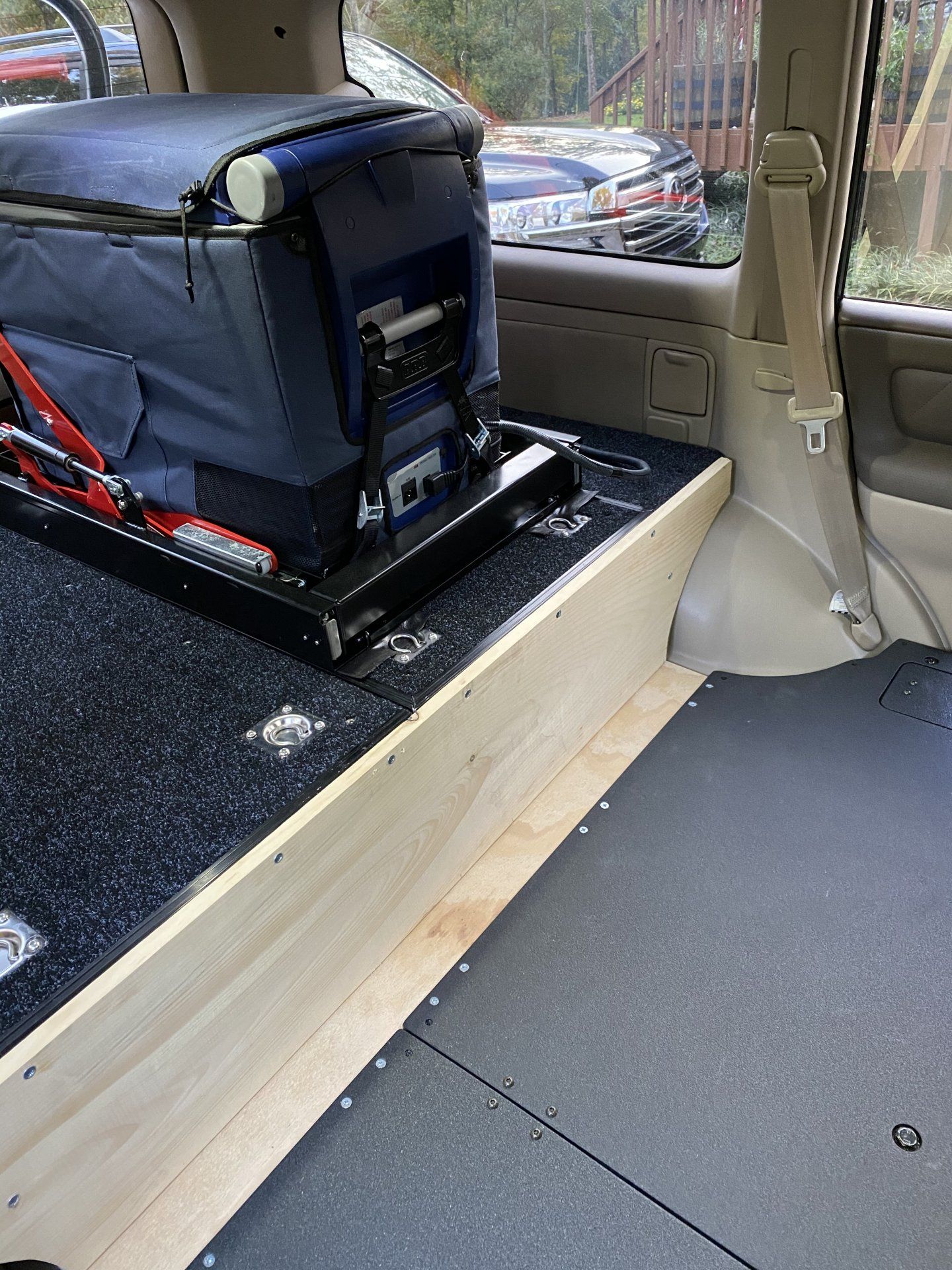

Was able to get my Goose Gear 2nd row seat delete in this weekend. Since I have a drawer system and not their cargo platform I had to do a little redneck engineering to tie it in to the drawer system. Still have some work to do and plan on coating the wood with a “Bed Liner” type coating to match the GG Panels. Happy with the way it’s turning out so far.

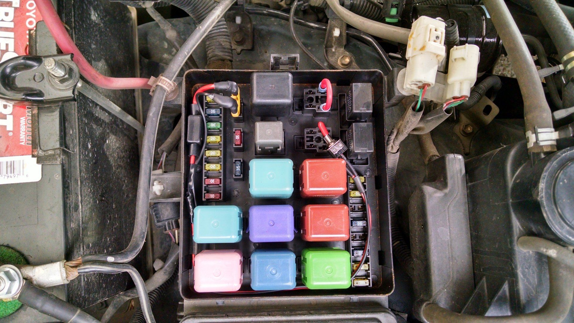

So I made a thing today....
For some time now, I've been concerned about the theft of my rig after hearing that even with the transponder key anti-theft system (that sounds impenetrable enough), Land Cruisers are still being stolen (even locally) by experienced thieves holding the right tools (replacing the computer, etc). Knowing that, I wanted to make it as difficult as possible to run and drive (here at home, or out on the street) even if that system was bypassed. Leaving the thief with either towing or pushing it down the street as the only way to move it.
I know it won't run without the fuel pump fuse intact and in place, so I made a harness the replaces it with a remote fuse wired to an on-off switch. Ultimately, it's just a deterrent for someone who actually knows how to diagnose, but who's going to do that? It certainly increases the complexity of stealing this particular vehicle- right? If somebody who really knows what they're doing goes looking, this is obvious. But the average dirtbag won't even know to look. If it doesn't start, that will likely be the end of it. Any thoughts on this?
wait what, landcruisers get stolen? first time I'm hearing that.

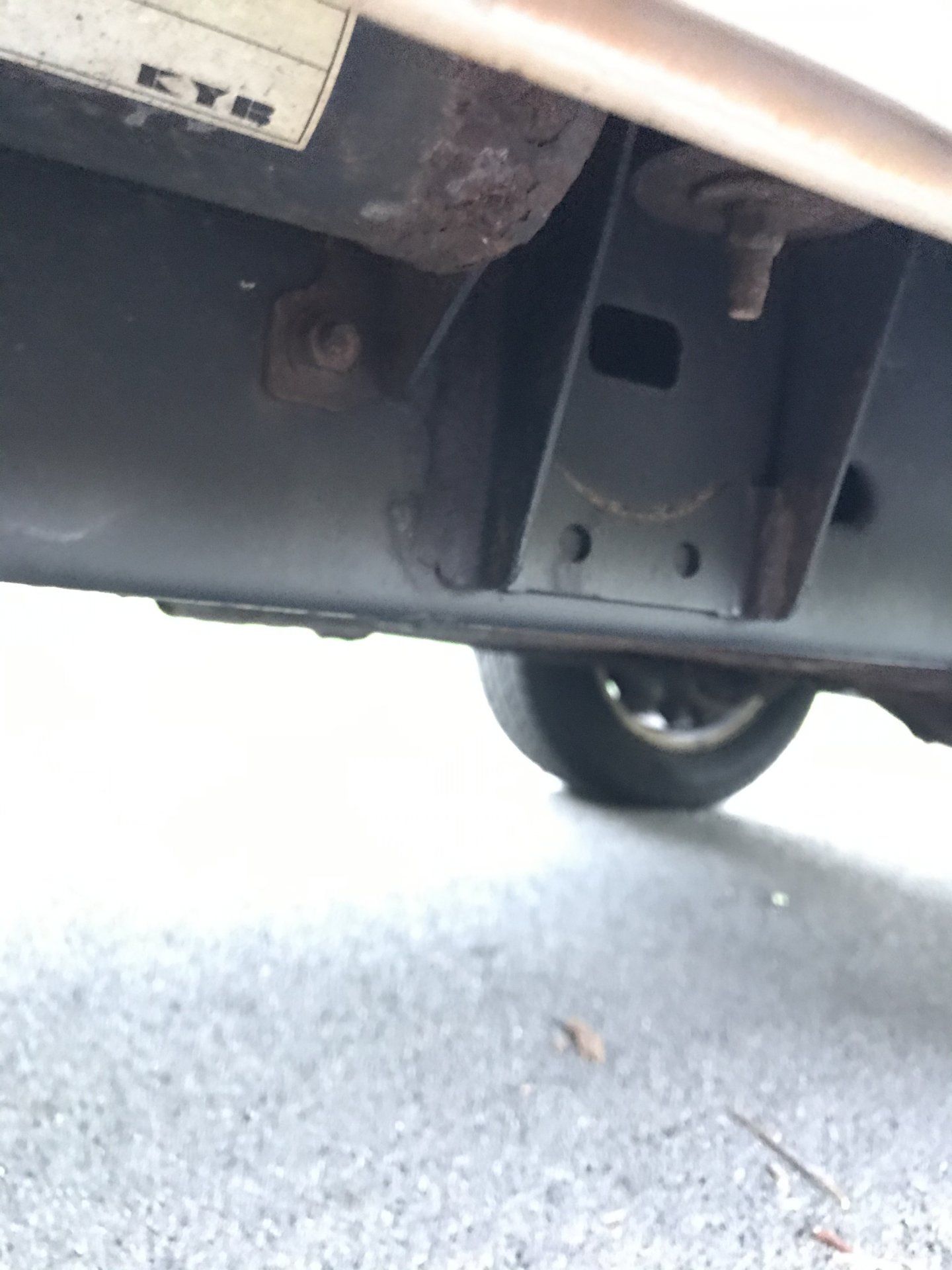

Hit the rusted exhaust resonator with rustoelum rust converter, very sastisfy to not see that rust when im walking up to the truck. Also hit the body mounts, didnt want to mess with the wire brush on the accumulator, but that rust is ugly
View attachment 2468095View attachment 2468096
maybe some Corrosion X or similar might arrest it.

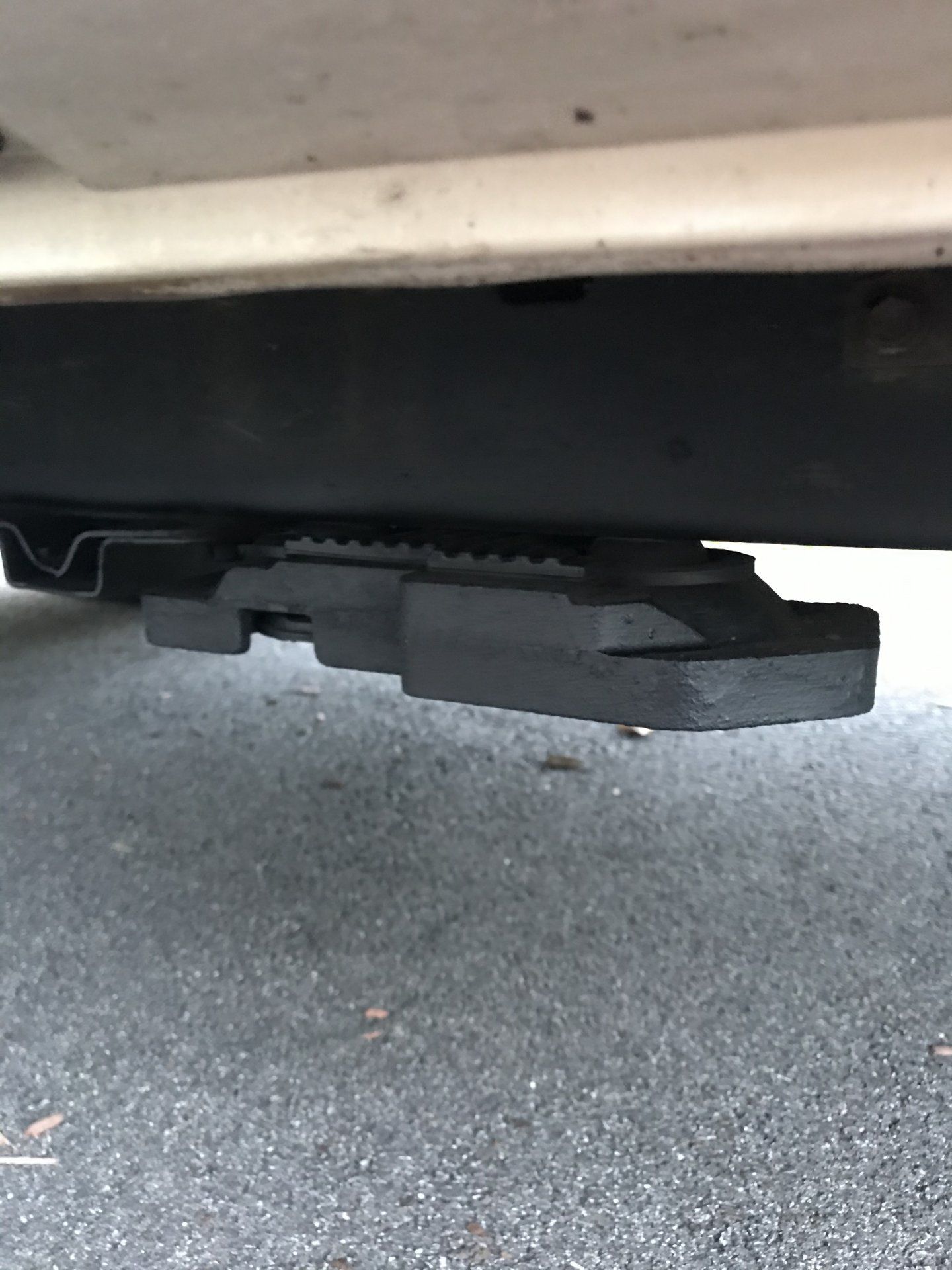

Reindexed torsion bar and replaced stripped adjuster and bolt. Cranked the TBs to have 1.5” droop. I wanted 1”, but ran out of adjustment on the passenger side, so I called it a day. At some point I’ll add weight to the back at it will even out.

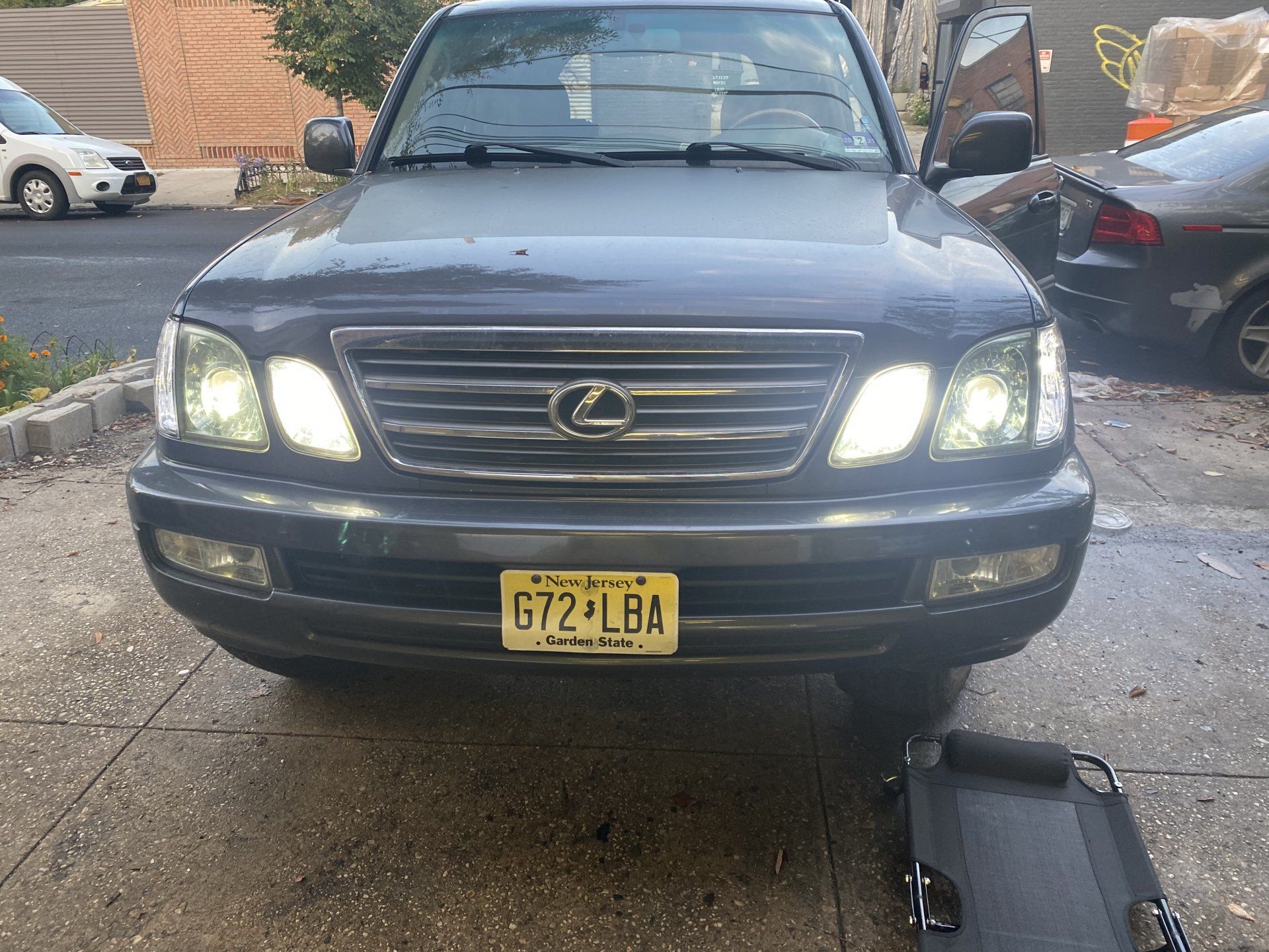

Found some prime day deals on led bulb replacements so I took a chance. Some were a tight fit in the stock housings and I’m not sure exactly how long these will last with their integral fans enclosed, but they look good for now and are definitely brighter.
