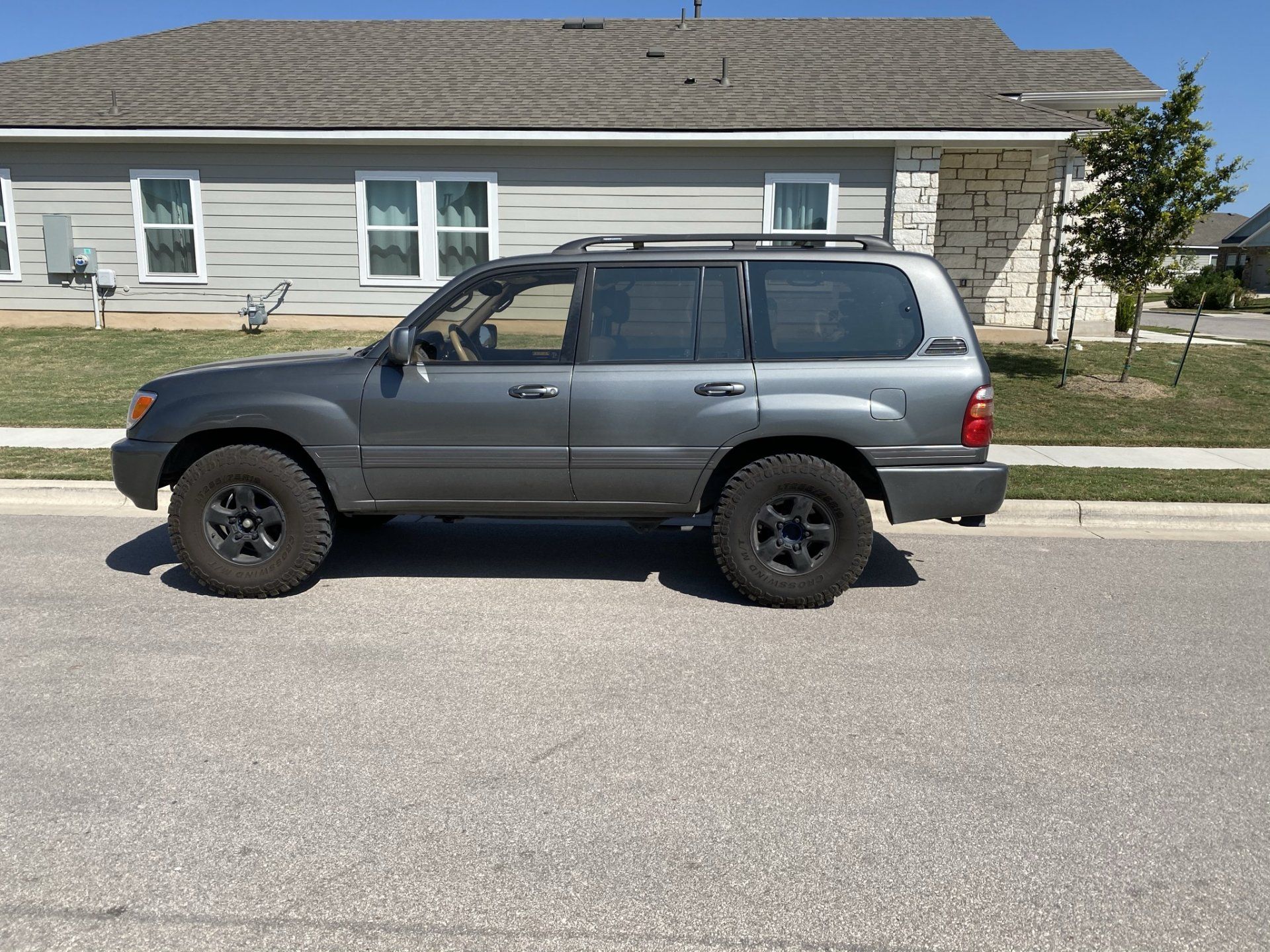

Thought some new 100 owners might find my cheapo lift with odd-sized tires interesting.
2006 LC
AHC has been deleted. Previous owner installed non-AHC coils / shocks, but left the AHC Tbars. This was a mushy ride. I installed / re indexed some standard factory Tbars and firmed it up.
30mm IronMan rear spacers with torsion bar crank.
265/70/18 Falken Wildpeak in SL rating (rides super nice, but might regret not going E)
Good enough for logging roads around the farm.
2006 LC
I have the exact same tire setup. Landed there because I spend the vast majority of my miles on the street, and the wife loves the comfy ride. Wanted tall ATs without going LT rated and gaining the harshness and weight. No issues whatsoever yet with the light wheeling I do. Couldn’t be happier.

Yep, DD ride comfort was also my worry. I was coming off a 1998 Grand Cherokee 5.9L with solid axles and stiff Bilsteins, so anything would have been better. I sometimes think I should have gone E load and never experienced the soft ride of the SL.
Have you done any suspension mods? Thanks very much
Nothing other than getting the ahc in spec when loaded with people/dogs, which for me required some coil spacers in the rear and cranking the Tbars. Rides like a cloud.
