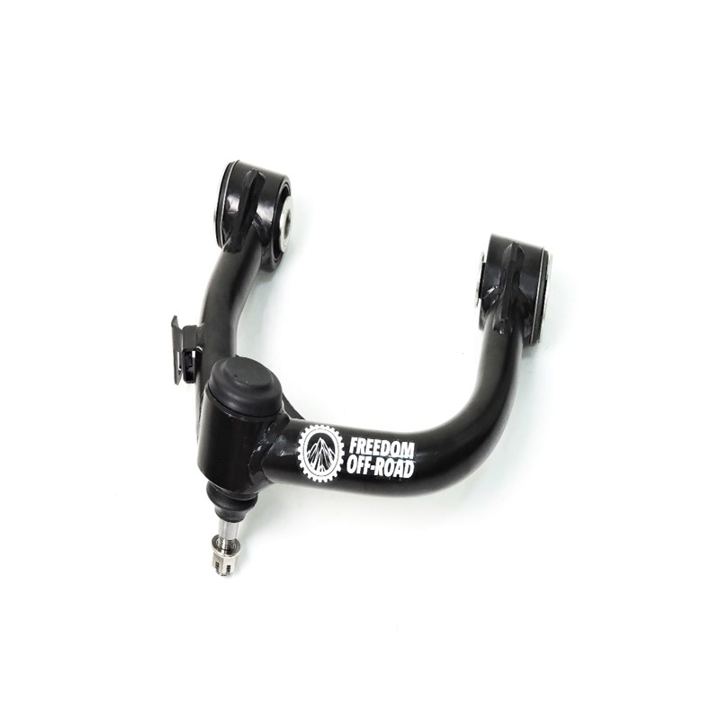

Also ordered a pair of Freedom Off Road control arms. They are back ordered but sent me an e-mail saying they are expecting to ship them out around 8/9.
