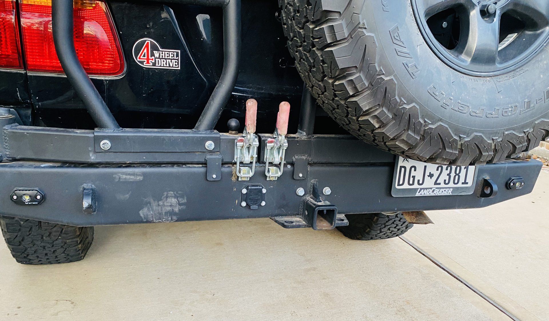

Installed 2 Stedi AU Rock Lights onto my BIOR rear bumper. Wired up to come on during reverse.
Will be mounting and wiring 2 additional lights soon to my Trail Tailor rear hatch brackets. Will have these lights controlled by my SPOD for when I need that extra punch of light or setting up my trailer at night.
