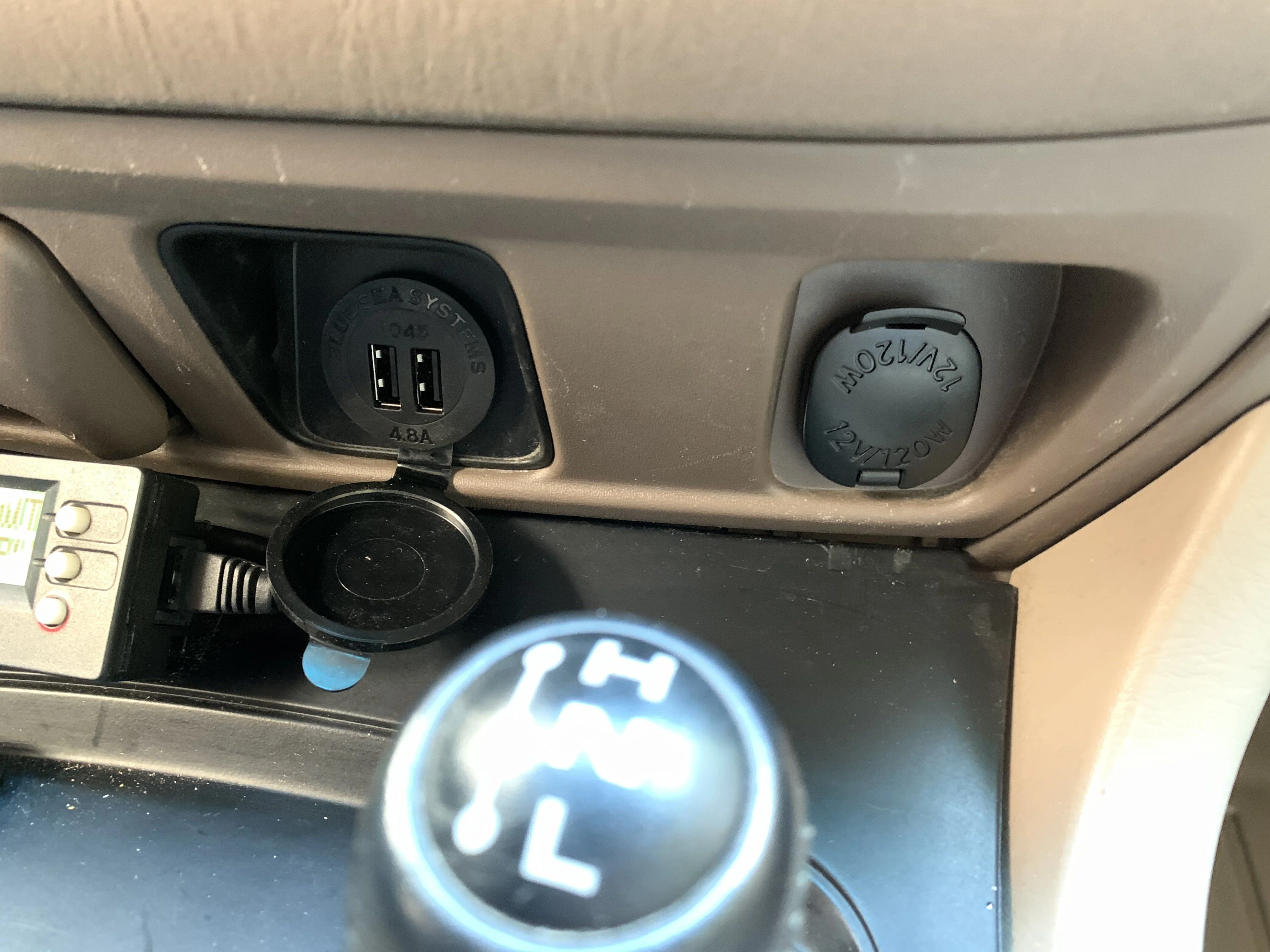

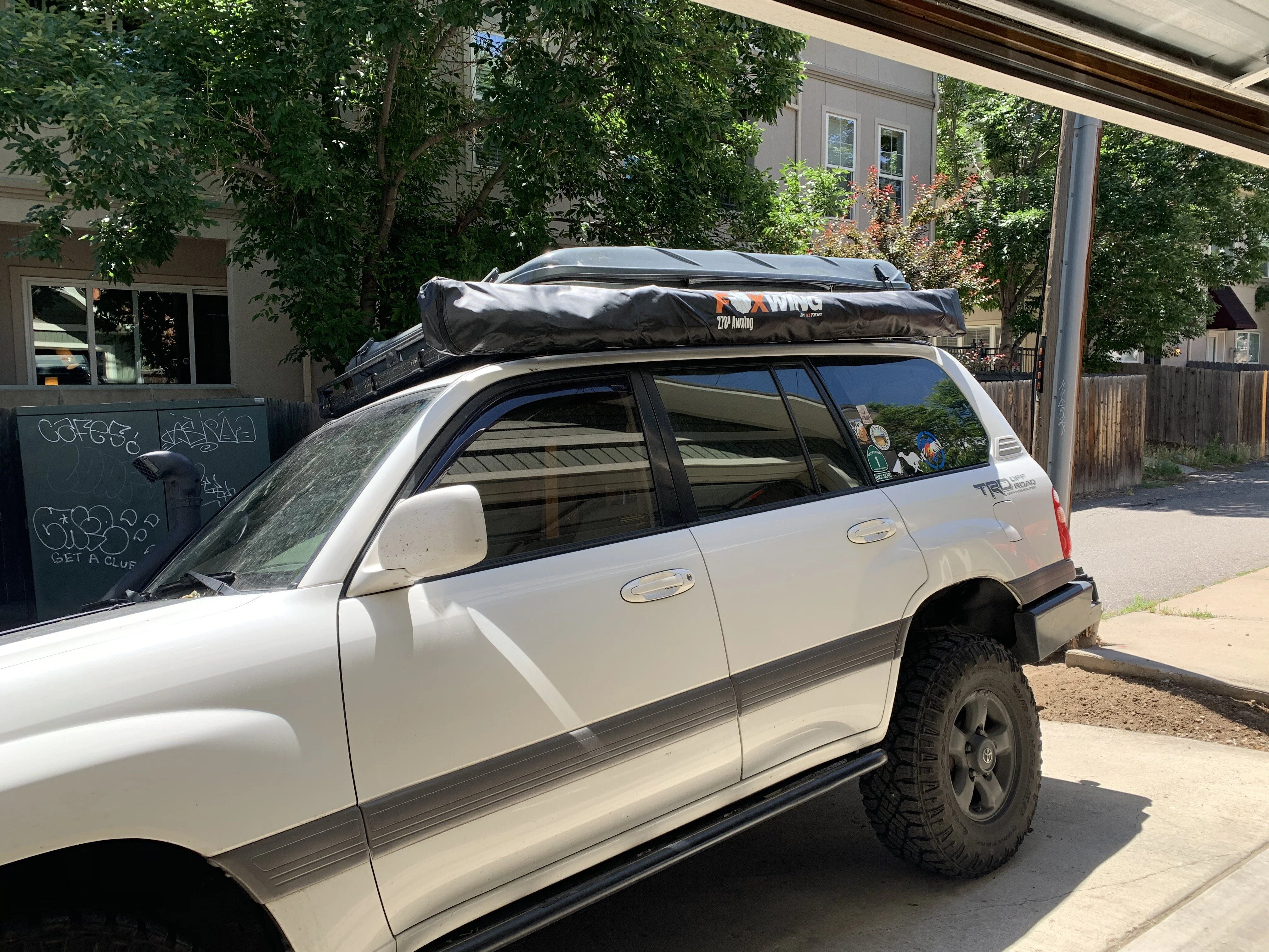

Got little minor things done....
- Installed new cover for the Foxwing awning. Old one cracked from UV.
- Installed a USB in place of the cigarette lighter and fixed the fusible link in the other.
- Installed a new antenna mast. Old one was bent
A lot of the of threads on here helped with the antenna and USB conversion

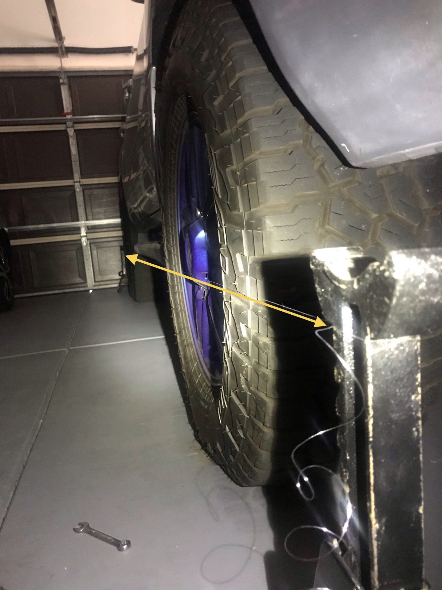

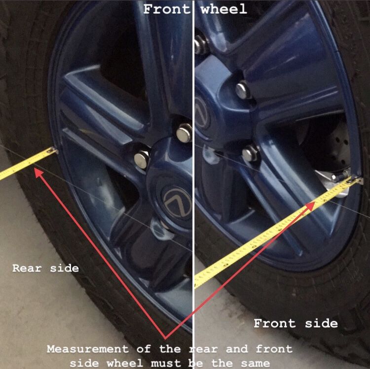

Easy Saturday morning lead to curiosity and me to aligning the truck on my own using basic principles of geometry and measurement. I recently replaced my upper and lower ball joints together with the tie rods using Sankei 555 products and the steering rack bushing using polyurethane ones.
As I inspected and measured obvious components such as the tire for camber, I noticed the front passenger was at +0.4° the front driver was at -0.2°. So I went ahead lifted the front, loosened the UCA nut-bolt and rotated the camber tab bolt to create that angle similar to that of the driver side. Lowered the truck, measured again and voila front passenger is now reading -0.2° - same now as the front driver side.
But toe settings are now off (it’s evident and clearly noticeable that the front passenger has reasonable amount of TOE-IN. I used a nylon line off one of our fishing rods, tied it on two jack stands -one situated at the rear corner of the truck, and one at the front corner of the truck and started measuring distances from the wheel in respect to the nylon line -it had to equal on both front and rear part of a wheel. I adjusted the toe in/out thru the Tie Rods. Every turn of the tie rod I had to stand up and reset the steering wheel (turn it left-right and re-center it) so as to make sure wheel is indeed straight. Eventually I got both passenger and driver side all lined up and measured to the last millimeter. Now truck is aligned and is tracking straight. Total time spent doing this was around 2 hours. Local Lexus charges around $200 for this job with all the fancy computers and tool. You can do it too, just allocate a few hours and definitely achievable.

Nylon line now on setup and has considerable amount of tension.
As I turn the inner tie rod (clockwise or counter clockwise) I made sure to get up and go to the steering wheel and turn it left & right make sure to reset it back to center. Once that was done I now measure the front side is close or the same now to that or the rear side.
