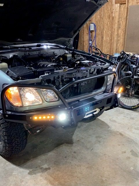

quite cool. need some shots of it in action, possibly worth doing :)
Thanks! Soon on the action shots I hope. Always seems easier to get pics of working on it than actually using it!
