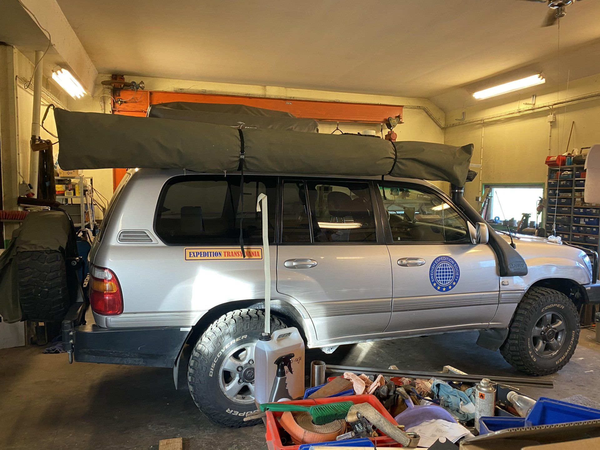

Spent one full day welding brackets for my Bundutec BunduAwn (2.95m) awning, put it up then thought to myself.. This is waaaayyy too biiiiiig..... Dammit.. Gonna get the short one instead... (2.45m)... :rofl:
Maybe if the cover were a different color, the size wouldn't be so in your face when stowed @FilleFloe. :hmm: Having all that shade must be nice though... :cheers:

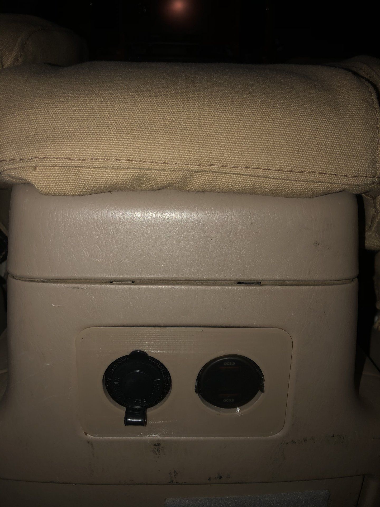

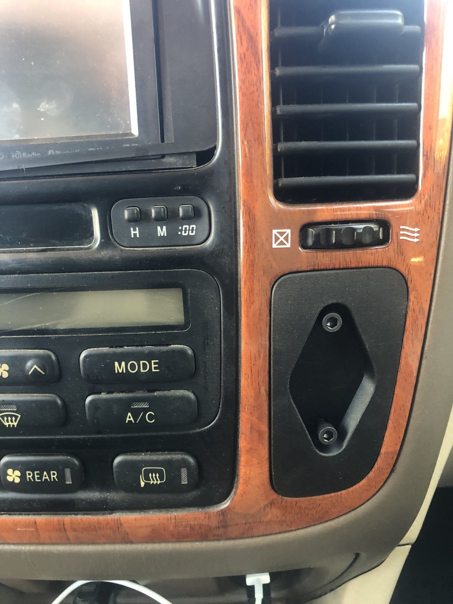

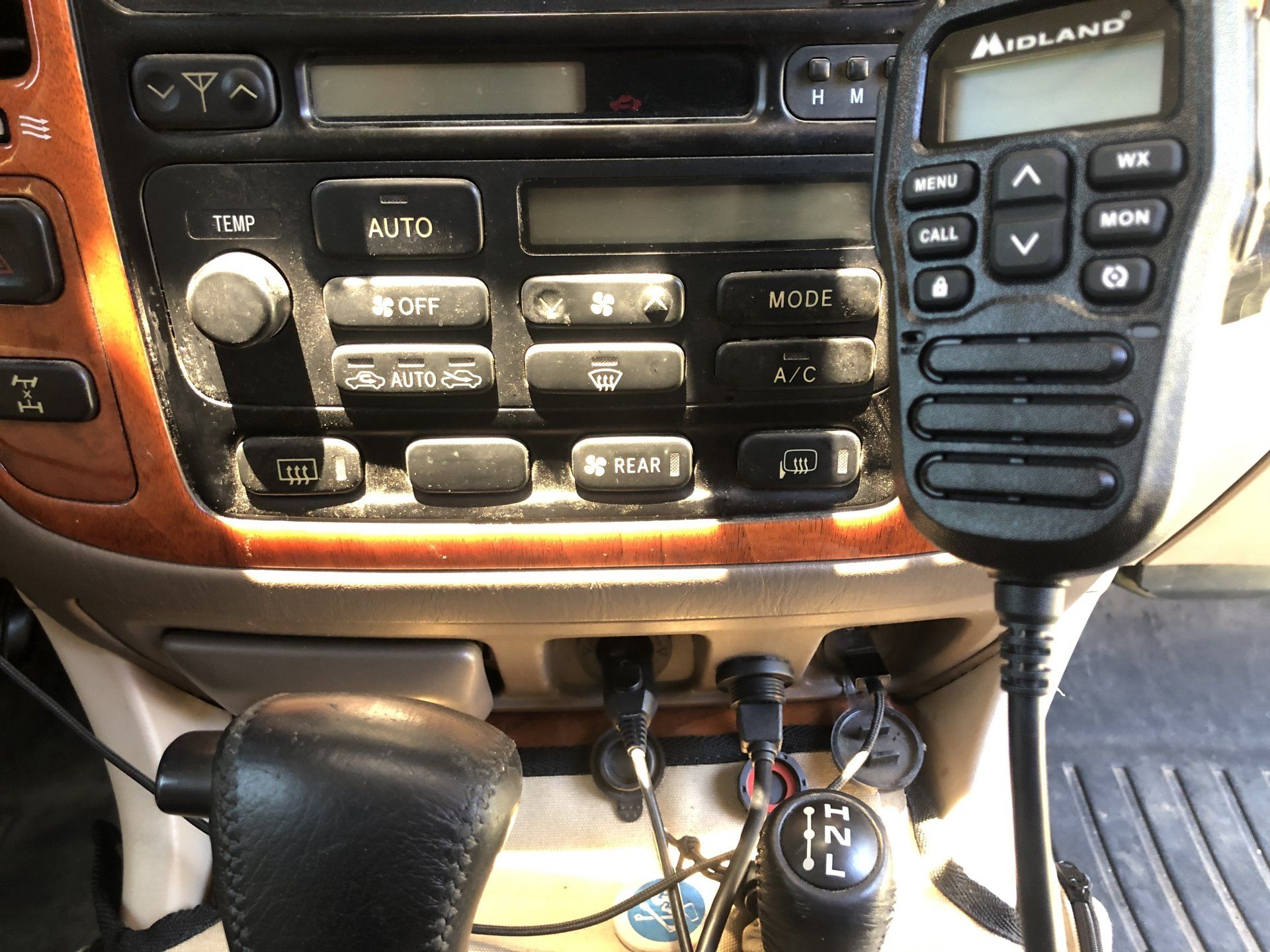

Installed my console RAM ball M2V2 mount from @BenCC a few weeks ago. VERY sturdy mount. Handled holding an iPad Mini over nearly 300 miles of corrugated gravel without so much as budging. Using the mount, I now have my MXT275 mic attached. I mounted the main body in the rear cabin. I ran a CAT5 line from the base unit all the way to the dash. I drilled a 7/8” hole between the 2 12v outlets and installed an RJ45 coupler. Makes it super easy to disconnect the handset and take it with me. Super stealthy. Installed the Midland 6db gain antenna on the bullbar. Installed the center console panel from @BenCC as well. Installed a BlueSea 12v outlet and a dual 3.0 USB port. Ran 16awg line off flag connectors thru a small hole in the back of the center console storage bin. Connected them to a 6 fuse BlueSea panel which is then connected to the battery (both positive and ground) with 8awg line with a 30amp in-line fuse at the battery side. All in all VERY impressed with BenCCs stuff. Top notch! Will be getting a few more panels from him in the coming weeks. Will be adding the headliner console to hold my Scangauge and another RJ45 coupler for the HAM mic as soon as he releases them and the cupholder tray replacement on the back of the center console.

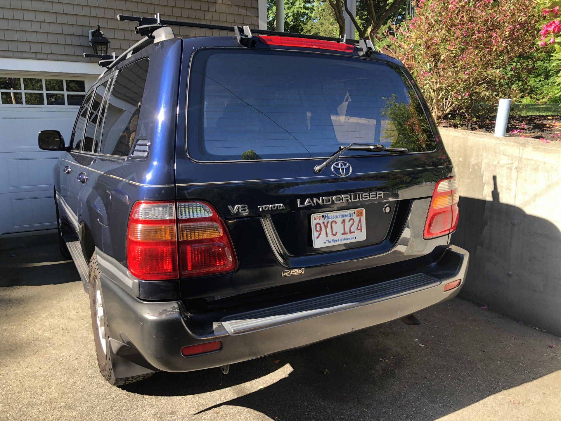

Ooh, that's clean. Big blingy wheels aren't what I'd want for mine, either, but that looks sharp for a town-version LX. Welcome and enjoy! I'm jealous of the 190k miles that aren't on yours vs mine.
everyone at camps going to be staring, pointing and laughing when you roll up to set up, but once you have took 1 minute to set up for such a huge shade area their jaws will drop in jealousy at that amazing contraption...
it does look hilarious though 🤣
I had grip tape on some jeep sliders and hated it.
At first i was like whoa that is massive but seeing their video i'm impressed. It's UUUGGGEEE, just UUUGGGEEE!
In the time it took to create this video, the Defender broke down twice. :poop:

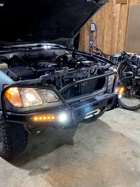

Inspired by the need of having a decent DRL visible even in the brightest days of the Nevada desert, this happened. Credits to @nukegoat as he was the first to do this but as a turn signal I believe cmiiw. Will wire this up tomorrow with a switch tapped in the ignition wire. Wiring diagram suggestions are welcomed.
@OEMGUY0720 Regarding DRL's... back 2005 or so, there was a recall on the LX470 as the DRL's were "too bright." All they did was add a resistor in the engine compartment near the diagnosis port. Not sure if your 2007 also has that resistor or if they made a different change. Anyway, if equipped, you might be able to just remove the resistor to improve DRL performance.
Cool info man I didn’t know that, thanks. I actually switched my high beam lights from halogen to LED a year ago to match those with the HiD 8000k low beams. Also the same moment I lost the factory-feature drls on the high beam because its led now, but that’s okay not really a fan of it anyway.
