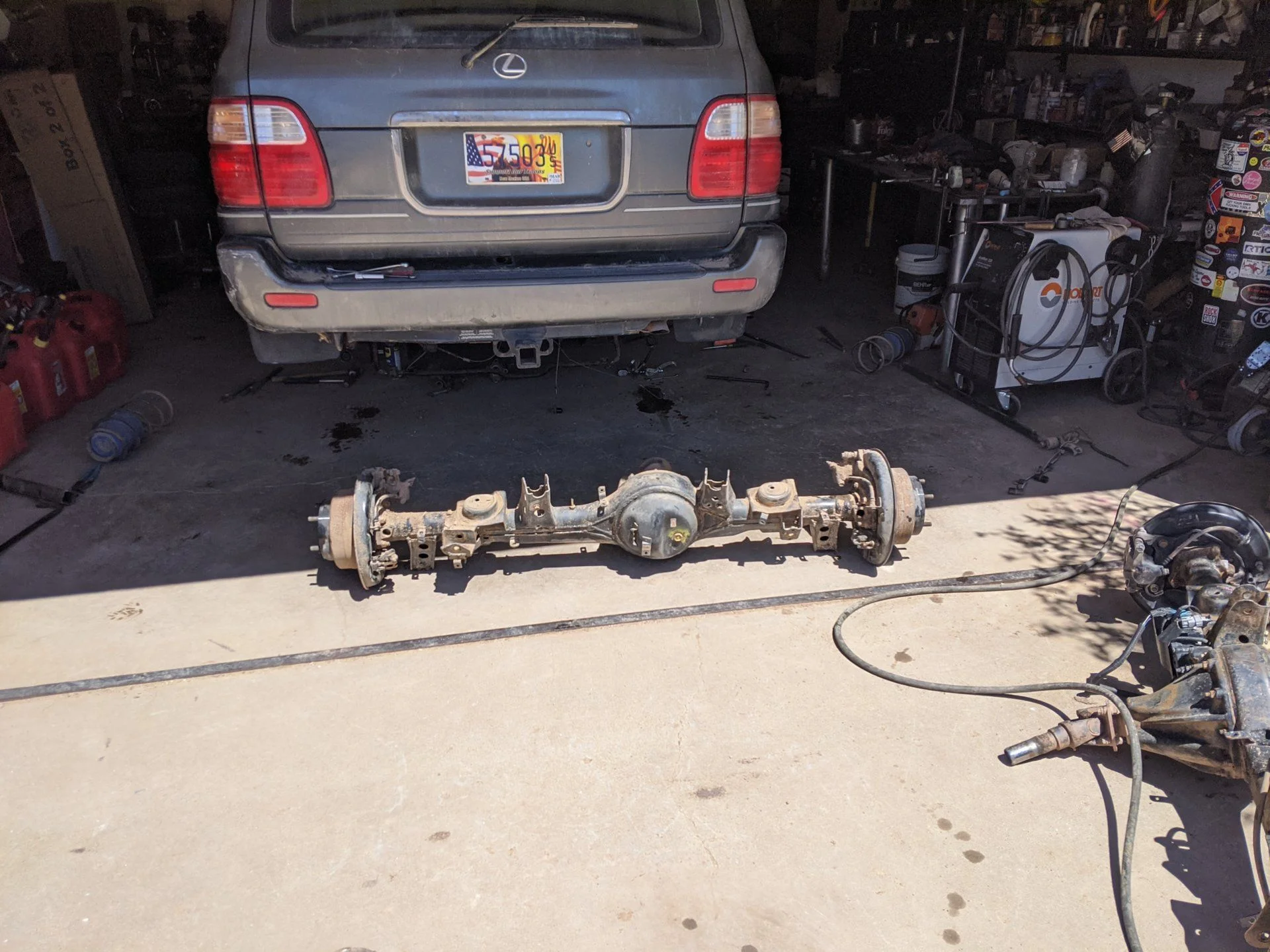

Finally pulled the old rear end out and put the junkyard locking rear in that has been sitting around for months. Waiting on the wiring so I can get it hooked up right.

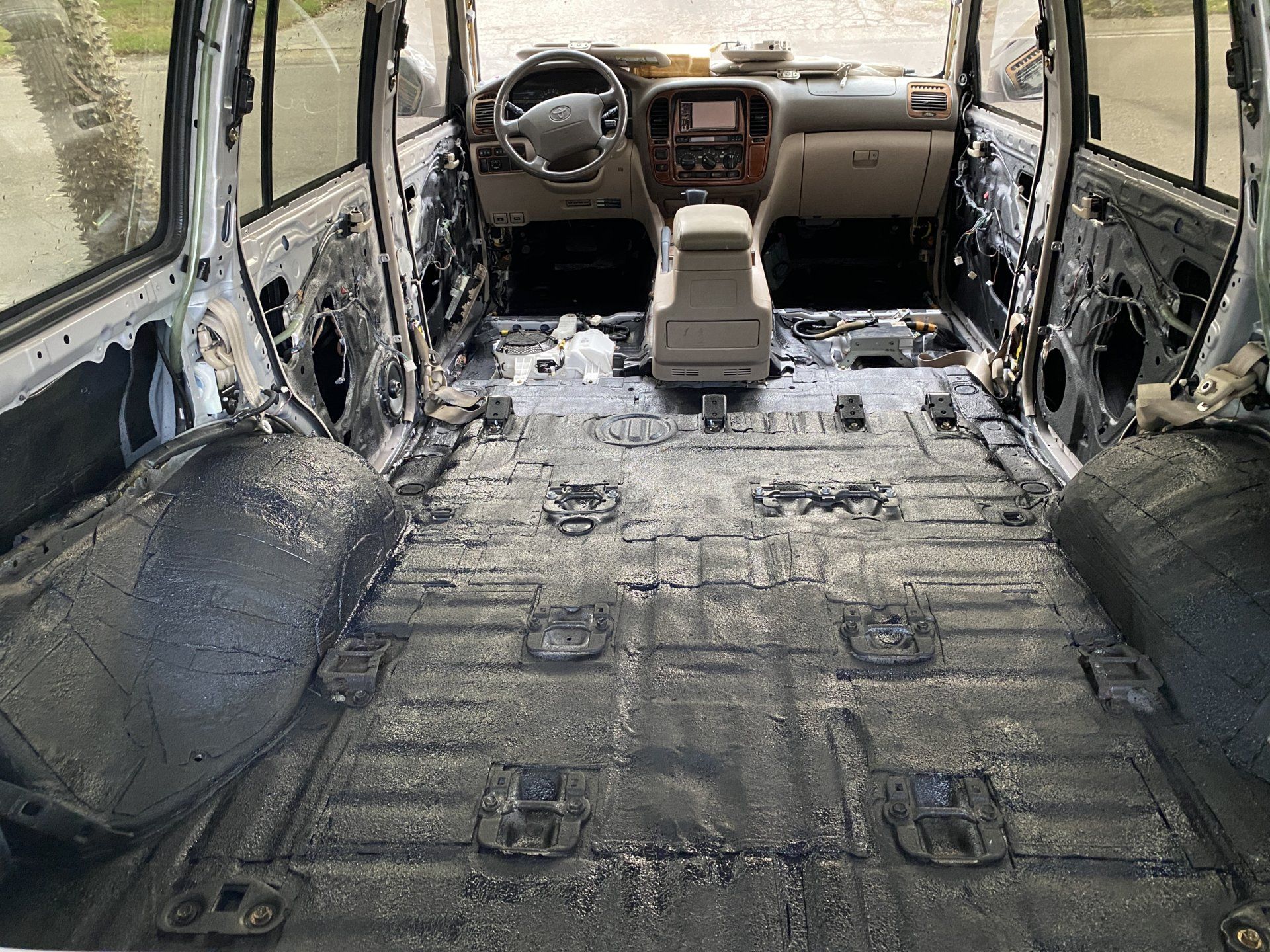

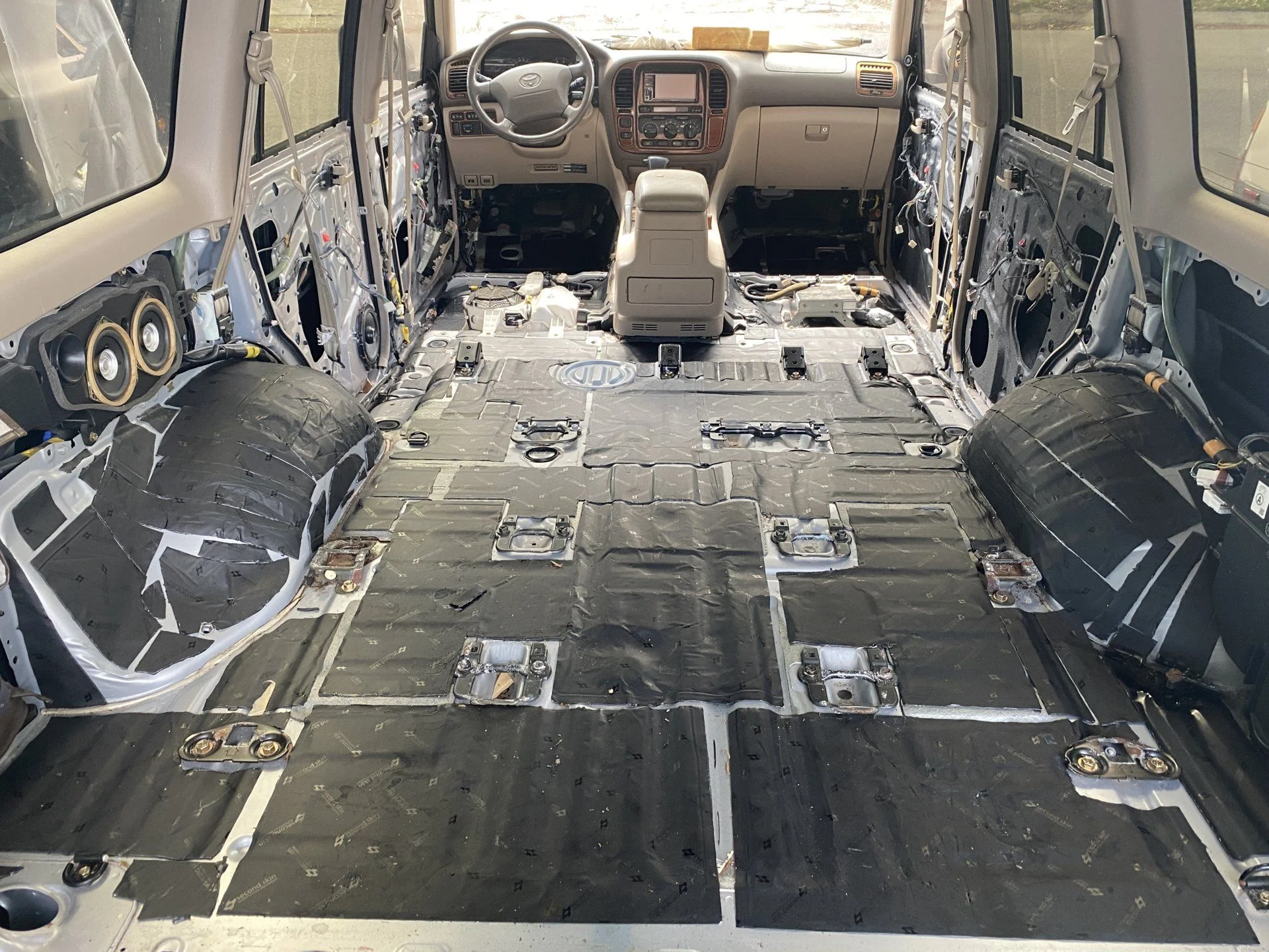

Completed part 2 of sound deadening for a customers 100 series. 1st layer was damplifier pro by SecondSkin, 2nd part is Second Skin Spectrum. 3rd part goes in this coming week. It’s a time consuming process and a labor of love. The results are absolutely incredible. It’s like driving in a casket while the tornado sling aluminum cans at the cruiser. You hear nothing. Sorry, best analogy I’ve got.

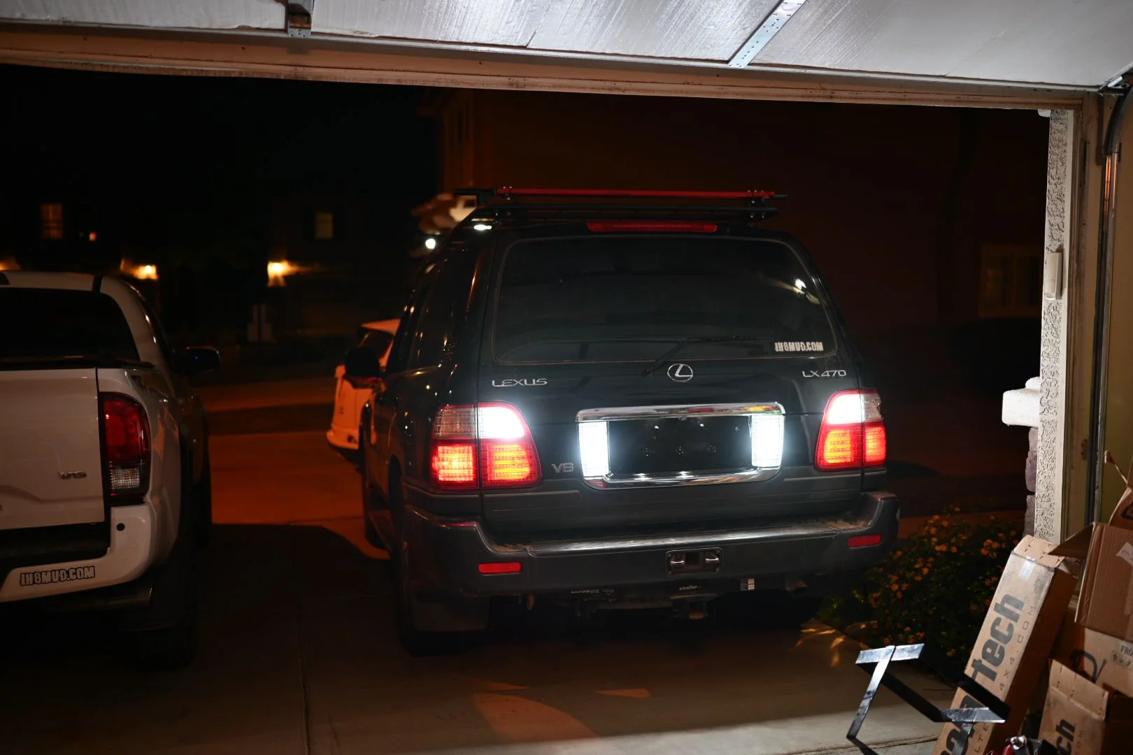

Drove it!
1st time in 86 days. New OEM CVs, 555 ball joints, new Nitro gears, ARB front locker and OBA single compressor, Torfab mount-(still have AHC), @cruiseroutfit supplied all but Torfab mount; built locker for me. Ran out of brain power, so doing the wiring and switches for the compressor another day. Driveline clunk is gone, too. Had an audience to see it driving out.

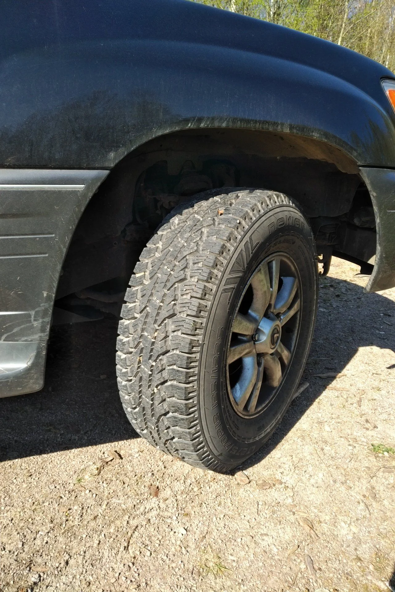

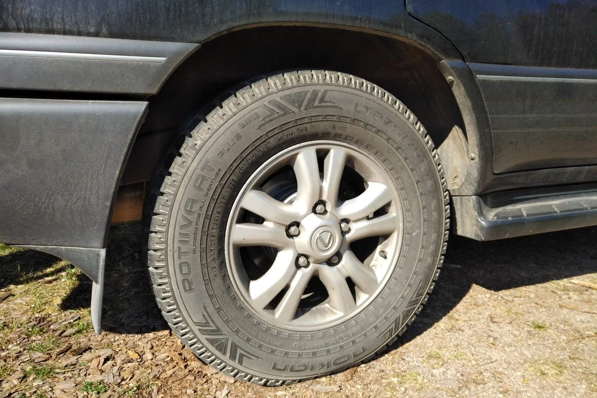

I steped up to 33's (275-70-R18) from Nokian. The Rotiiva AT Plus is very quiet on the road (hardly noticable), has really good behaviour on wet pavement and I like the style of them, while beeing all-season-tires for winter use on german regulations.
As I drive 90% on road I wanted a mild AT and am pretty happy with the result.
Only negative point I have to ad: as probably all E-rated tires, they send small shocks right into the cabin... The super smooth ride of the AHC is somehow affected by that bumpyness.

Damplifier Pro by SecondSkin is who makes the pads. By themselves it’s a drastic improvement. I’d do the bottom and all doors and panels. The 3 step process would add some weight. for an 09 200 series it added approximately 115 pounds total spread over the vehicle. Not noticeable as far as weight. The sound difference is amazing.

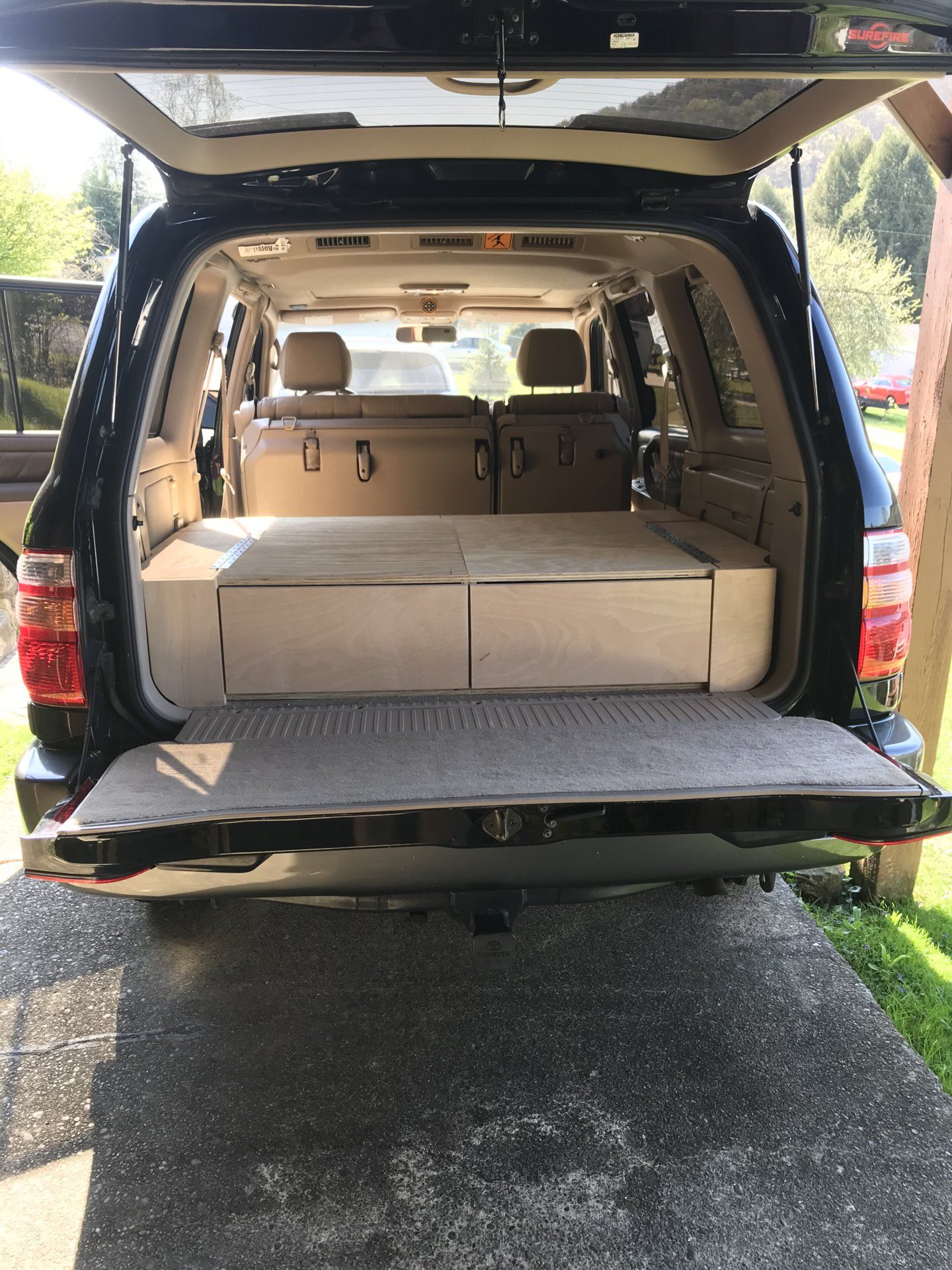

I made a bone-headed mistake!

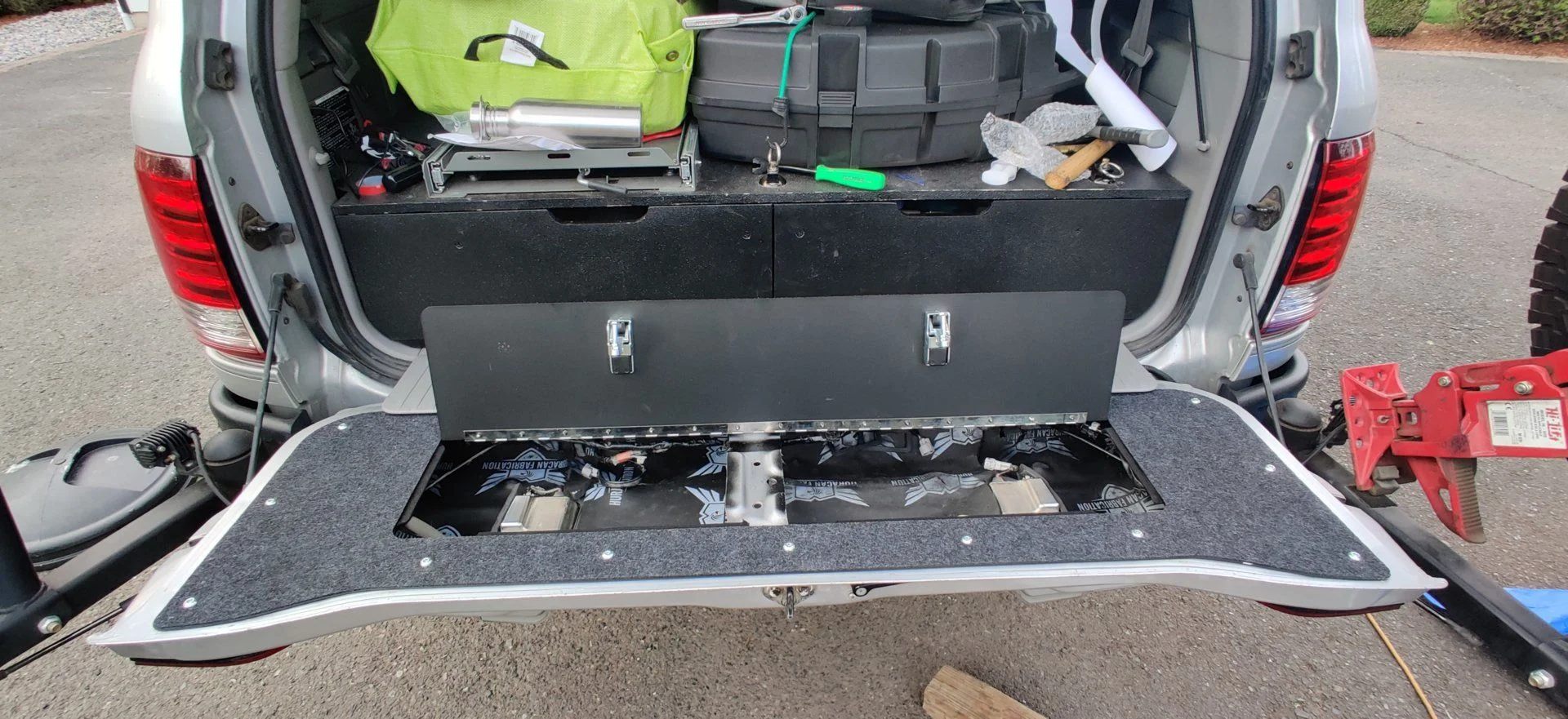

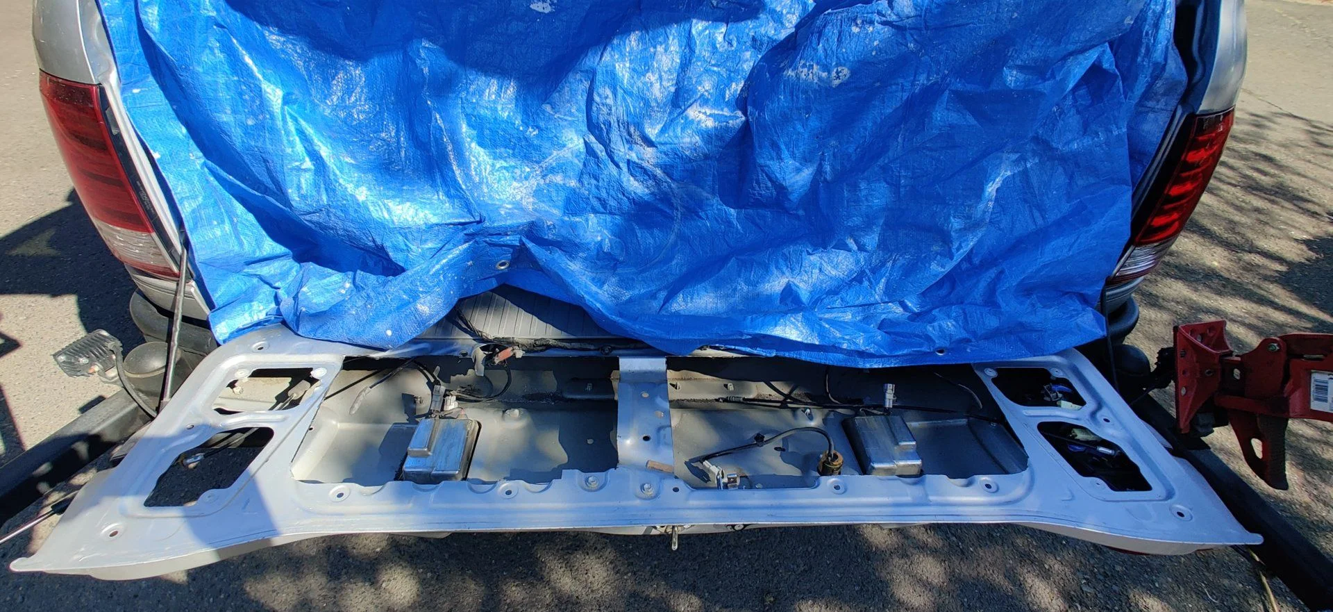

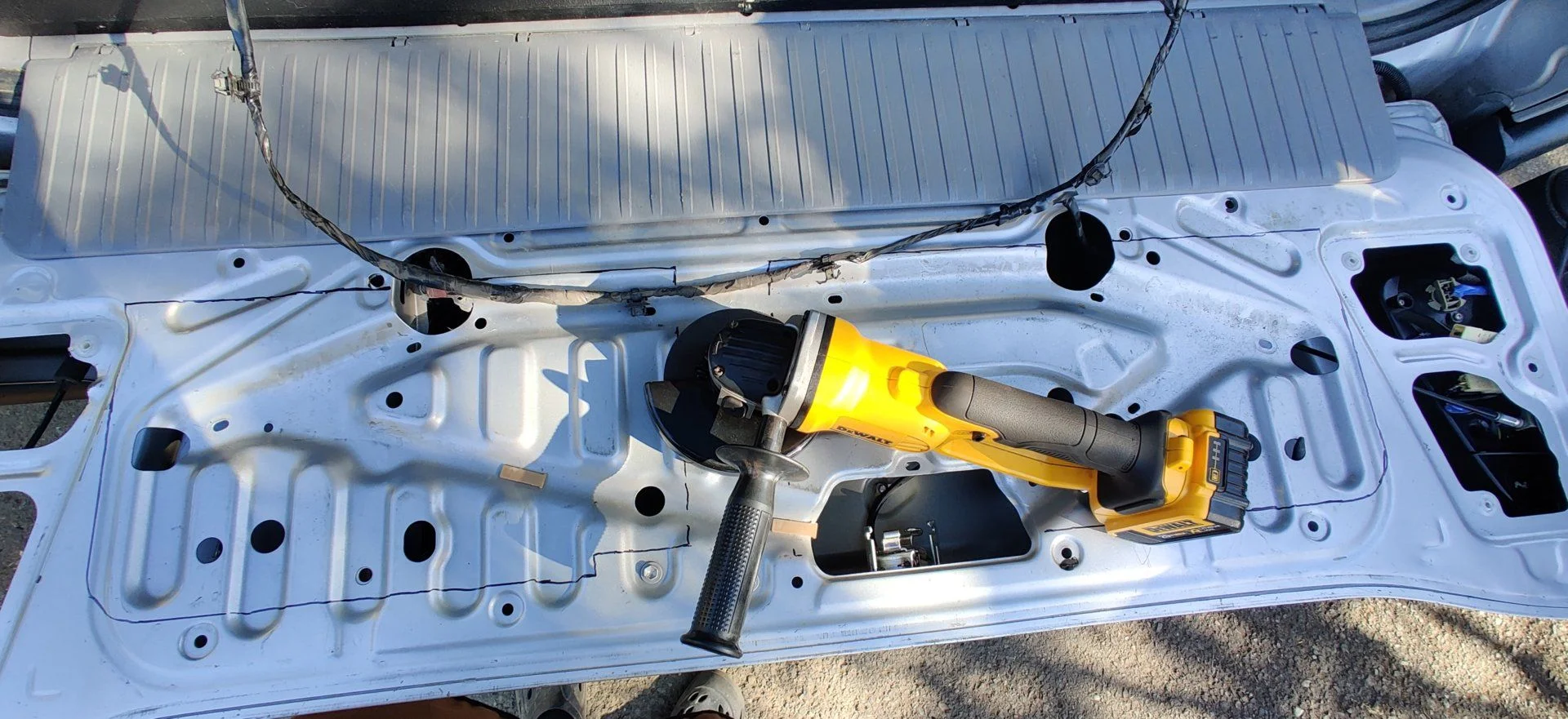

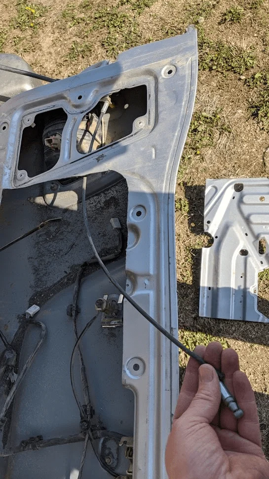

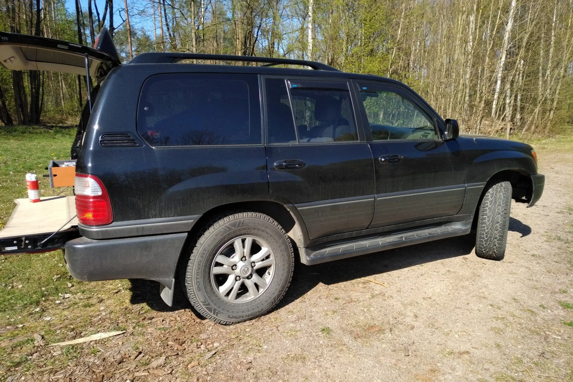

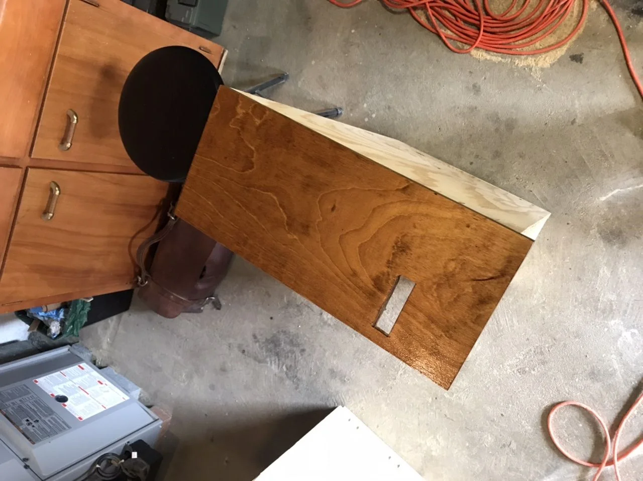

Safety Tip - When cutting the the tailgate for a storage lid, don't double check that all of the cables are out of the way...TRIPLE CHECK! I cut right through the tailgate latch cable on the passenger side when it was tucked under the sheet metal. That slowed down my Huracan lid install.
I am attempting to quickly source a replacement locally... don't really want to spend $100 on a 24" cable from Mr. T.

Interested to see the third stage, considering doing a similar treatment to mine.
