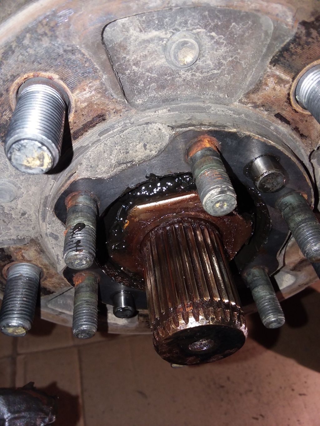

bad news. CVs shot. :frown:

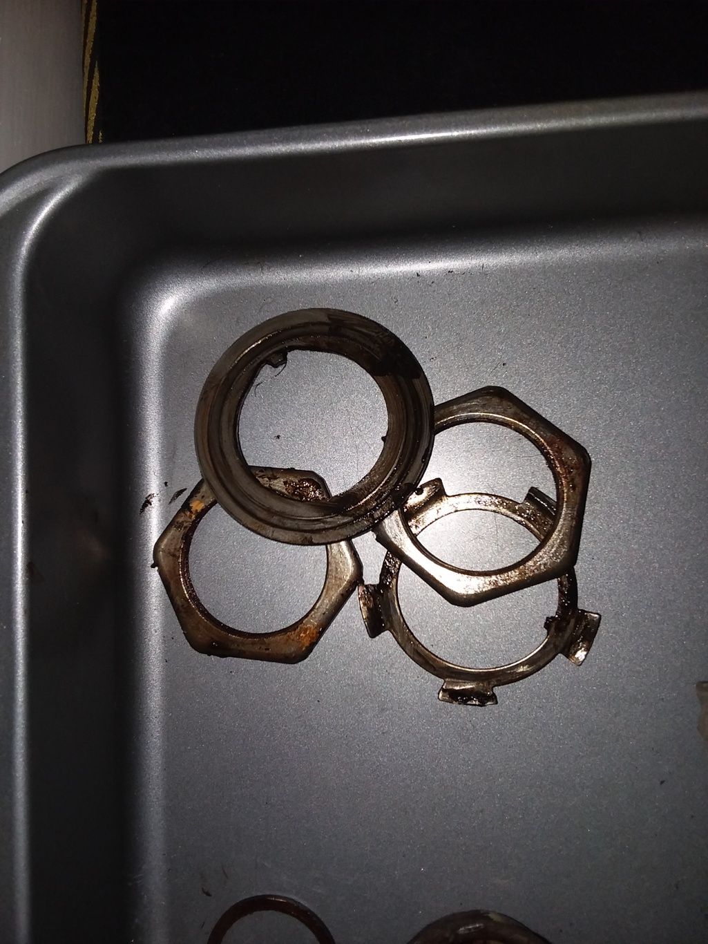

PO mechanic surely ruined them by improper service when replacing rotors. i unscrewed the bearing lock nuts by hand!
thinking about whole new shafts vs outboards only. 295k miles on these possibly. over $900 for 2 complete CVs from dealer. less than half that for outer shafts. any reason besides convenience to get compete shafts? will i be served better by getting a new inter joint and new splines.

View attachment 2262067View attachment 2262069View attachment 2262070View attachment 2262071View attachment 2262072
What was the issue before pulling everything apart?

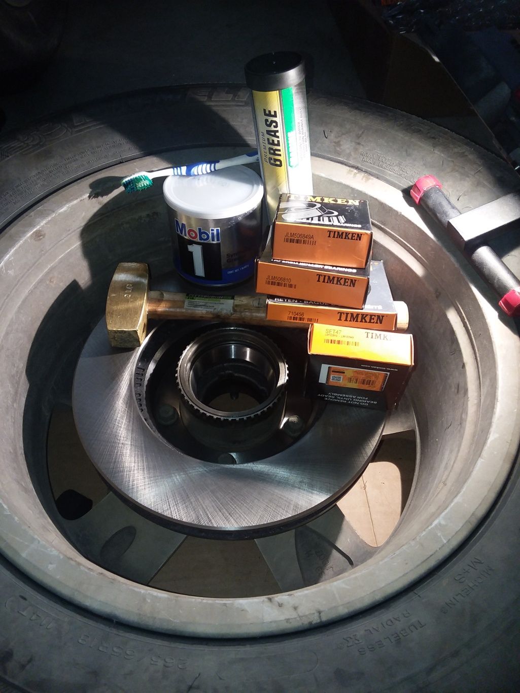

i was replacing brakes and rotors and intending to do a bearing service. it also has the infamous driveline clunk. here is a video from a couple days ago before i tore it apart...

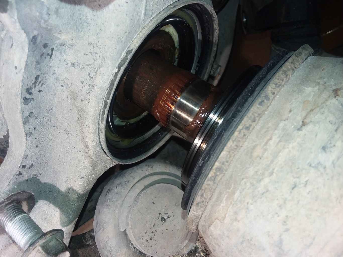

what did it take to pull that thing?
I followed the instruction sheet that I downloaded from this site. The trick for me was to remove the high-pressure line and to have the engine lifted up so the rack would clear the oil filter housing on the way out.

So what's actually bad? Your pics don't show anything too obvious (at least to me...) other than dirty grease and maybe worn drive flange splines? Why do you say the CVs are bad? The axle splines are harder than the drive flange, so they shouldn't wear out as quickly, and the seal surface looks OK to me. The spindle nuts coming off by hand is fairly common and not necessarily an indicator of destruction, especially with lots of miles on a set of bearings. How long since your last bearing service?
Your video also makes it look (to me) like you've got worn drive flange splines. And maybe it's time to replace the diff mount bushings since they look a bit mushy.
thanks for taking a look. i do have new diff bushings on the way. i have new drive flanges to put on but the axle splines are too far gone. the tops of the splines where they engage the drive flange are sharp. they should look like the end of the shaft after the snap ring with flats on top. here its a picture of a new axle i found posted by 2001LC

sorry for the dirty picture. it wasn't worth cleaning when i saw how bad it was.
the axle nuts were driven on by a chisel and all the lock washer tabs were bent the same way. the nuts were literally free spinning in the hub. I realize now that i had detected the slightest shimmy at high speed in the steering wheel. i wonder if this is the cause.
View attachment 2262514and mine again for comparisonView attachment 2262515
BTW ordered new compete axles. will retain these and later replace outer shafts to have as spares.
Definitely smooth and worn across those top edges. Mine had 247k miles and still had the tiny ridges on them, but had worn out the actual joints. I went all new, too.
