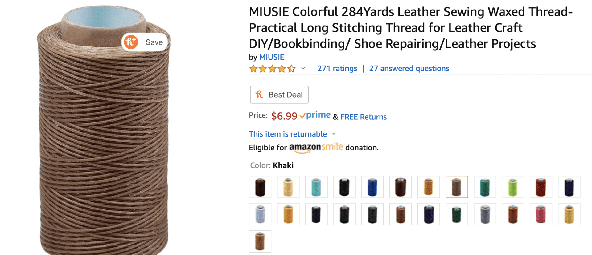

Start with a length of thread (waxed leather stitching material) 3-4 times the length of the repair.

What did you use for “thread” this time?

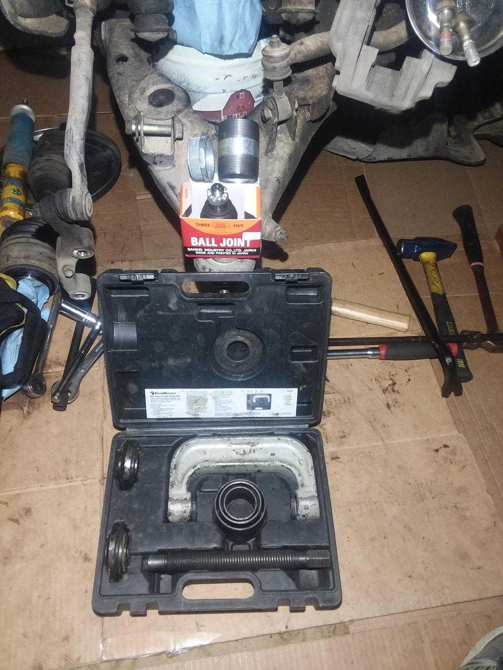

new OEM CVs axles ,flanges, 555 LBJs, timken bearings, brakes and rotors and basically everything related.
i had a stoke of genius using these caliper hangers to hold the CV while inserting it and prepping knuckle.

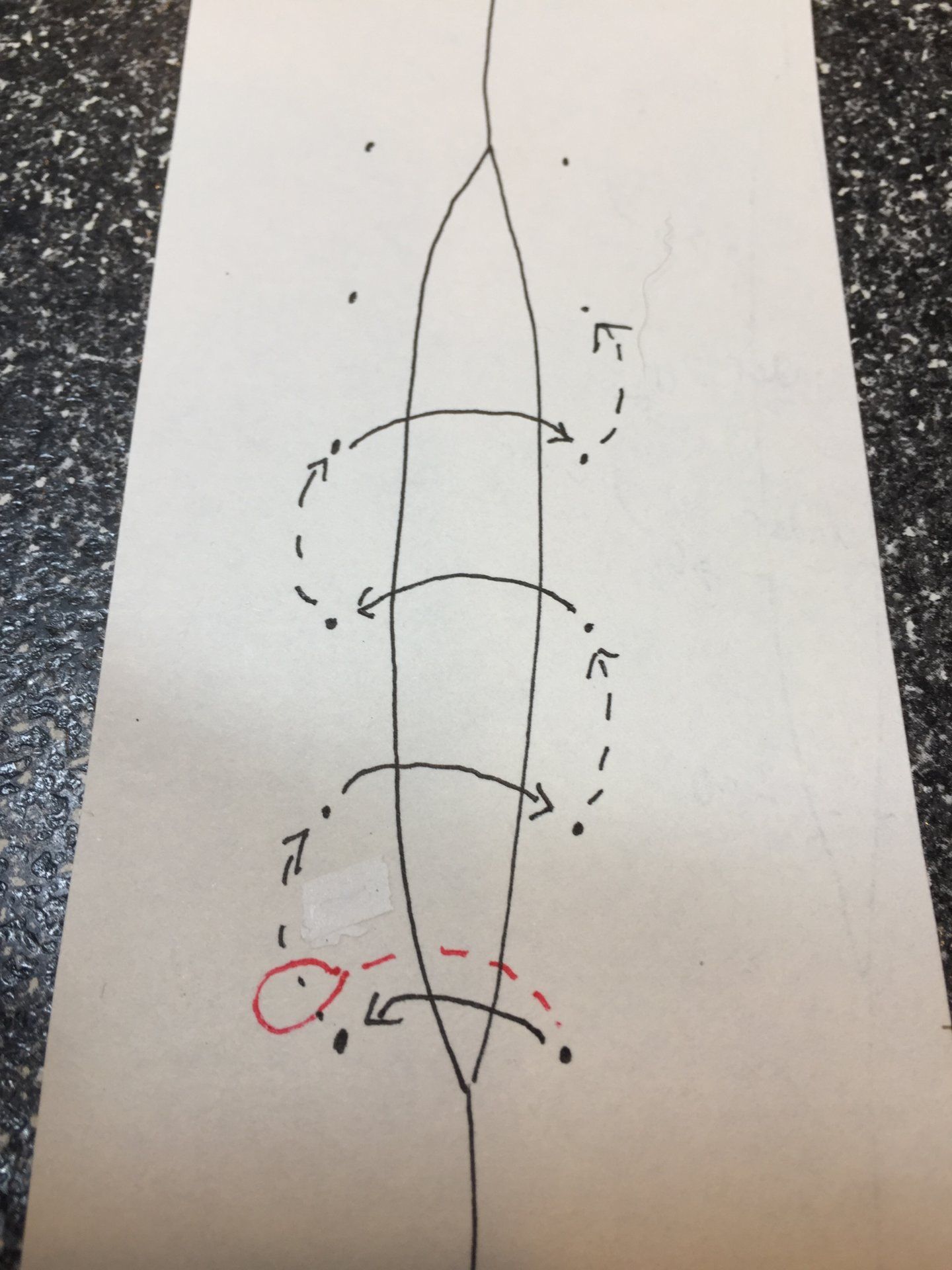

What stitching method do they use from factory? I've got a section of mine thats pulling apart that I need to repair. What method did you use?
Not sure how much this helps but here is a diagram of the stitching pattern I used. I don't know how this "should" be done, this is simply the way I did it.
I'm sure the factory uses a machine with a pattern that would be nearly impossible for me to duplicate by hand.
Solid line is over stitch, dotted line is under.
The red represents the starting thread and how I tied it to the under stitch to secure it. As opposed to knoting the end like you're sewing a shirt.
Nice! that helps a lot actually, thanks for that.

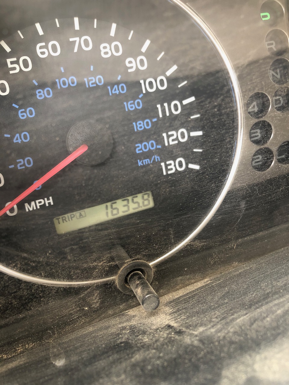

Back in San Diego after 1635 miles
