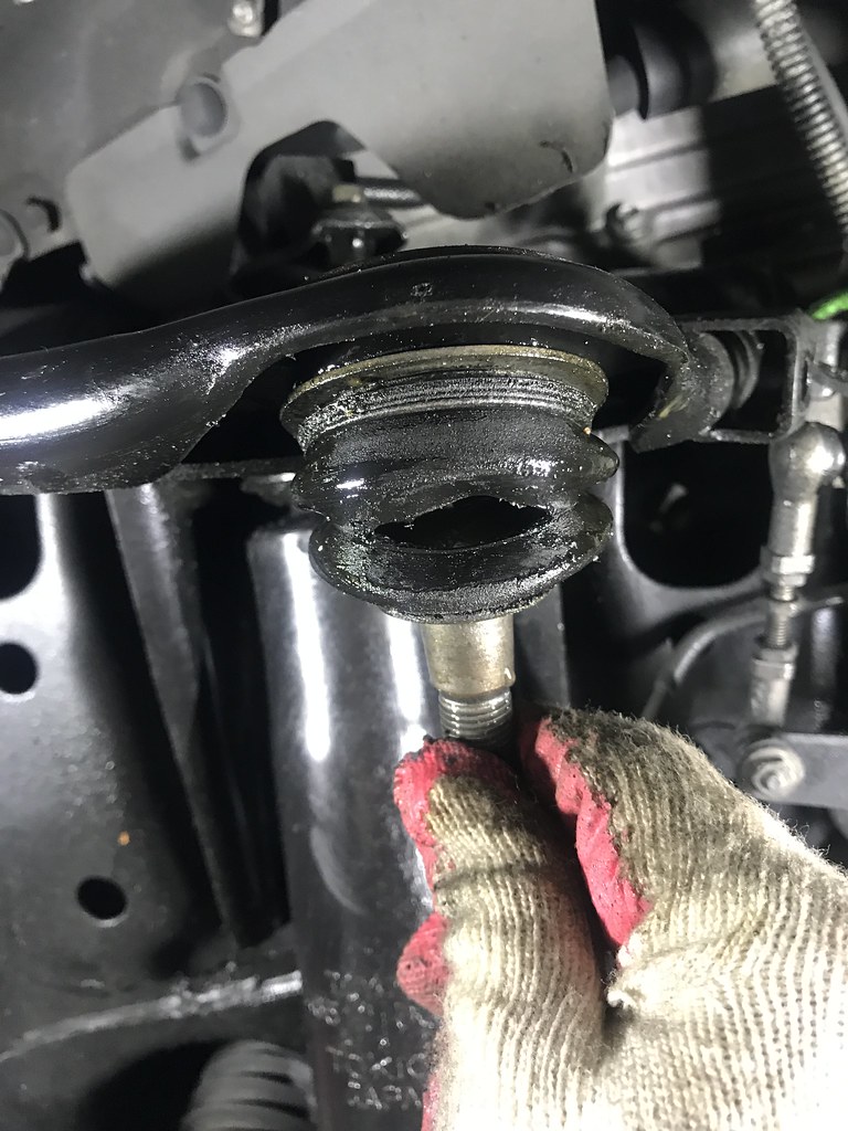

Started working on the front end suspension refresh today, replaced all 4 ball joints with Triple 555 i got from Kurt at @cruiseroutfitters . Very easy to do once you remove the knuckle, goodness gracious that thing gotta weight at least 100 lbs, i think i herniated a disc lifting it up to attach to the ball joints. it's a pleasure to wrench on this truck where no bolts is rusted or broken, didn't even have to use my big 1400ft lbs impact gun to break anything, the milwaukee 600ft lbs impact did everything with ease.
new one is in
Top one was the culprit, making that eehh ehhh ehhh noise when turning and during rebound/compression
I didn't have a cup long enough with the correct size to press the top one out so i ended up cutting the joint and use what i had to press it out. Pressing it back in was a piece of cake
Truck drives like new now, everything is nice and tight and quiet. I was going to replace the TREs but they were nice and tight and had no play. Sway bar links bushing looks good too, one thing that could use replacing were the 2 C clips holding the axle, they have a big more gap and move more freely than i'd like, probably will replace that before it pops out.
I've got this exact noise going on right now. I guess I know where to look. Thanks!

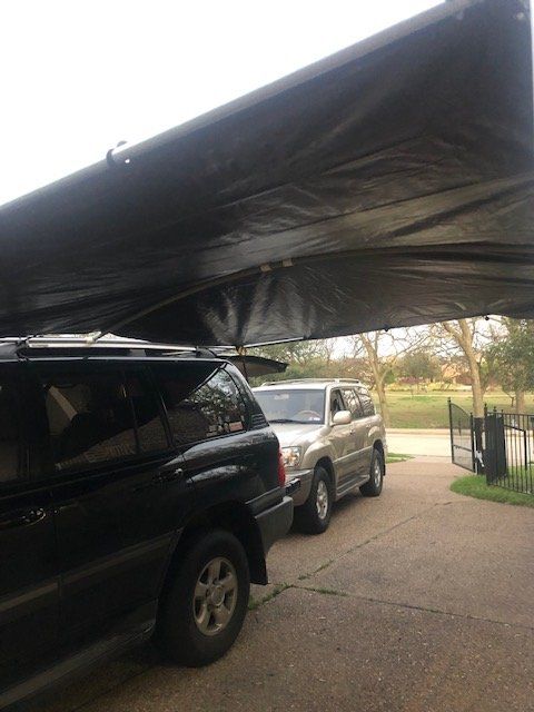

and @ClassyJalopy heres how I mounted the awning. The L-Bracket is secured to the outside bar of the roof and then I sandwiched it with two sets straight brackets. Used lock washers and loctite on everything. Kinda janky looking but cant see any of it.

Love the mounts and love that giant palace of a tent you got going there!

Got it off Facebook market place for a song, no regrets. It has a closet on the back side, a divider partition for the middle. Holds heat with Buddy Heater like nobodies business. Sometimes I'm jealous of the roof top tent guys but then I remember I spent $75 dollars and I can stand up and walk around in mine even with a queen air mattress, two singles and a pack n play. The set up time really isnt awful either.
