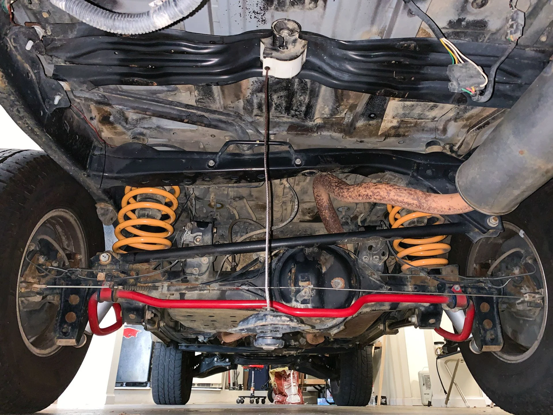

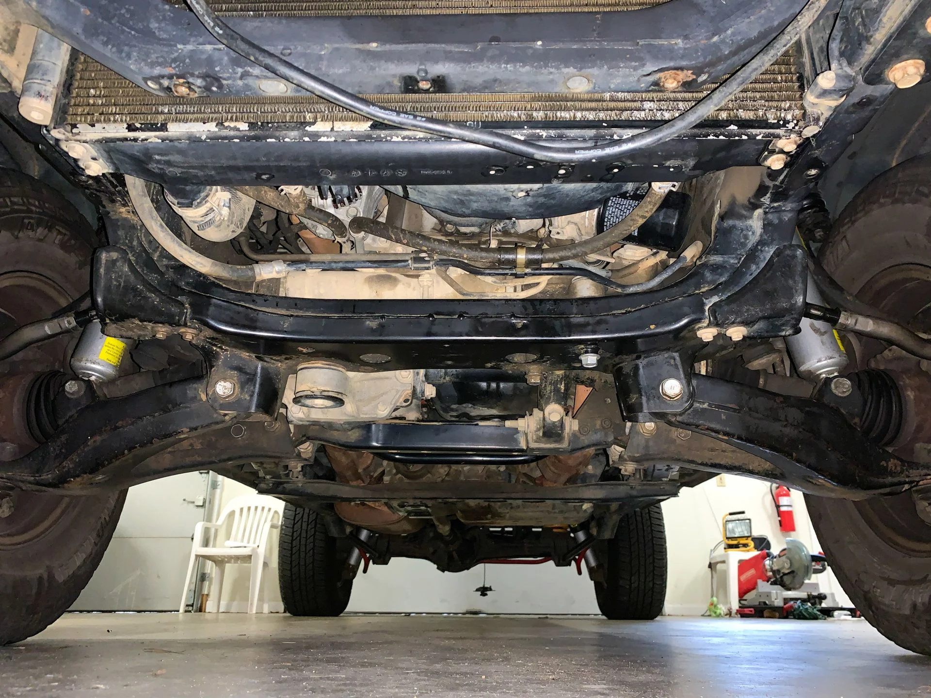

Took advantage of the 4th warmest Christmas in Arkansas history by deep cleaning the undercarriage
Even 16.5MPG would be great! Who's Gerry?!
Gerry is the name of the truck. Pronounced Jerry, though.

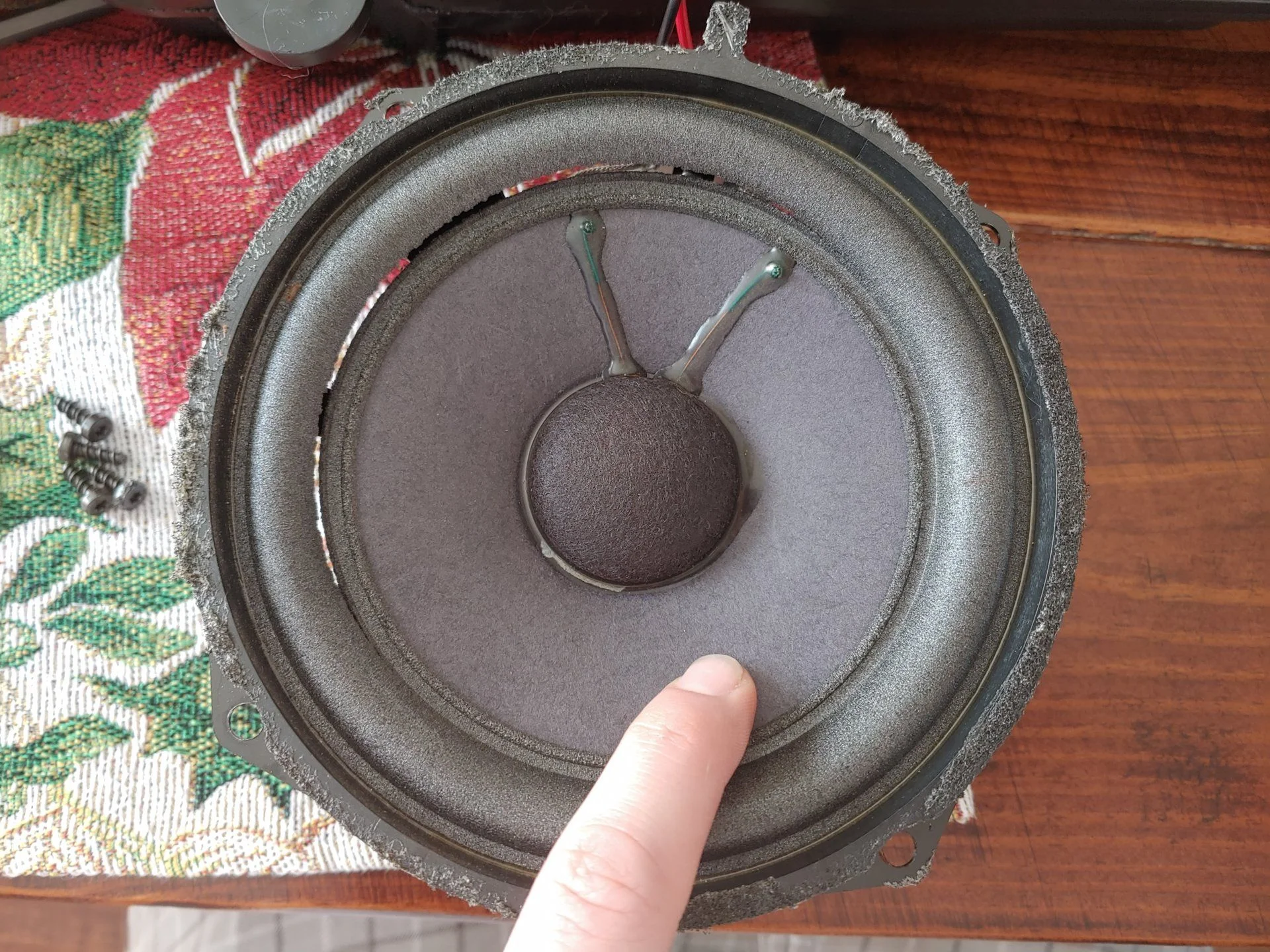

Today I used the simply speakers kit to re foam my factory sub. Easy enough. Took about twenty minutes to get it out of the truck and about thirty minutes to do the thing. I'd say it was pretty due.

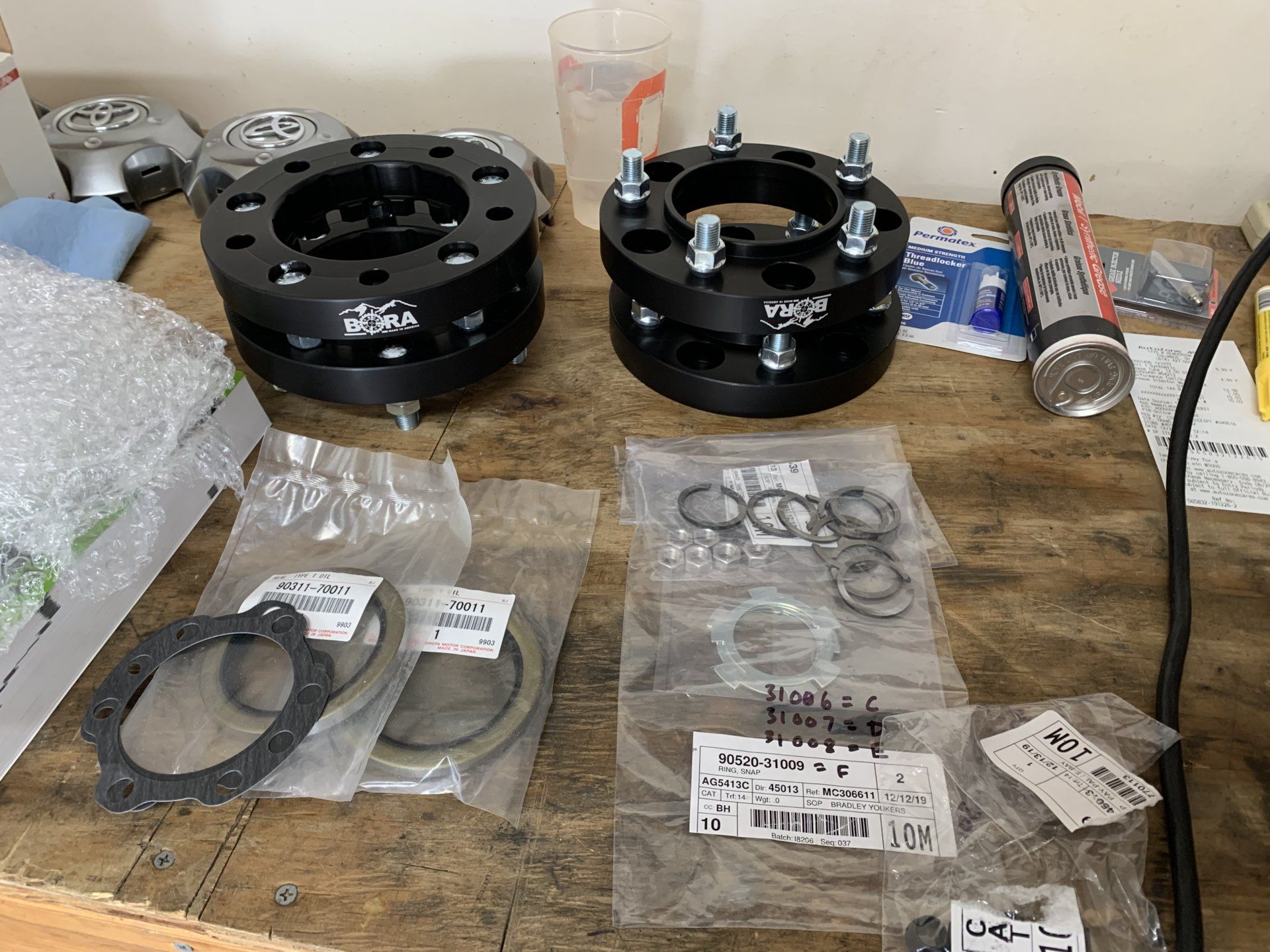

Lower ball joint started to tell me it was time to tear into the passenger side by making a terrible high pitch screeching sound when turning or bumps. So replaced that with a 555 along with repacking wheel bearings, new CV axle shaft and seal (no more clicky clicky when turning). I have SPC upper control arms and performed the same work on the D side a month ago. Finished it off with new gear oil. I also cleaned the PS reservoir and added new synthetic ATF. What a smooth quiet drive it is now!

I’m getting ready to install some 1” Bora spacers myself. Any trimming of the lugs necessary?
No, the OEM studs do extend beyond the spacer by a hair, but the mounting surface of the OEM wheels have a small valley that the studs line up with so trimming wasn't necessary. It may be hard to visualize, but you'll see what I mean when you're installing.
I appreciate the insight!
Sure brings the vehicle to a more natural looking stance!
