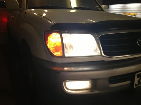

Replaced 14 year old headlight assembly. Old glass was still in good shape but inner reflectors were severely oxidized. New light output is amazing!
Old
New
Old
New
That difference is actually stunning! Very impressed with the results! My inner reflectors were getting pretty crappy too so I just pulled the trigger on an HID retrofit and I'm fairly pleased with the results as well. Just needs some fine tuning that I've been too lazy to do.
Just put some 2013 wheels on my 1999 I think it look great pics to follow.
That does look great! Did you just repair the reflectors and inside of the housing, or did you replace the entire assembly? What source did you use if you don't mind me asking?
Thanks!
I replaced the entire assembly. Purchased them from Toyota of Dallas with a TLCA discount. I also adjusted the lights up about an inch (marked wall, from 10' away) which helped the light pattern too. So far no one has flashed me.

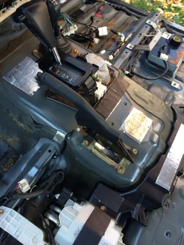

Finishing painting the wheels, got the sliders on, and started the sound deadening install.
