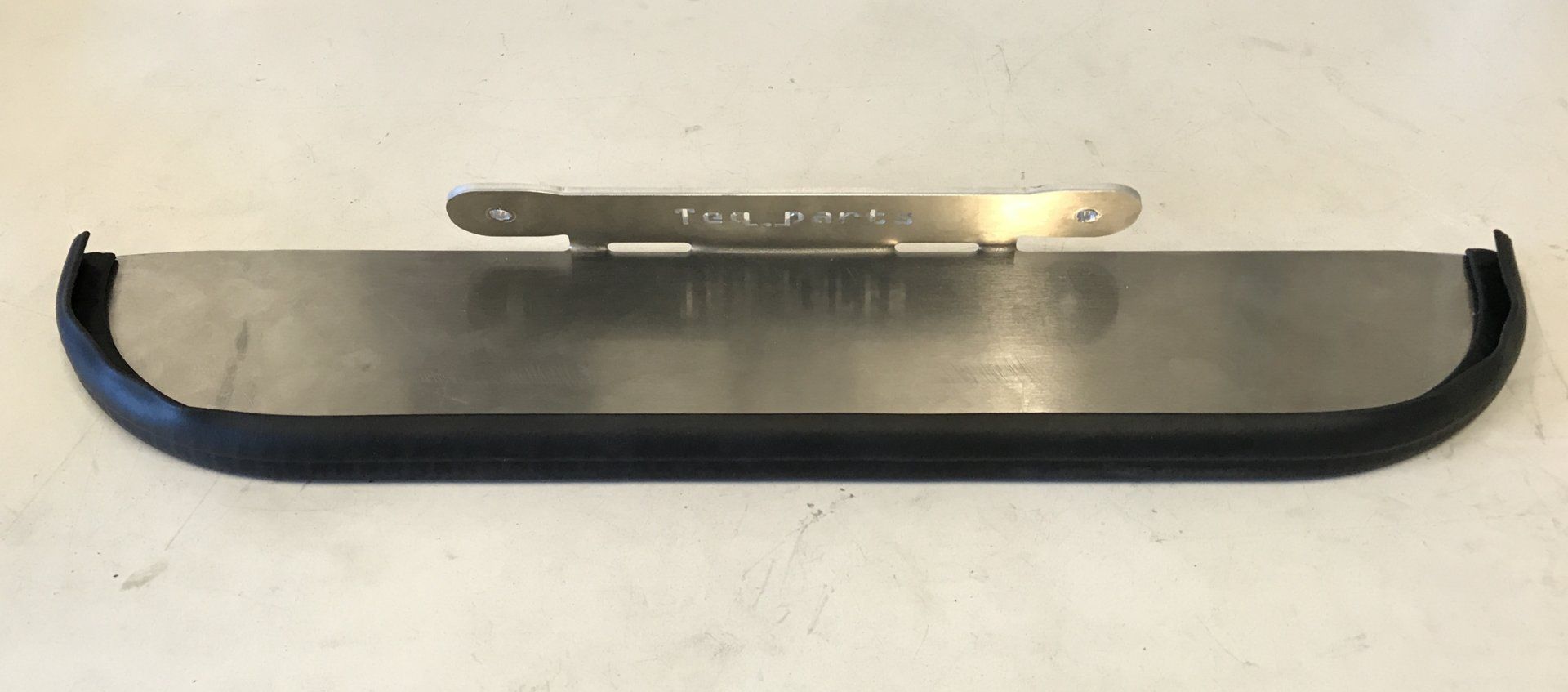

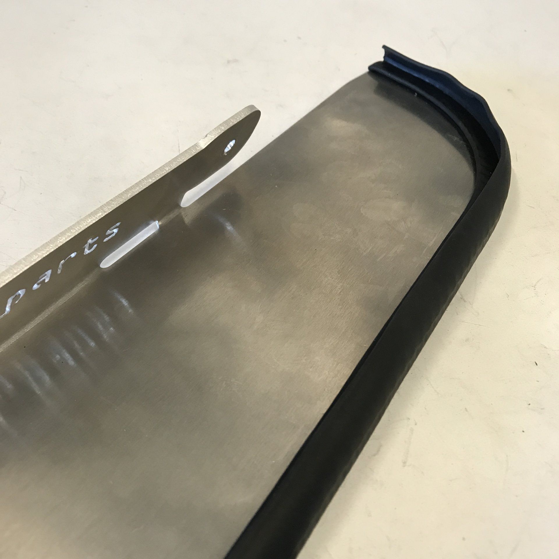

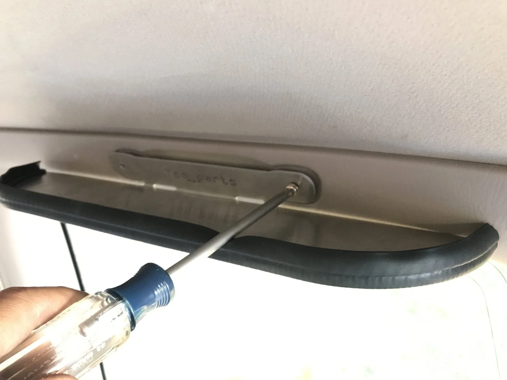

Also fab’d up a rear shelf for stowing small items while sleeping in the back. Yea the side compartments are there, but I found myself wanting an “end table” sort of place to stash my glasses and other knick knacks. Strong 1/8” aluminum with a soft rubber lip. I may offer these for sale, any interest?
View attachment 2017598View attachment 2017599View attachment 2017601 View attachment 2017597
I would be interested in something like that. What are the dimensions?
