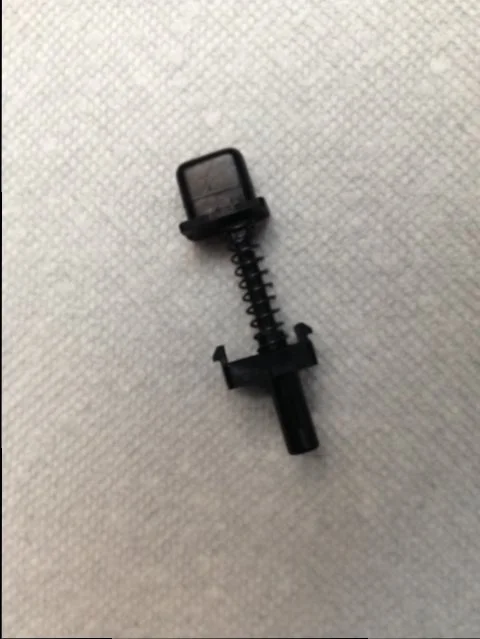

The button itself is discontinued. The other parts are available (guide, spring, sticker)
Plug and play! Just pull off the PNDR plate, pull out a small white plastic part, and put the button assembly in it's place.
Here is the part that's removed:
Here's the button in place:
Works like a charm as long as you can find the button!
Has anyone else bought these parts and installed this button into a land cruiser post 1993?
yes, I have installed them in our 80 ('93) and in our LX450 ('97) - they work as described - there's even a label that fits to the preformed site right between the button and the shifter
