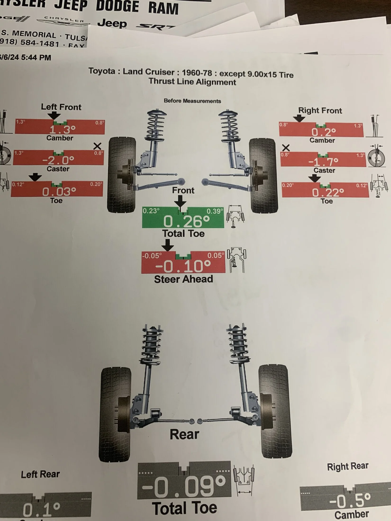

Checked the alignment yesterday. I need to install my caster shims still. Looks like I need to get the centering tool for the knuckles and do that as well. But at least it won’t kill the tires in the driving I’m doing.
Those numbers pretty good for your tractor. Tie in is the only thing that’s adjustable… I’ve heard of offset bearings for the knuckles, but never seen them. They were built before the days of fancy computer alignment made.
I’ve only used the pushpin method for alignment for the last three sets of tires.
Your negative caster #'s indicate your steering maybe over responsive, darty, and like your chasing it when making minor corrections.
Good catch... I'd not looked at the +/- and was thinking 1.7*, 2* looked good... but it's the wrong way. Stock is 1* so 4* seems good with arm-strong steering. With P/S id suggest 6* instead.

Honestly they shouldn’t need to load the factory specs. Just get a reading and set the toe in that’s all that’s adjustable other than using caster shims.

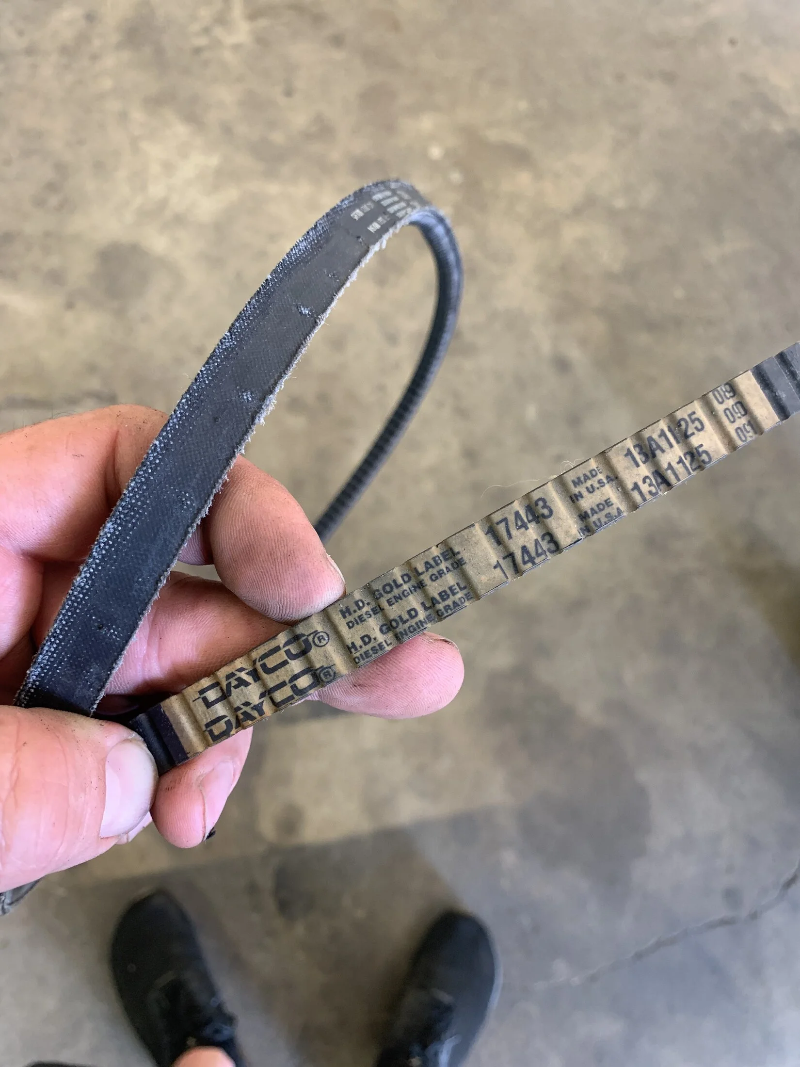

Also I guess I need to get a shorter power steering belt as mine slips off and on.
Bought two belts for the power steering, installed one as it was actually shorter than the one I had on it. It was the wrong thickness, ended up putting the one that has been on the 40 for at least 20 years back on it and it fits perfect. Not sure why it’s so hard to cross reference the number and get a gates belt locally.

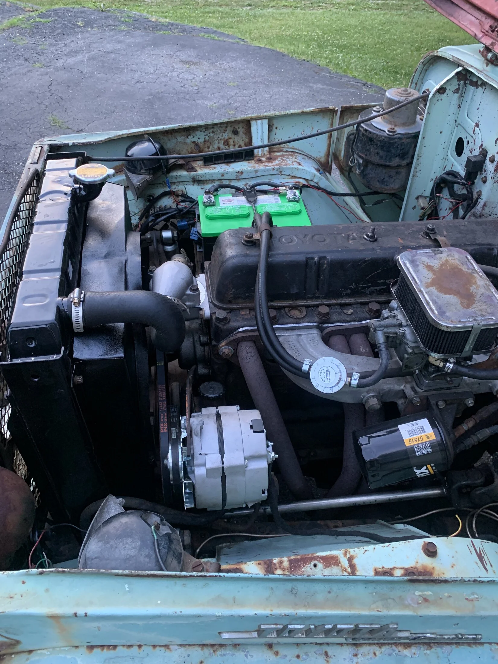

Over the last couple days I removed the radiator and pulled the power steering pulley off so
I could address my belt squeak / coming loose constantly.
I found the front lower mounting bolt for the power steering pump was non existent and had been for quite some time. I Installed a new bolt, with lock washer and tightened up. Reinstalled pulley and now everything lines up 100% better and feels rock solid.
I would say this bracket was built in the 80s and oddly enough it’s pretty damn good. I would like to find a better option eventually. Although it worked for 20 years before it was parked so why mess with it.
I rattle canned the fan shroud while it was out and adjusted the radiator support to let the radiator drain have more room and the radiator to align better. Little things.
