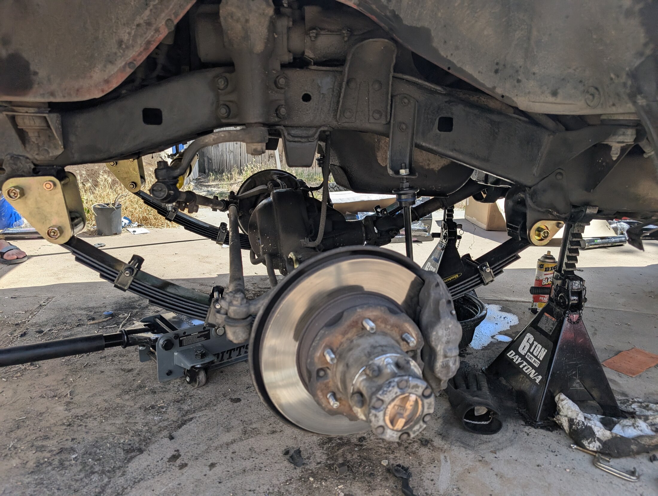

Sitting on the floor with @nab856 in a circle deliberating on how to coax the bushings to pop the bolts out.
Did the Dobinson's come with shackles? Sawsall if they did. I don't know about the 60, but on the mini-trucks the rear frame mount has a metal sleeve inside the bushing. It rusts to the bolt and the only way to get the bolt off is destruction.

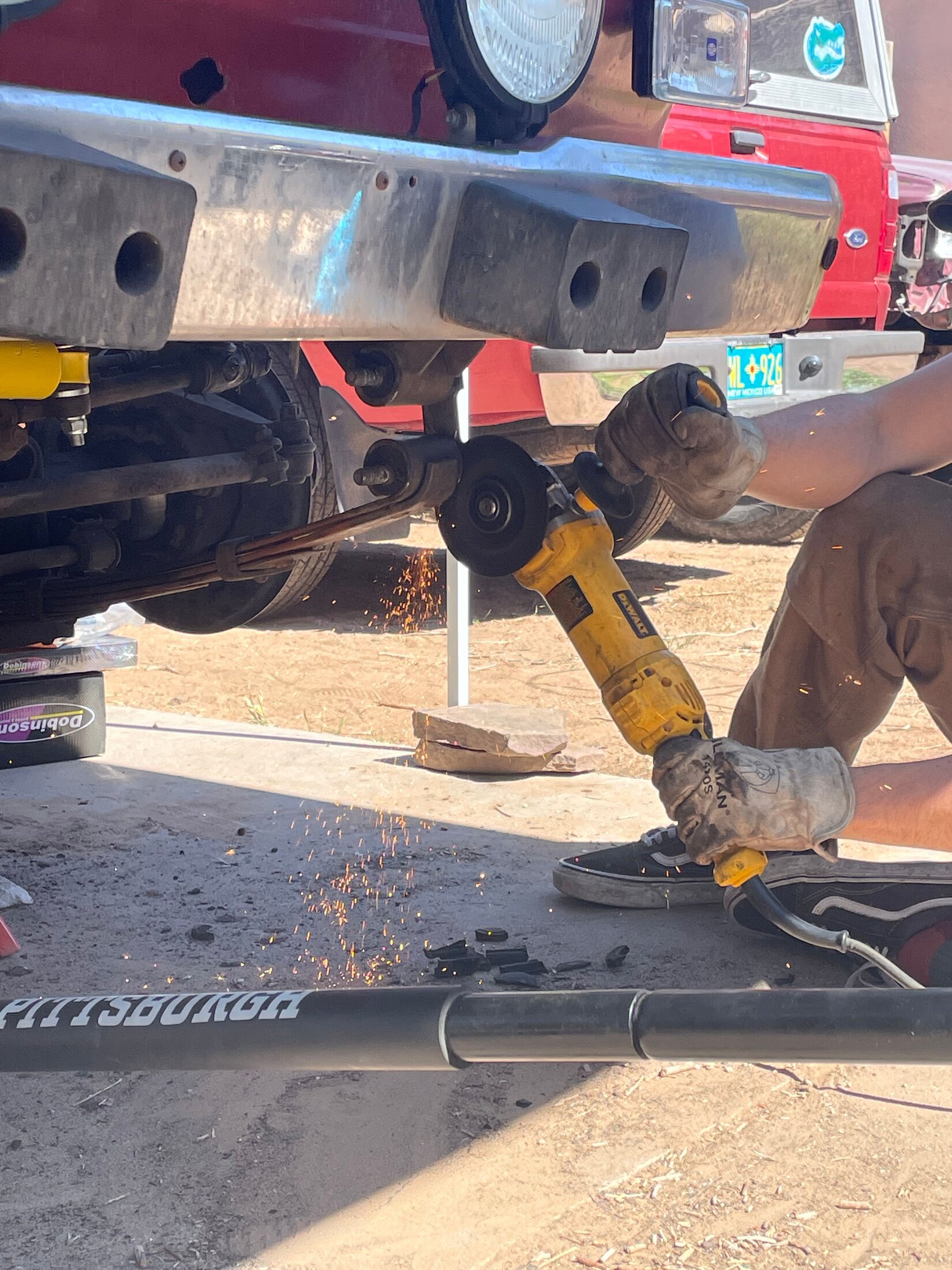

The sawsall wasn't powerful enough; we ended up angle grinding the bolts off. I'll take pics when I get back.
This job is a serious undertaking. The interweb makes it look easy, but it's not. Finally figured out an approach that got a leaf spring out, and didn't need a welder to add metal back. Rolling up the sleeves and getting dirty again today.

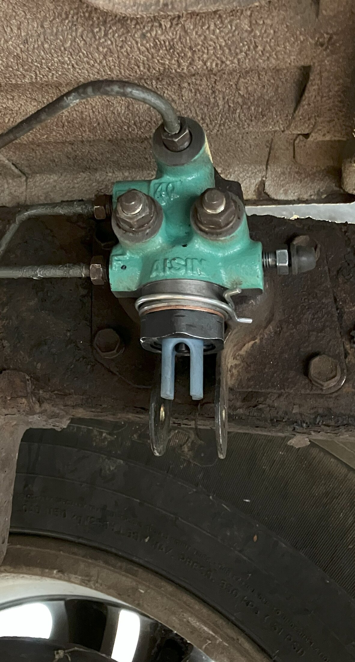

I replaced the load-sensing proportioning valve for the rear brakes of an '87 Toyota 4runner. I purchased a rebuild kit for the rest of the system and will install the boot and arm next. Hydraulics 😍
Finished the LSP valve install and bled the brakes.
