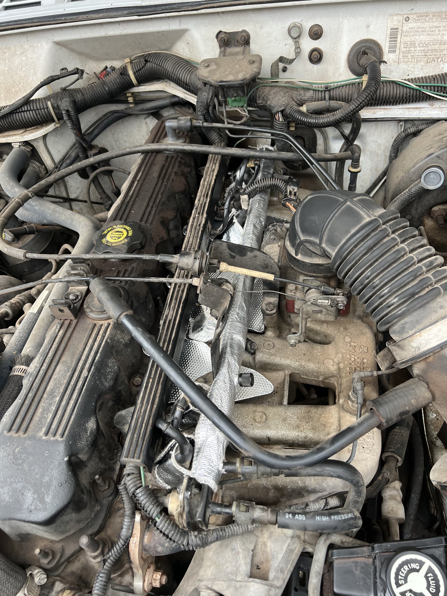

Also the heep has had some projects going on lately.
First time using DEI heat wrap/shielding products and I will be looking for excuses to use their stuff on everything now. I used DEI a Velcro heat reflective wrap on the injectors and fuel rail and a precut heat shield. The 4.0s run really hot and sometimes can run poorly from the exhaust boiling the fuel in the fuel rail, running the return style fuel rail vs the returnless and this heat wrap should take care of it.

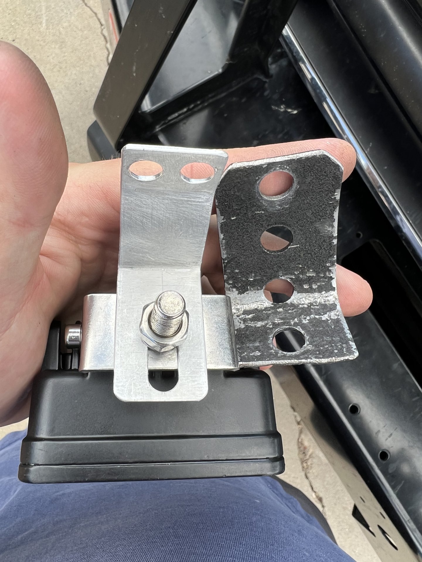

Mocked up some lights on the 4runner yesterday
Decided I liked the placement enough to make nice brackets today
Aluminum bracket vs bracket made with a hammer and scrap metal.
Will probably make revision three of the bracket wider and change the slot for side to side movement vs front to back also will probably trim the grill away in front of the light
Rigged some wires just to show them on. Currently trying to decide on a switch panel so install isn’t fully complete

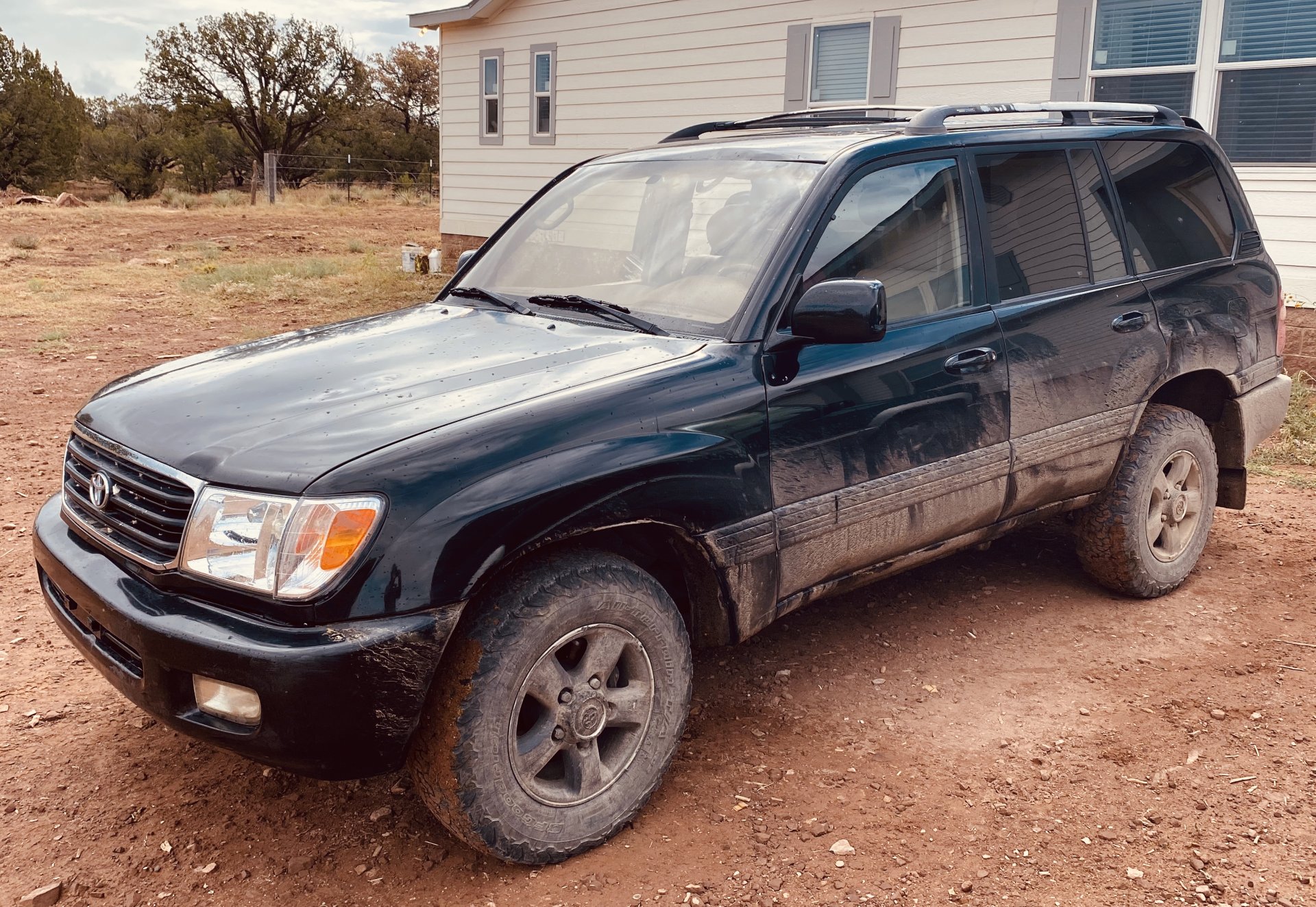

Does anyone know where I could get body panels for a 100? I need passenger side doors and front fenders, I’d take a hood too. I’m getting a complete color change in mid November. I’m in a little place called Ancho 20 miles north of Carrizozo.

Hey man,
Welcome to the hood and a good looking ride you got there. Do you mind introducing yourself on a new thread since you're a New Mexican? Looks like you have a Landcruiser obsession as well ;)
