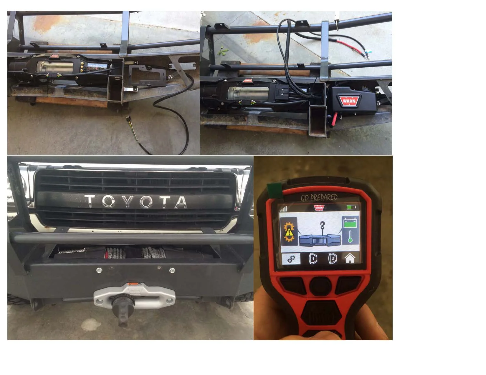

Finished installing a Warn Zeon winch on a non-winch ARB bumper. Almost everything works.... :bang:

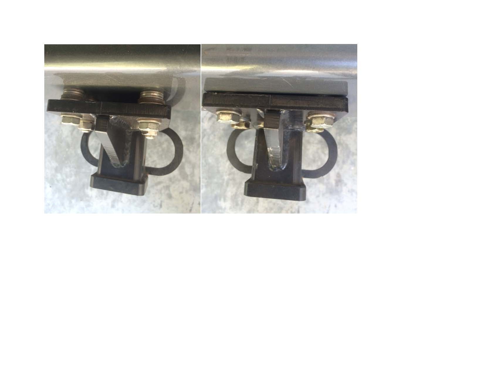

I had to modify the Man-A-Fre hitch receiver so it would fit flush against the Iron Pig bumper. Prior owner liked the "miscellaneous washers" look.
