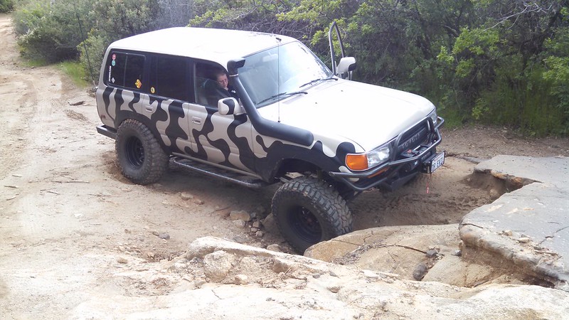

Crossed our first creek of the season

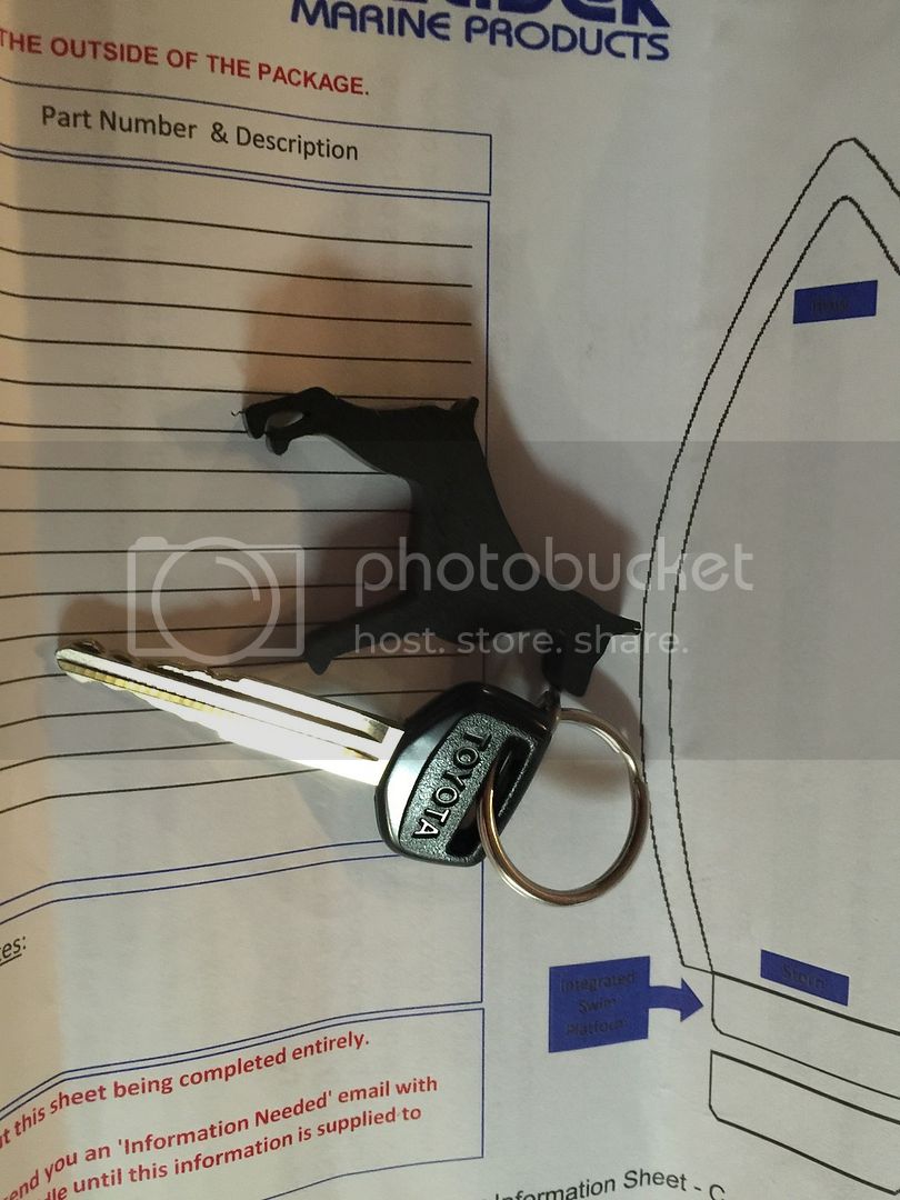

I bought the new OEM Steel key blanks on eBay for $13ea and have them cut at a local lock and key business for a few bucks each. There aren't any chips in these trucks for the keys so it's pretty easy.
I went by the dealership first and they told my vehicle was too old for them to cut the key. I don't think they had the older key blanks which are longer and wider than the current keys.
The dealer in Placerville, CA supplied the blanks and cut them for me for $10 each.

New OEM Toyota keys cut.
I bought the blanks on eBay for $13ea and had the local locksmith cut them for $5ea. They came out great!

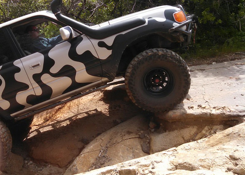

On Saturday ran the Hewitt Canyon Trail/Montana Mountain loop. Missed out going with the CSC crew, managed to go later in the day. Shot everything with my S7 Edge and was playing around with it's video editor. Never done it before but thought it turned out ok. Forgot to change the settings so its not at its highest HD setting. There are a lot of short vid sections that give a good idea of the trail. Still photos at the end. I know one was out of order but it's pretty accurate as the trail goes. Threw some U2 in there, wasn't quite sure how to do it but good enough.
