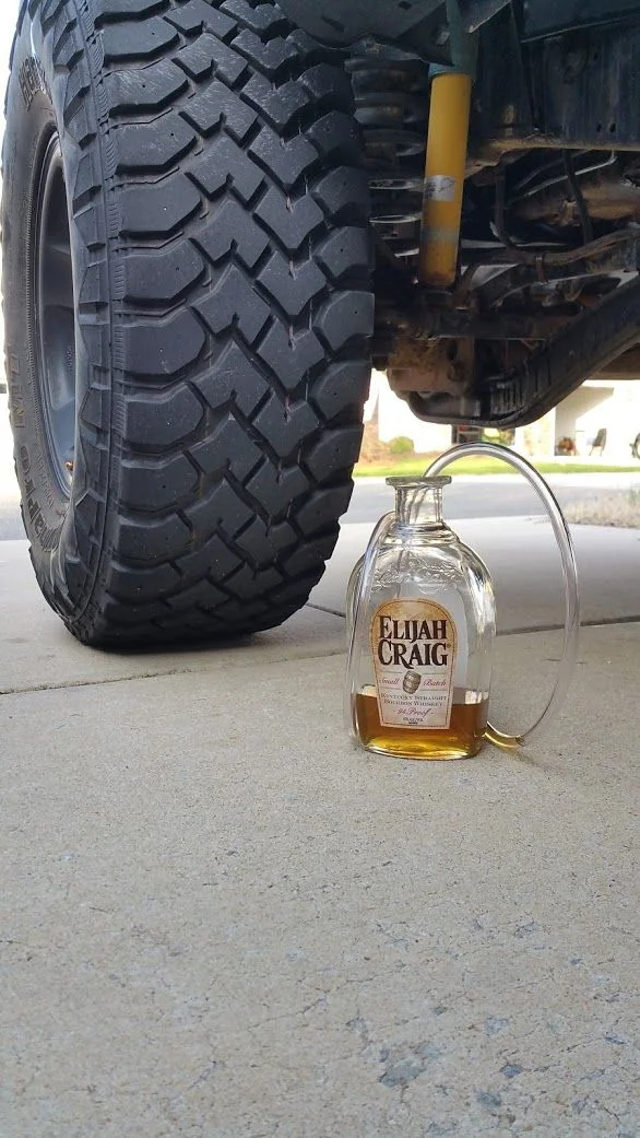

View attachment 1220336 Much need it brake fluid flush. The fluid coming out was black. I'm glad I did it.
I replaced the rear calipers on Saturday and bleed the system using the Power Bleeder as well. Even with 15 psi, the Power Bleeder didn't provide enough punch to get the air bubbles out.
That ain't Elijah Craig in the bottle.
