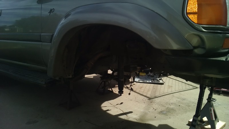

Removed the front axle.
Did it take that much more time to get it out?
I mean brake lines, steering, shocks, arms etc... is it worth it?
It's just a 3rd, axles, bearings & spindles.
Are you going to paint it?
It would be a good time to check for cracks at the arm brackets & beaf up the welds at the sway bar mounts since it's out now.
D
If you have the right tools, it's not really much extra effort. After I pulled the knuckles and axles it was about 1.5 hours of work to have the housing, thiird and arms on a dolly. By the right tools, I mean a good impact gun for the suspension bolts and a pitman arm puller for the ball joints.
I'm replacing all the rubber brake lines, putting an ARB air locker in the third, replacing the tie rod ends, replacing all suspension bushings, all new bearings, and more so it made sense to me to just pull the whole thing off, clean it up nice, and paint it before putting it all back.
