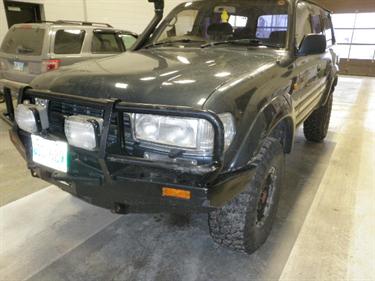

Mr. jits, Looks good, I've been looking at mine an wanting to do the same. Wish your photography matched your fabrication, I'd like to see better pics:cheers:
Crappy cell phone camera. I'll get some better pics up tomorrow when it's light out.
It wasn't that hard to do. I cut off the bottom lip, boxed in and gusseted the wings and added Comp4x4's weld through clevis mounts. The Clevis mounts are fairly exposed, but they're welded 3/4 of the way around where they stick out of the face of the bumper, and around the entire mount where it attaches to the frame mounts of the ARB. Should be plenty strong for recovery.
mr jits said:
Finished product.
Looks good man... I like it, looks like a 60 series bar almost.

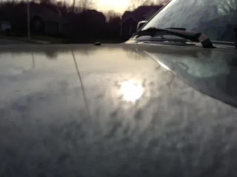

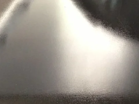

The previous owner of my 80 had the hood repainted due to clear coat peel in the factory finish. The respray was poor, with considerable orange peel and general blemishes. After staring at it through the windshield long enough, I decided to bust out some sandpaper and refinish the surface.
I began with 2,000 grit wet paper and finished with 3,000. I should have started with 1,500 or even 1,000, but I worked with what I had on hand. "Cheap" projects are the best, you know.
Once I got the surface relatively flat, I buffed it out with 3M compound, then hit it with a 3M glaze and finished with a 3M ultra fine machine polish.
I'm pretty happy with the results.
Before:
After:

Beaded up like a stud! Nice work.

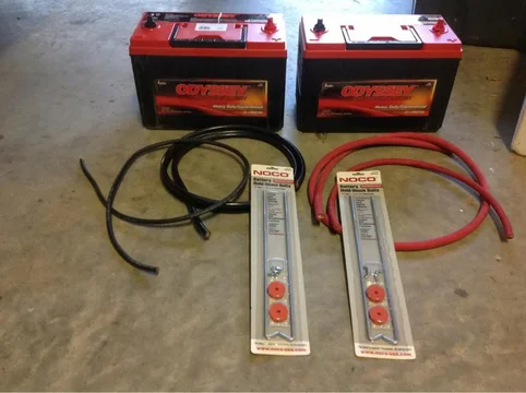

This weekends projects include installing a new radiator, and these:
Not looking forward to lifting these up there!
