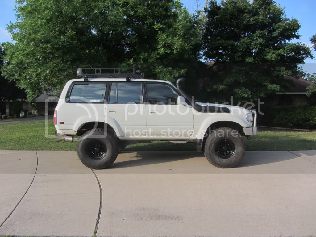

Took my friends wheeling for the first time and scared the bageebies out of them :)
How'd you prep those wheels Harry- what'd you shoot em with- look good-
I used graphite metallic wheel paint. Matches my brother's LX450 really well. I usually will do things the "correct" way but in this case I had a feeling I could do it easily without removing the tires or even the wheels from the rig. I did however get the wheels off of the ground so I could spin them as I painted to get into all of the nooks and crannies. I paint quite a bit and have a steady hand so sanded them down, wiped them clean with mineral spirits and let them dry for five minutes. I then masked the main area of the spokes but did not make an attempt to mask perfectly around the entire cove lip. I cleaned up any overspray quickly with mineral spirits. I'm not saying this is how you should do it but it worked very well for me and it only took two hours. I'm very pleased with the results and love the look.

kybishop said:
Installed OME heavies and Doetsch Pre-runner shocks. It looks, rides and drives great. Not harsh at all, very nice ride. I am loving it so far. Thanks forum member lukefj for a great job putting these on with very little assistance from me. Your a great guy to work with and I enjoyed meeting and talking to you.
I also bench bled and installed a new brake master cylinder and bled the system. Fixed my problem of intermittent loss of brake pedal.
Replaced the worn out rear wiper blade.
I will post pictures soon in a separate thread of the lift. Higher lift than I was expecting from the worn out stock springs but much welcomed.
I'm assuming this is the one he told me went a lot better than he thought it would.
