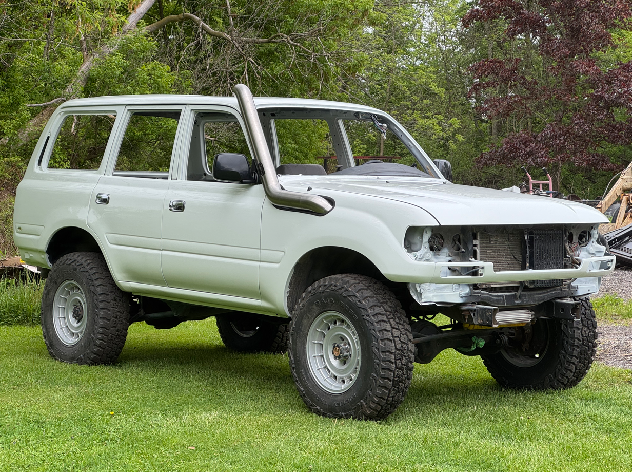

Looking awesome. What tool did you use to cut your fender for the snorkel? I have a radius sitting in a box, really need to get around to installing it.
I used an air body saw, and a Milwaukee band file for cleanup.
-Rob

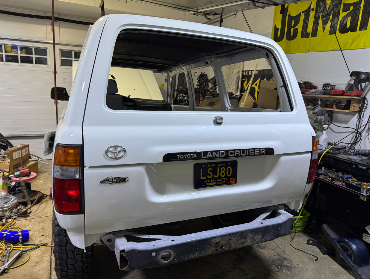

Truck is back from paint, and getting a full exterior / interior rebuild.
Glass out color change to 045 White
Deflared
Poverty pack chrome trim / handles / black mirrors
Sunroof delete
Roof rack delete
Rear wiper delete
Quad headlights
New emblems
Fresh powdercoat on bumpers and sliders
Radius snorkel / airbox
Sound deadening
And a thousand other things I'm sure I'm forgetting
-Rob
Looks awesome. Hoping to get a similar (glass out) paint job in the near future. How did the side window frames look when they were pulled? Any corrosion on the frames or the body around them? Also, where did you source your quad head lights? I've been considering those, but having trouble finding OEM from the Australia models.
Thanks!
The side window frames were mint. The only corrosion I found in the window frames was some surface rust and minor pitting under the front windshield, in one of the corners, as well as a small hole in the hatch under the rear window.
I sourced the quads from a number of different places:
OEM Brackets and surrounds from cruisermatt
Custom Harness and buckets / frames from jcardona1
Generic Springs from ebay
Depo Corners from Amazon
Cheap LED Lights from eBay
You won't save any money piecing it together yourself, pick up a full kit from someone that has all the parts together! I know that jcardona1 frequently has full kits for sale.
-Rob
