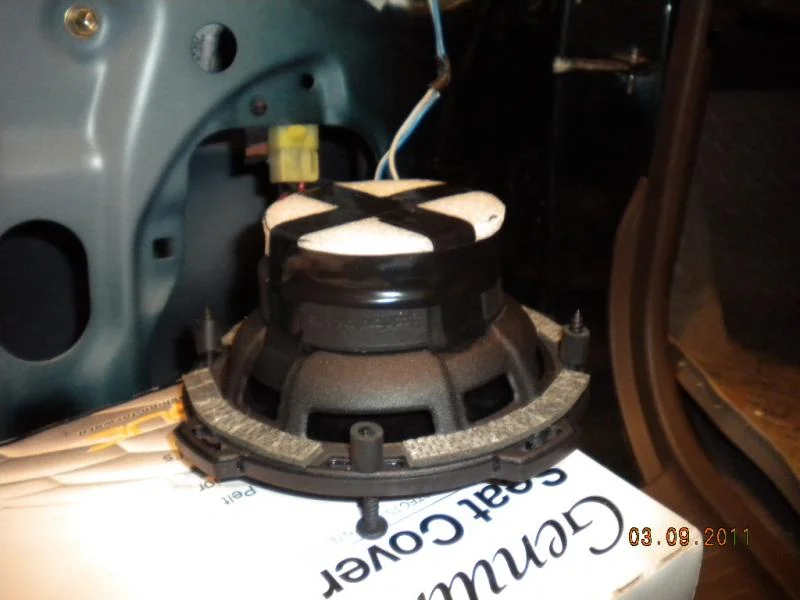

front doors - after researching the various threads I was convinced shallow mount 6.5" mounted under the door panel with factory grills was the way to go. There's just no aftermarket grille with low enough profile to fit when you close door. I ended up going with Rockford Fosgate P1S652 shallow mount with a 1.89" depth and hole diameter that matched the factory of 5.59". I ended up dispensing with the foam you see in pics and just used the spacers made out of vacuum tubing to prevent magnet from touching the window lift and grey foam tape for vibration issues. I had to enlarge the door liner opening with a tin snips to accommodate the larger speaker. reinstalled door panel, drilled 3 holes in factory grille, then mounted to speaker/door using 1.5" black phillips head screws. you have to be very careful trimming the leather so as not to split it beyond grille diameter but I think it came out pretty good.

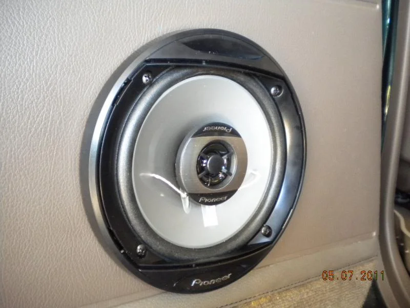

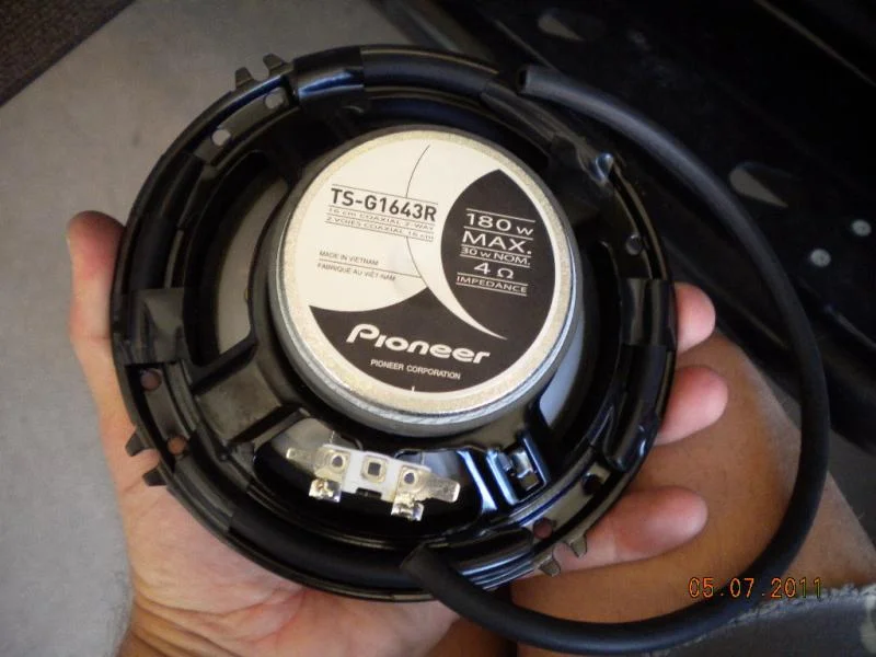

rear doors - first iteration was modifying the existing plastic ring by cutting out the back and mounting 4" Rockford Fosgates so as to use the factory grilles but they just didn't put out good sound. I knew some had fit 6.5's by making mods such as cutting a larger hole for magnet but I really didn't want to do that. The solution was as close as Wal-Mart, minimal mods and only $40! Pioneer TS-1643R 2-way 6.5" with only a 1 5/8 mount depth and 3" magnet which fit existing hole with room to spare! Best part is they mount right over the door panel with the included grille with only a few mm space. I taped 5/32" ID vacuum tubing on back of the speaker as a spacer/vibration absorber; it fit perfectly in the curved recess of the metal ring and prevented the terminals from rubbing on the metal cutout. I soldered the wires to terminal to ensure they'd never come loose. it was a little tricky drilling the 4 new holes since the triangular recess curves in a few mm but turned out fine using #8 2" black phillips head screws. all in all much easier than the fronts and great sound for the $$.

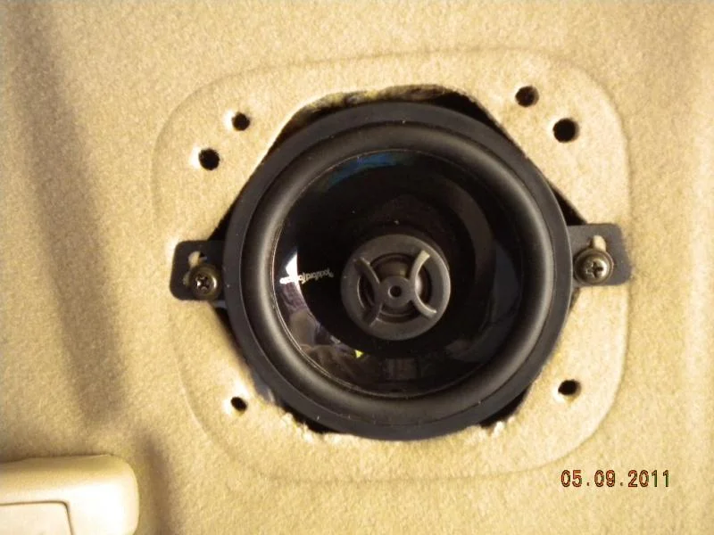

ok, since I was on a roll I decided there must be a solution for the 3rd row headliner speakers. Most 80 owners seem content to just upgrade the front and rear doors but I refuse to compromise! I had initially measured the cutout and determined 3.5" speakers wouldn't fit but apparently I didn't have my creative hat on that day. after removing the factory "speakers" I determined that mount depth was a more than adequate 2" but mount diameter (distance between screw holes) was an odd 3.25". The min mount diameter of the Rockford Fosgates I'd ordered was 4" with a depth of 1.4" so I had to widen the existing bracket by .75". I found this to be a simple matter of bending each leg to the widest part of the hexagonal shaped opening in headliner (see pic). It wasn't even necessary to remove the bracket as they bend very easily. I zip tied speaker to cutout in order to solder connections - critical for such a tight space - and screwed in place. The speaker tabs slightly overlap the headliner but they look fine. I'll likely just velcro some tan felt over them for better aesthetics/dust cover rather than try and mod the factory grilles. You may want to look into Pioneer TS-A878 3.5" which are designated custom fit and might be lower profile. While small the overall sound is definitely improved and will be nice when camping with hatch open. I don't know if the 3rd rows are driven by the new Alpine HU or factory amp if anyone is wondering. Sorry for not taking more pics but you'll see what I mean. Next, sub upgrade...
