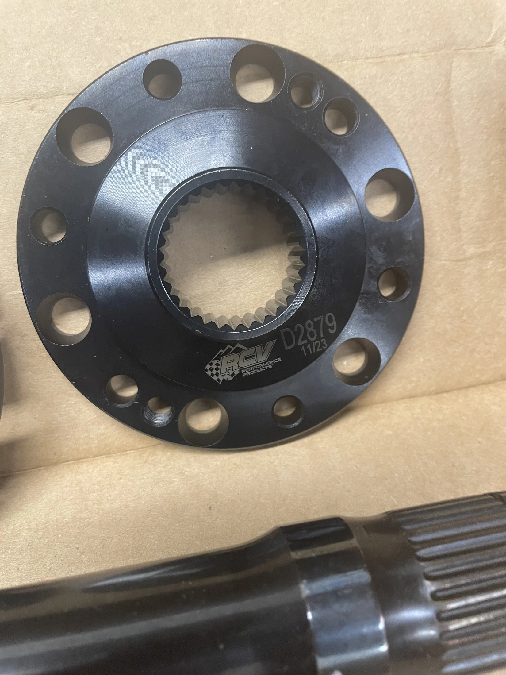

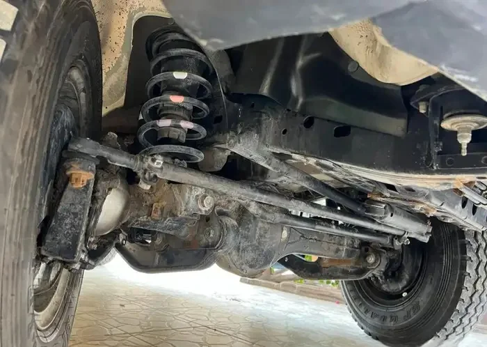

Found some deep dust caps and I had some blue slate metallic laying around in the garage for the color match…double whammy! This is the cheaper fix for the rcv zerk nipple sticking out. Rather than a new flange. Trying to keep this thing in budget is tough so 👀
found these at Trail Gear in case it wasn’t obvious.
Now the trick is to get these installed without knocking off that beautiful paint job! I ended up f'n mine up and just stuck the OEM's back on. In hindsight, I should have used a seal install tool or a proper size piece of pipe just around the flange edge.
Budgets are always tough to stick to, but the later thick flanges are not too expensive for the extra beef. I gave my OEM axles and thick flanges with 175k on them to a local member that had stripped out his early ones...I updated to the Longfield 30mm CM's with new flanges just to have the entire assembly new for my piece of mind, but glad that I kept my decent old parts to pass along as a gift to keep another cruiser on the road!

Yeah, the finish will be hard to keep on there. You make a great point. Everything else on the front end is new, I should spring for new job flanges. 🤘🏼😎🤘🏼

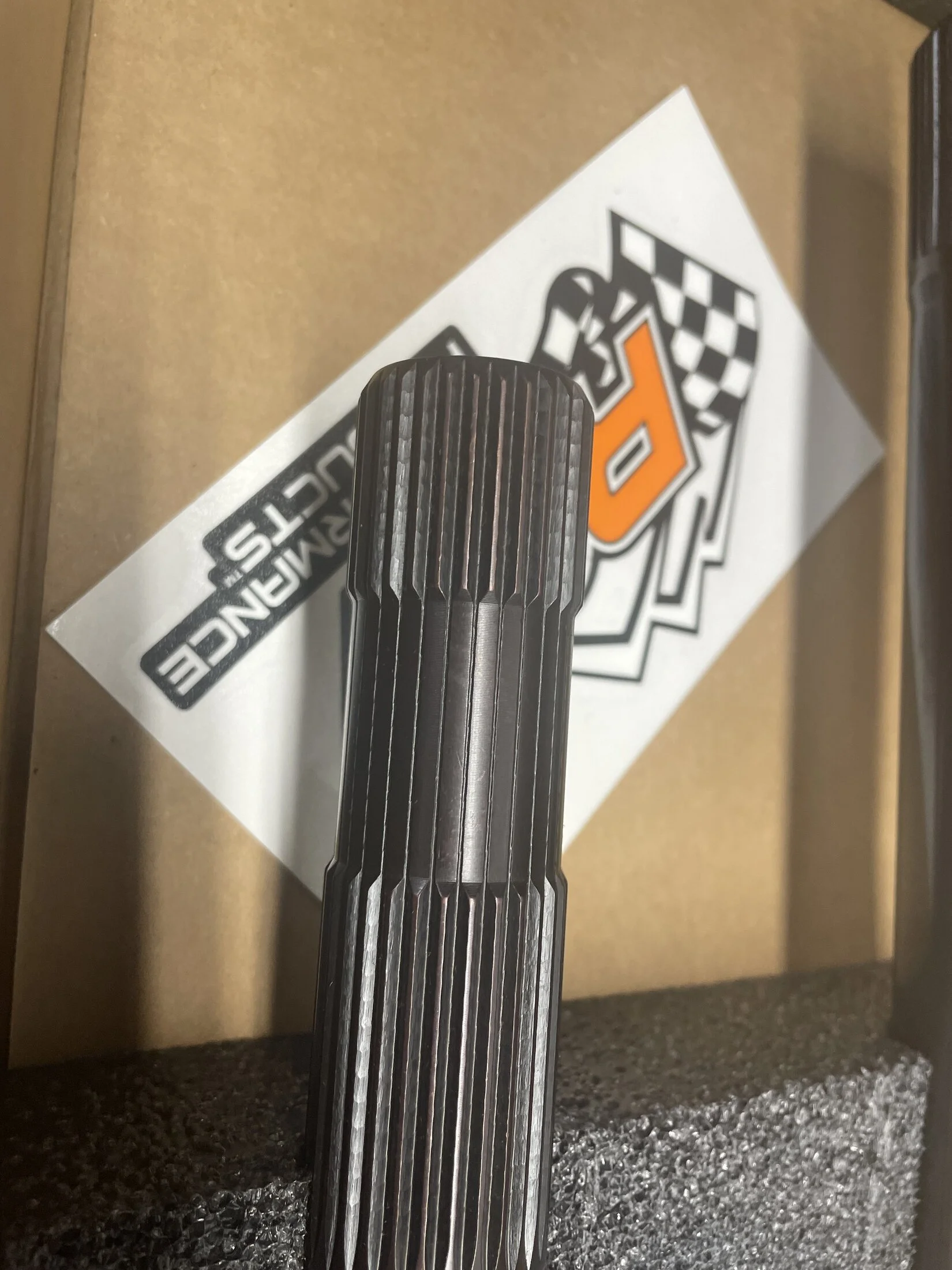

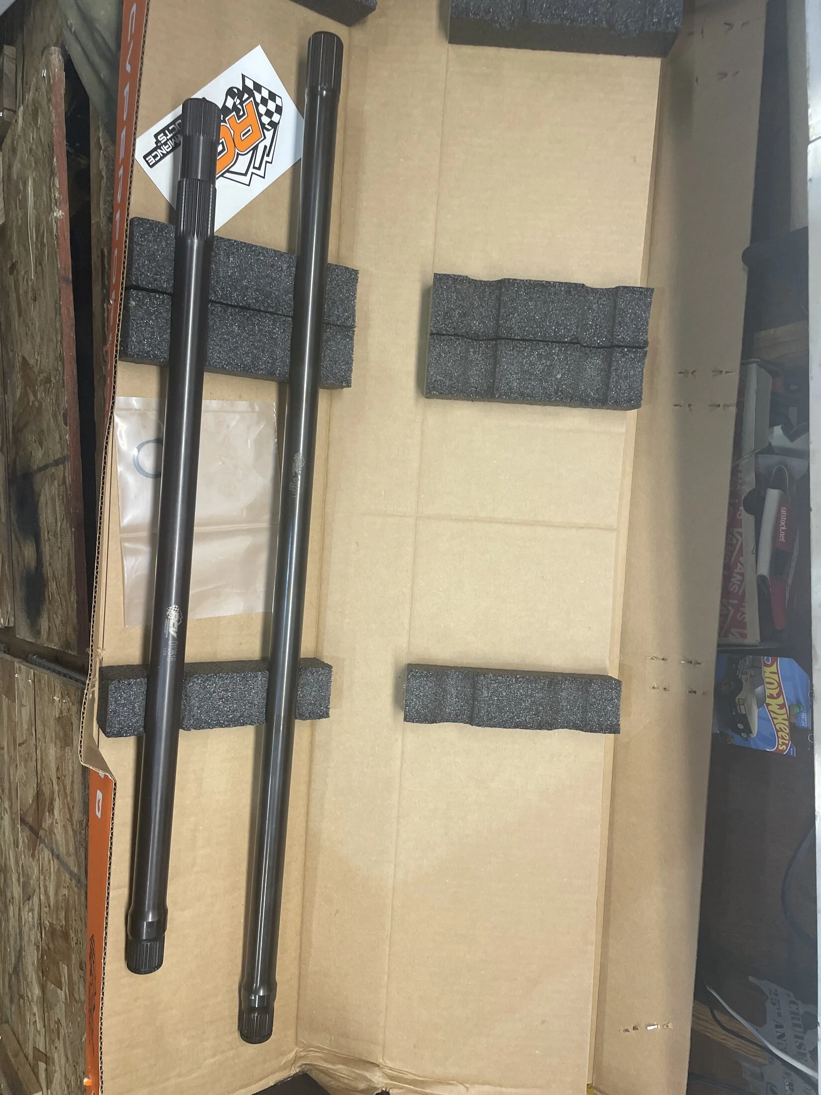

Ordered Thursday morning. Came in today.
