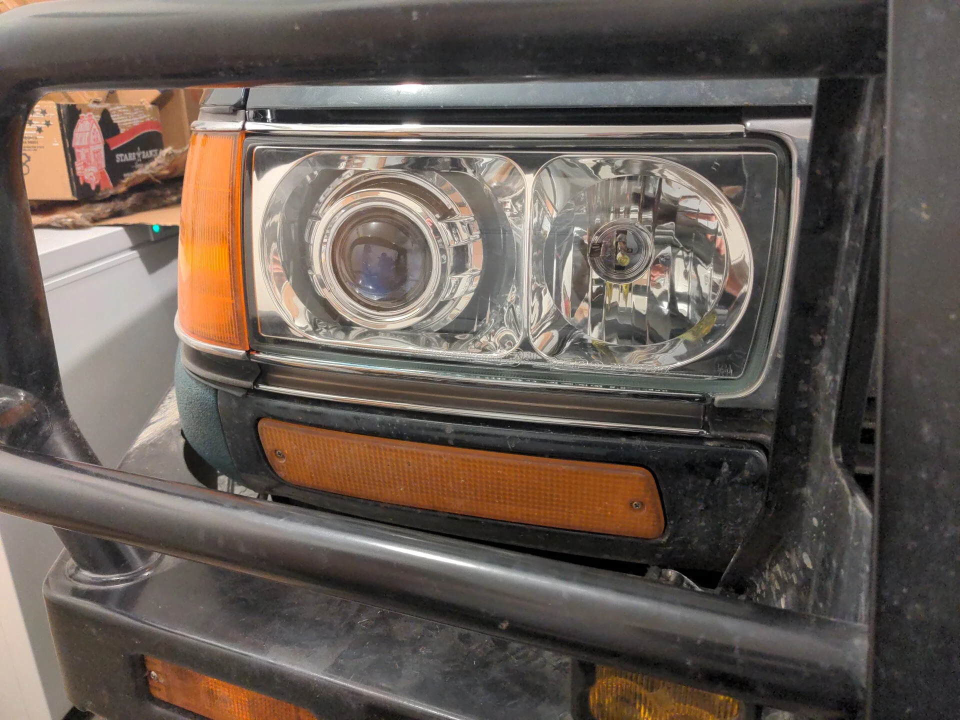

Snapped a few pictures of the light output on my retrofits. Morimoto ds2 minis.
Low beams
High beams
Very happy with the result.

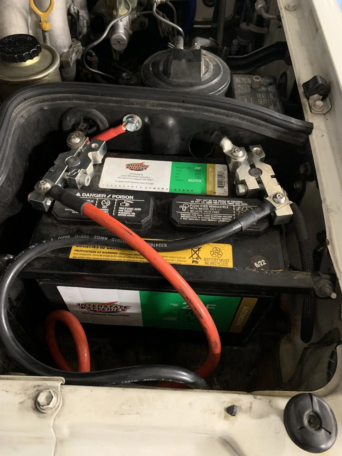

Pretty wet here today so I installed a vac hose to my new booster and cleaned up the battery box, new fusible link and some Slee battery accessories.

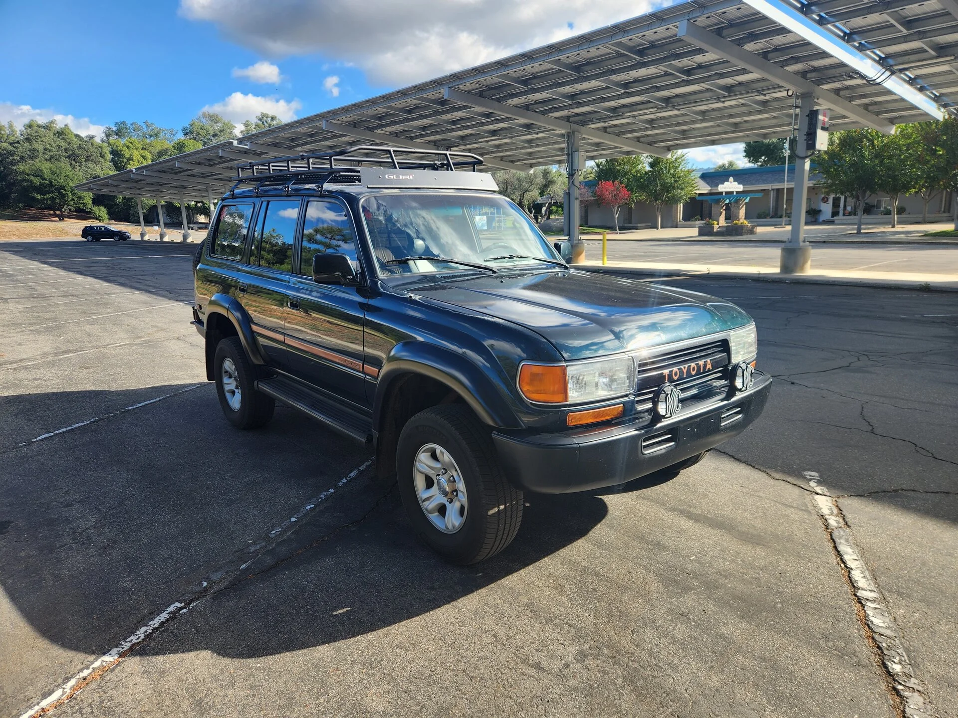

Picked up a second hand Front Runner slimline roof rack yesterday, then did a lot of electrical/electrical prep work today. Wired in my midland GMRS, got the auxbeam fuse box prepped for future lights and other accessories, and ran power cables to the trunk cubby for hard mounting my air compressor and other camping accessories.

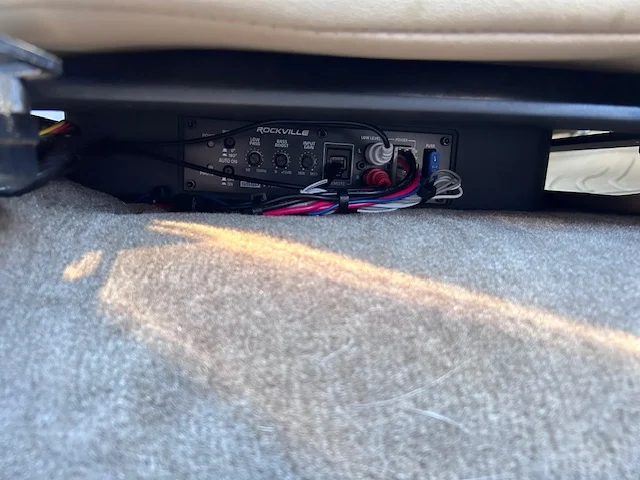

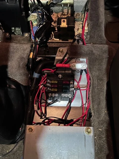

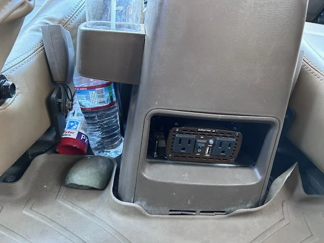

This weekend I spent bringing better power distribution to the center console. Running a new to me under seat 8" sub, my CB radio, alpine amp for door speakers and a small 200w inverter. I mounted the inverter where the CD changer used to be lol. Yes, I did vacuum up all that dog hair before putting everything back together.
For the fuze block I'm running the HOT through a relay that is ignition controlled while the inverter is direct and can be flipped on with the vehicle off. System is wired directly to the battery through a 50A breaker on 6 guage wiring. I have a run of the same going to the rear of the truck (currently disconnected but can hook up at that 2 post bus at the center console. Most of my time was spent undoing some hacky wiring I did in the past and a lot of shrink wrapping.
Wonder if there is something out there as a blank plate to cut out for the inverter so its not so open like that?
Best use of the CD changer! I used a sheet of ABS and cut to fit. My inverter looks very similar to yours, so if you shift it further to the side there is plenty of room for a 12v receptacle too.
