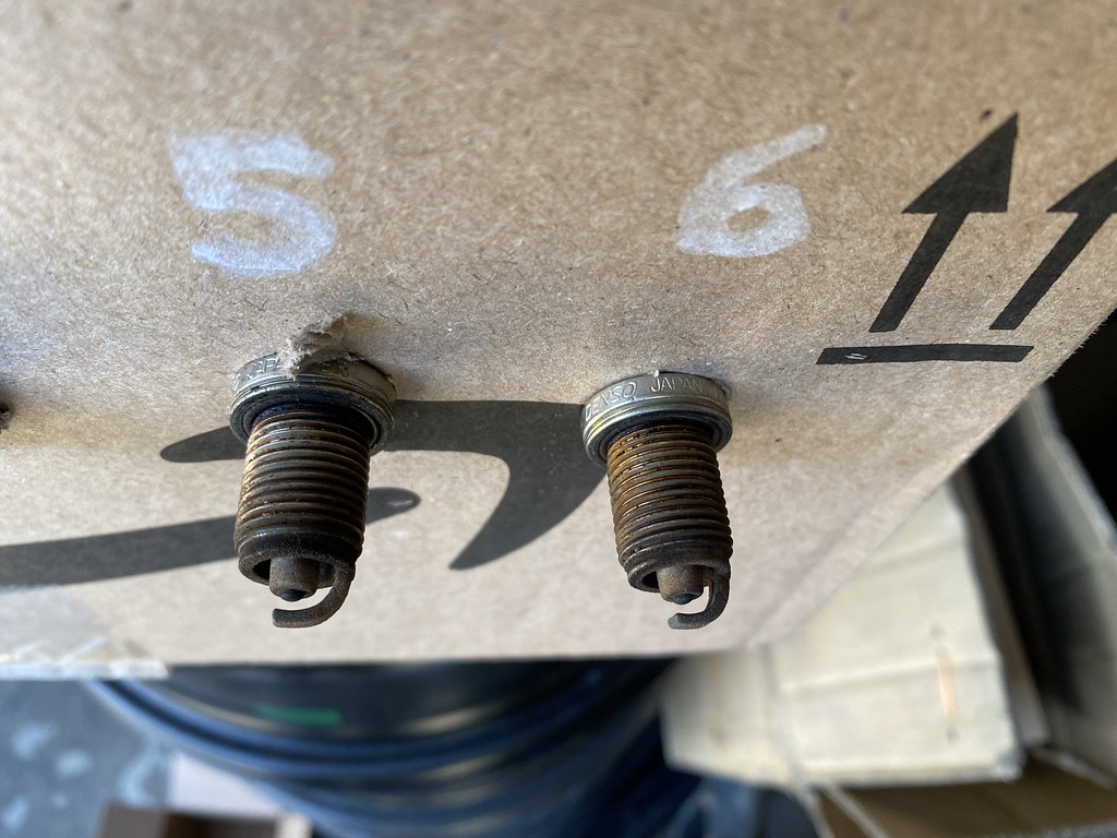

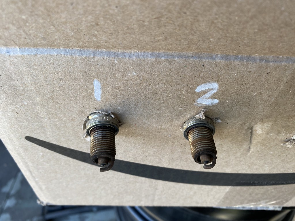

I parked the truck in my driveway when the leak started and stopped driving the truck. Oddly, I went to move the truck one day and the CEL was on with a code for a misfire in cyl 1. Seemed odd since it was running fine when I parked it but it was definitely misfiring and running rough when I moved the truck. I only ran the motor for about 30 seconds. I suspected the issue might be bad spark plugs so I went ahead and ordered new OEM plugs, plug wires, distributor cap and rotor and crossed my fingers it wasn't something more serious.
I got the plugs swapped out and the plugs didn't look bad in terms of fouling but the electrodes were just about gone so the plug gap was clearly out of spec. Evidence of silt (more on that later) inside the distributor cap.

The new plugs etc seem to have solved the misfire. Truck is now running nice and smooth and no CEL. I'll keep an eye on things and see if anything else seems off but for now I'm stoked that the needed repair was pretty minor.

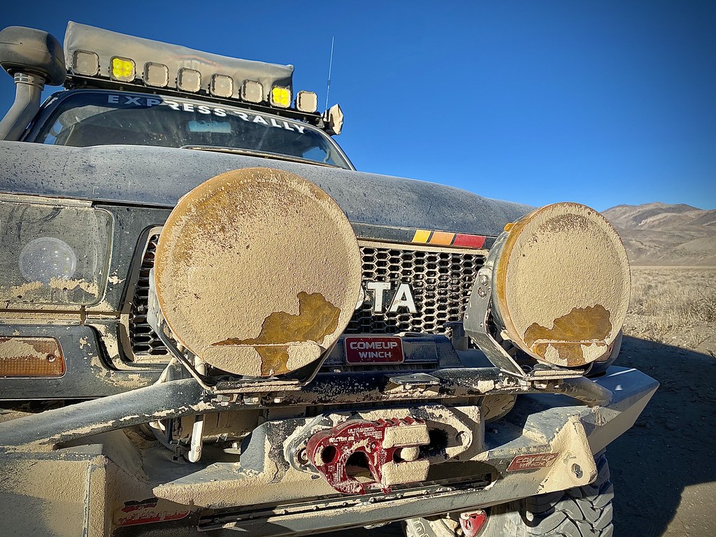

Back to the silt. Last year we drove through a particularly deep silt bed while on a trip. I'm still finding silt inside the truck, it got into EVERYTHING! One of the other victims of silt intrusion was my Freedom Retrofit headlights. Silt got into the lights through the breathers. I pulled the lights out back in March but haven't had a chance to do anything about it. After speaking with Austin at Freedom Outfitters and getting a bit of instruction on how to clean them out I finally had some time yesterday to work on them. It was my first time opening up a set of headlights and I was a bit nervous about getting them sealed back up properly.
Kinda had to see but the left side of the light has a light film of silt on the black interior housing and covering the projector lens.
