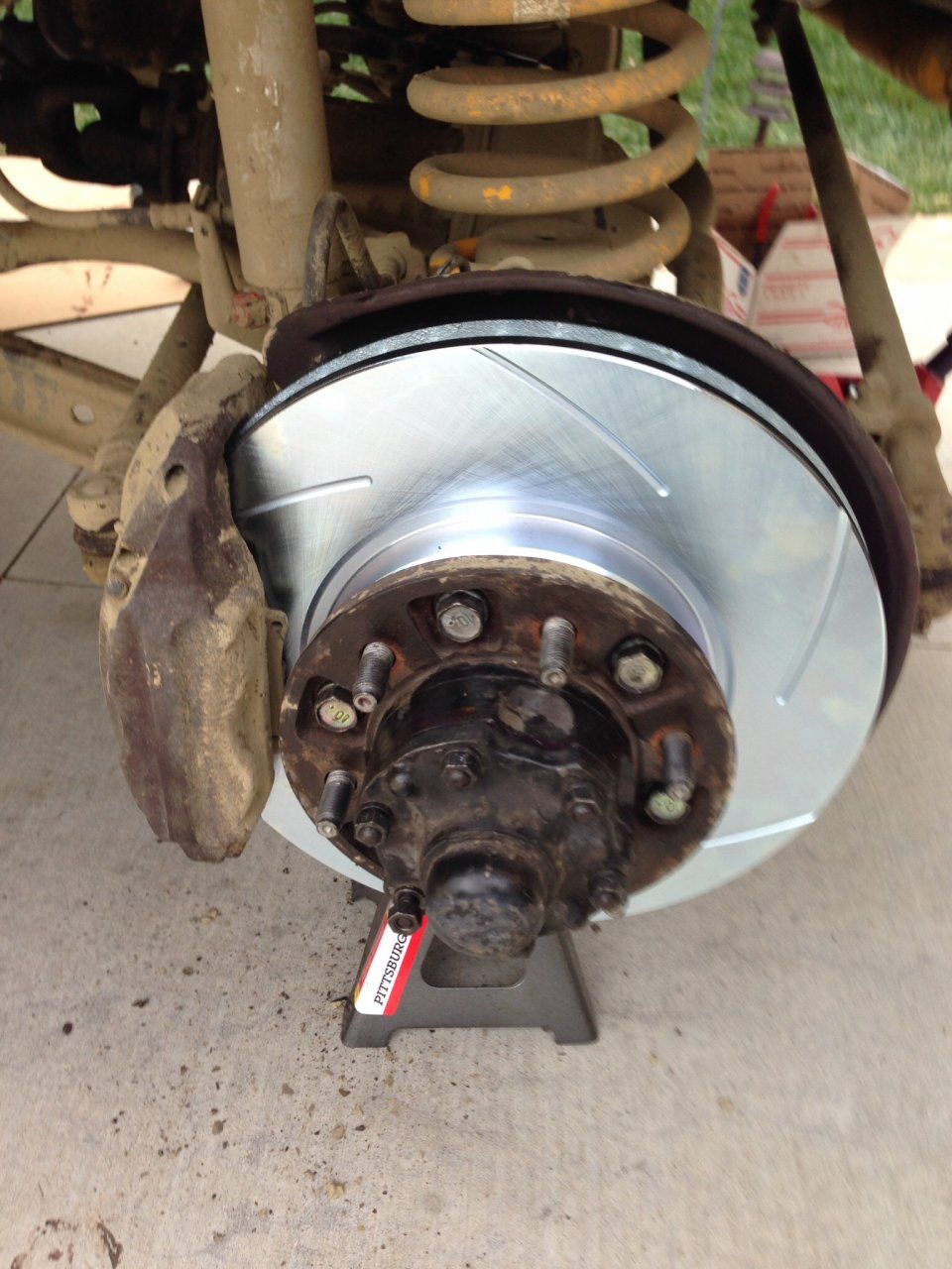

Also installed new front rotors, I got the slotted version. Repacked the bearings and torqued the preload nut to 20-22ft lbs, much better!
After bedding in the brakes she stops much better, even better than when she had 33s on.

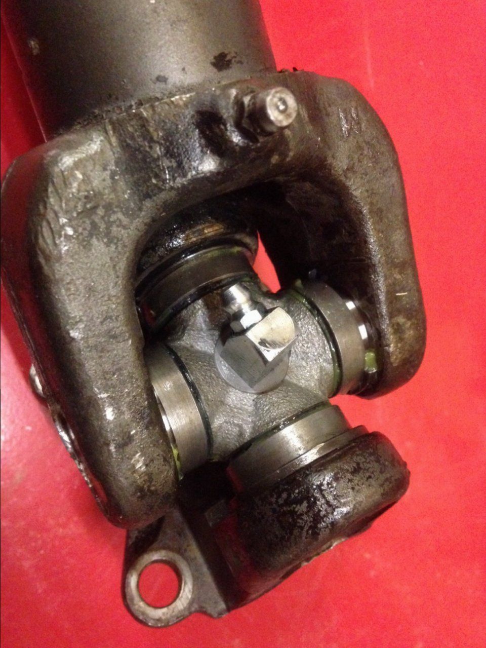

Finished up my front shaft rebuild and got it re-installed. Much more gooder.
Found that using a 12ton press was much easier than trying to hammer them out, and that it really sucks if you push the top cap too far, as there is no going backwards. Then you have to grind the hell out of the cap so it can come out the inside.
Installed my new brackets from Frank. Flipped my rear drive shaft front to back at the suggestion of Bryan at ACC... vibes now gone. Reinstalled my Landtank front shaft
Do you mean that you turned the driveshaft around so the spiine section is now at the diff side? What is the theory behind this?
