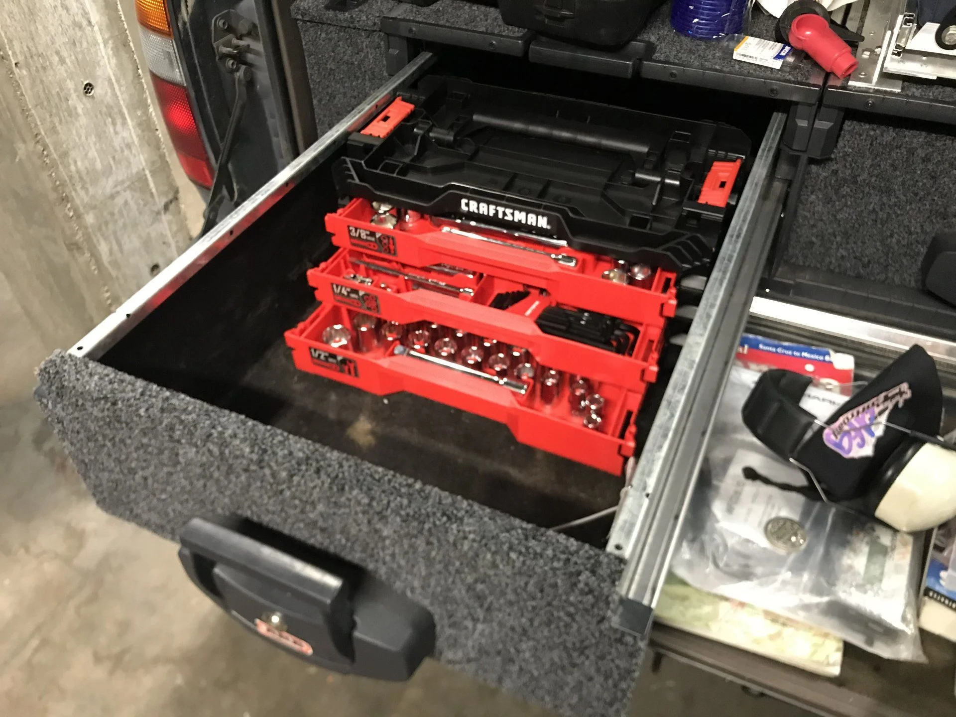

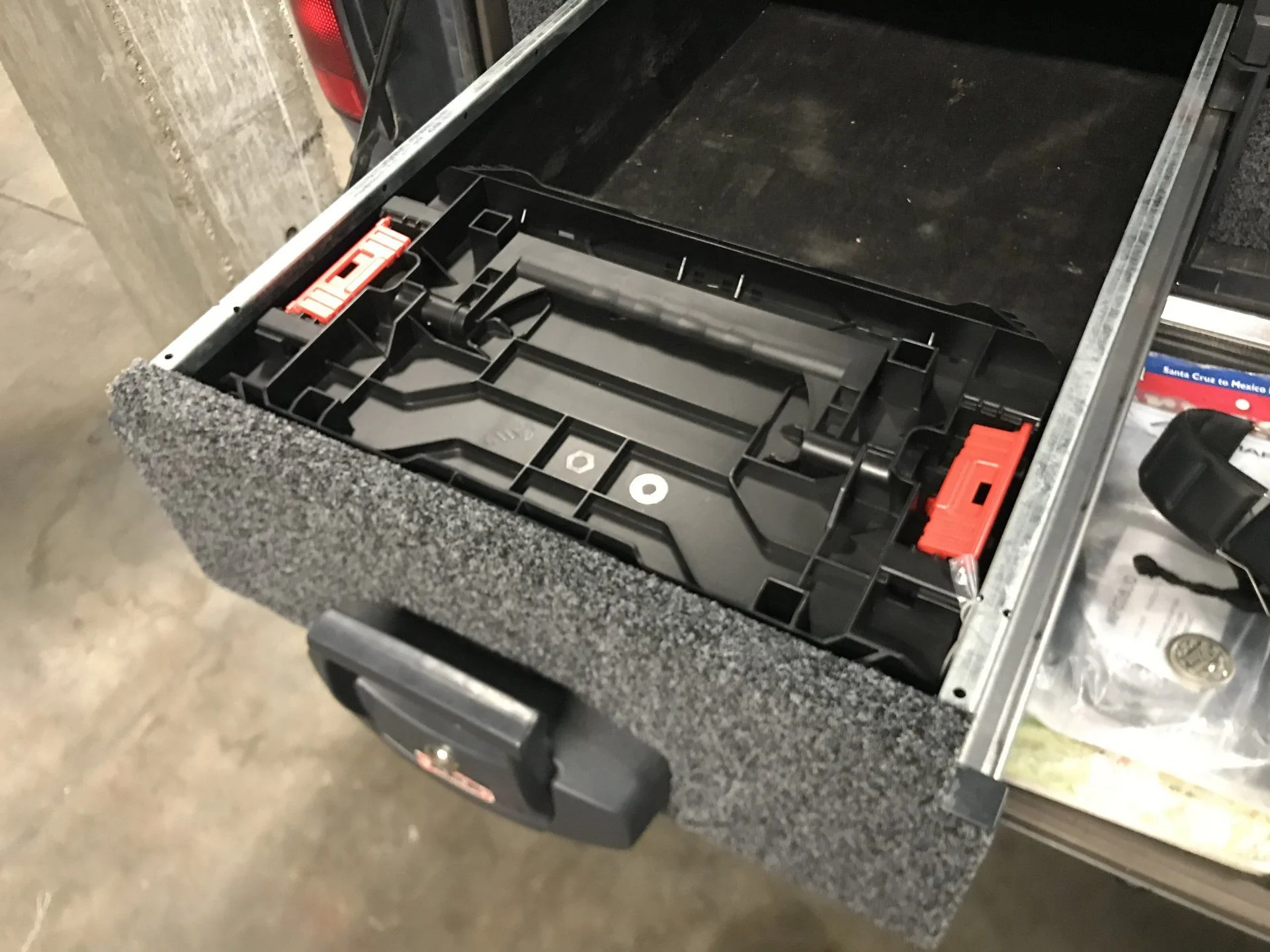

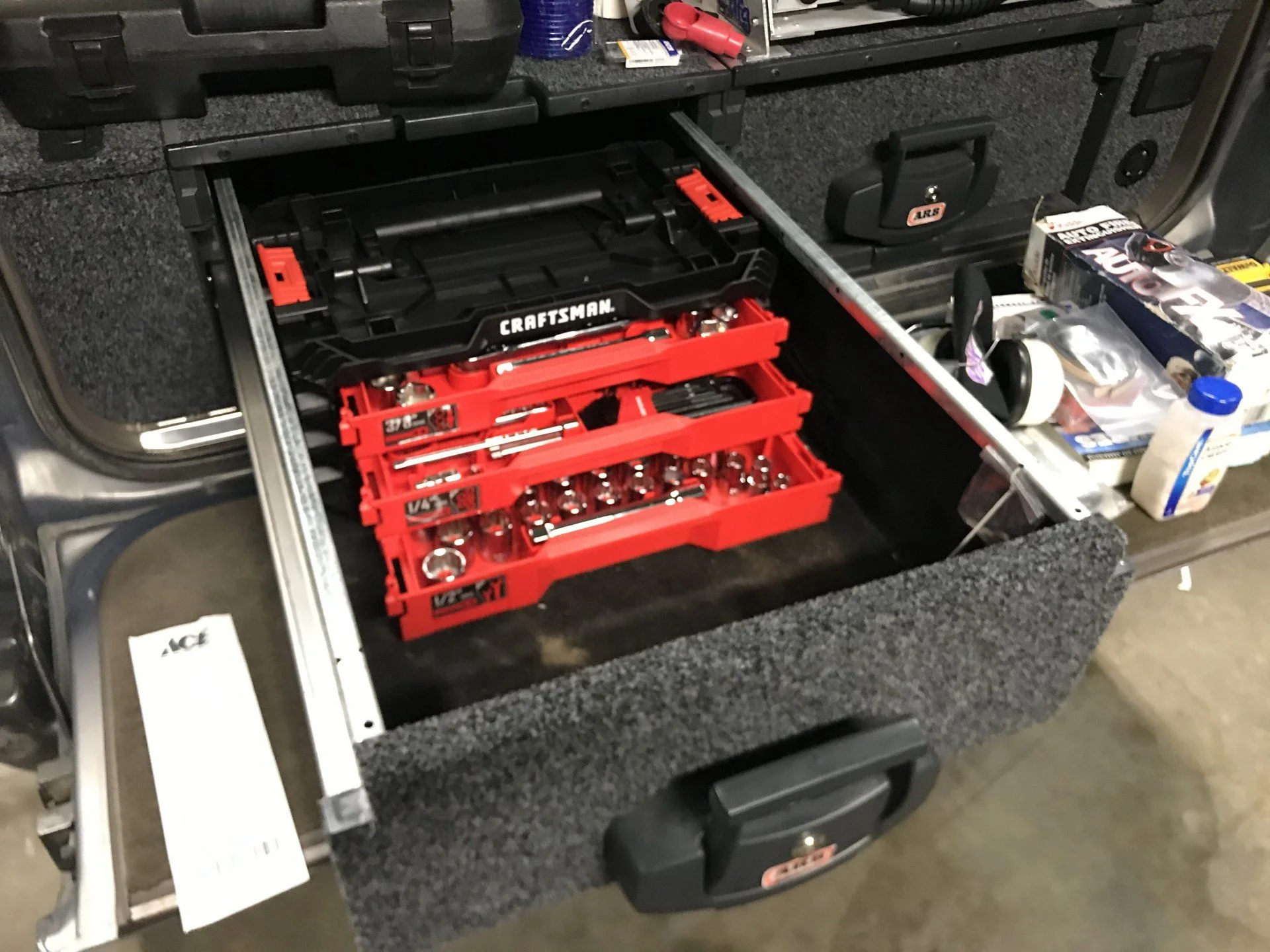

For those with ARB drawers, the Craftsman VersaStack 209 piece tool set fits PERFECTLY. Grab and go with 1/4, 3/8, 1/2 basic set. And latched tool drawers. My tool organizing bliss. For $99, it hit the mark for me. And who doesn’t need another set of tools, right?!
*Not an advertisement, just excited to find a solution that solves lots of problems.
Do the tools rattle inside the versastack case?

I heard a little rattling when I first bought it, and it was sitting on top of the drawers. Inside the drawers, haven’t really noticed anything. Haven’t taken it off road yet, so can’t speak for washboard of dirt, but everything else rattles in those consolations so not concerned about it. I just love the fact that the whole case - organizer and all - fits in the aRB drawer like it was built to spec.

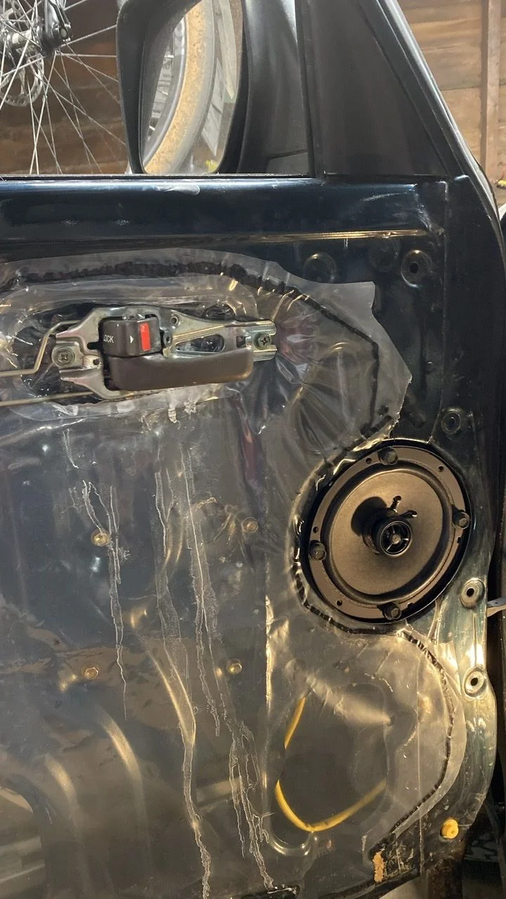

Getting the Retro Sound 6.5” front speakers in was surprisingly straightforward. These are shallow mount depth so no spacer rings are needed and they fit behind the factory grille. I used a ring of butyl to seal against the door metal and hold the speaker in place, it has several hole patterns and one aligns with the stock fasteners. The supplied screws are too thin so I reused stock, which deforms the speaker frame slightly.
They supply a long splice harness and clip/screw fasteners, but no connectors or butyl so bring your own.

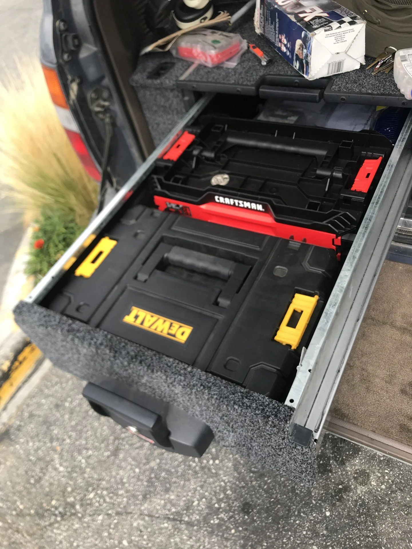

And if you want bulk storage, the DeWalt TSTACK 17” boxes also fit perfectly. (Craftsman and DeWalt are owned by the same company). Loving this system fit in the ARB drawers!

that's good to know. update us when you test them out.

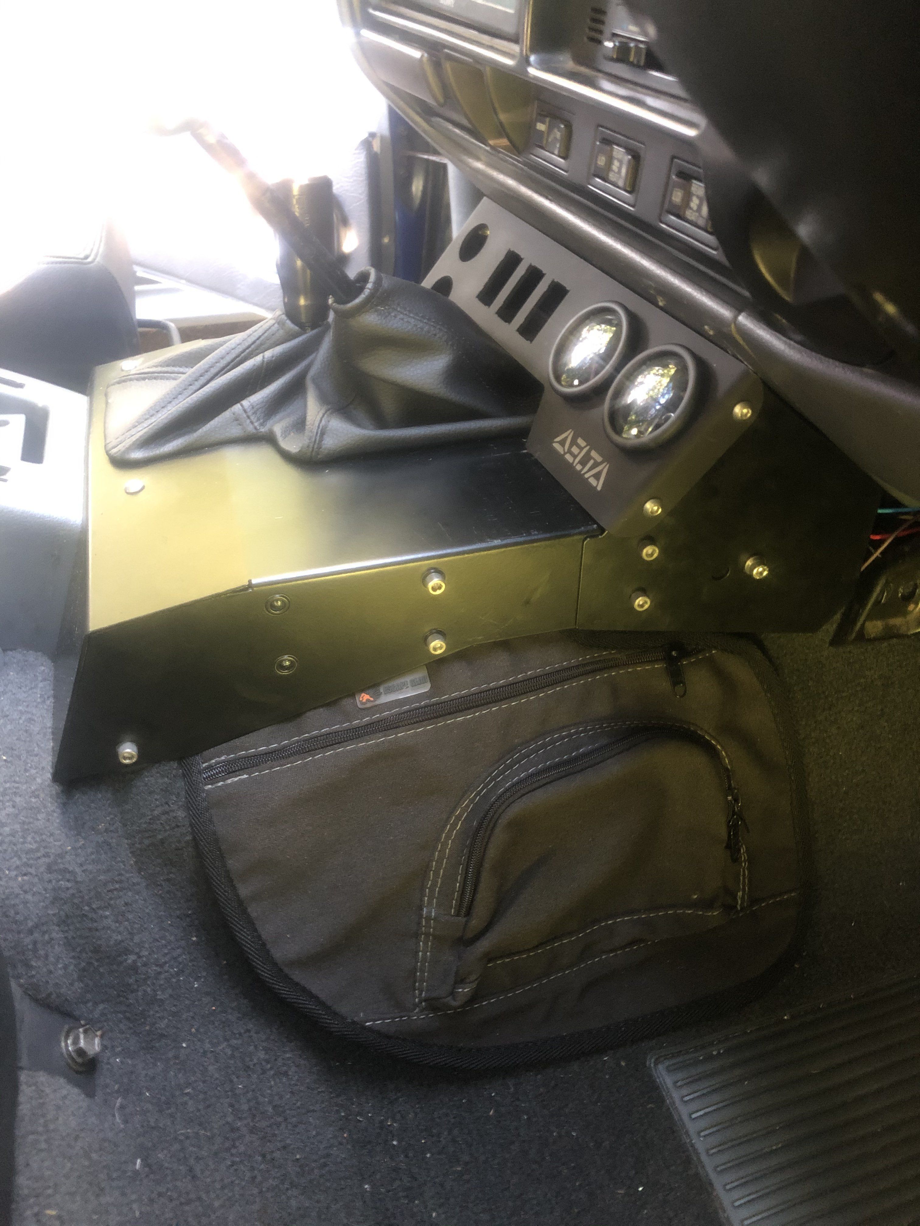

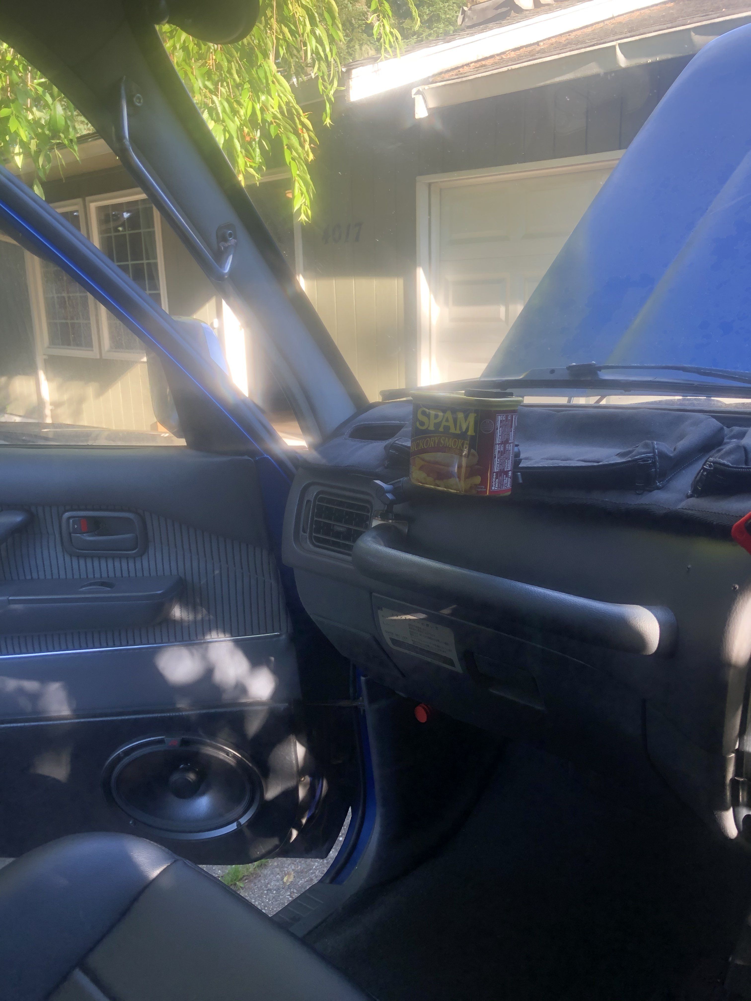

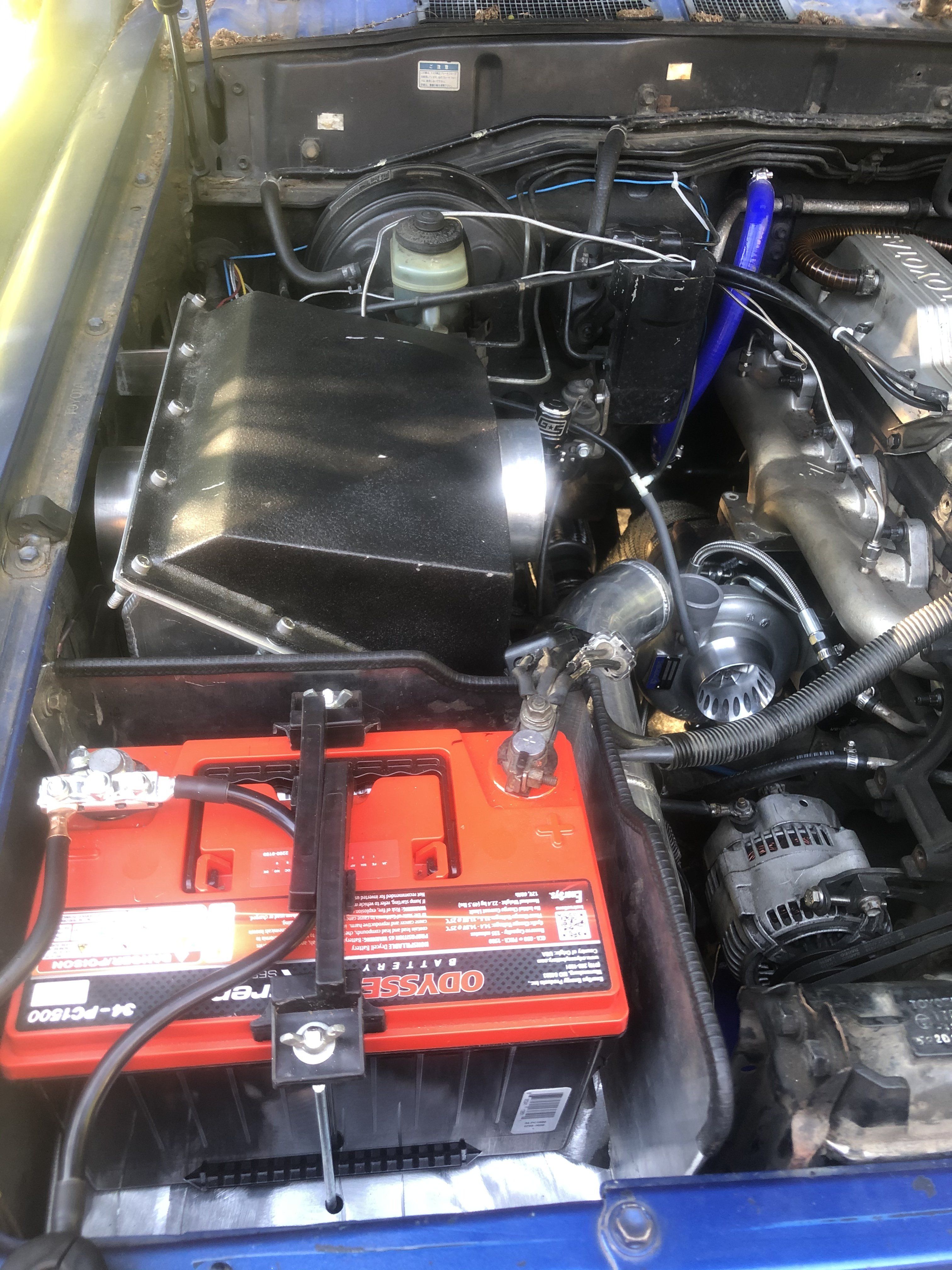

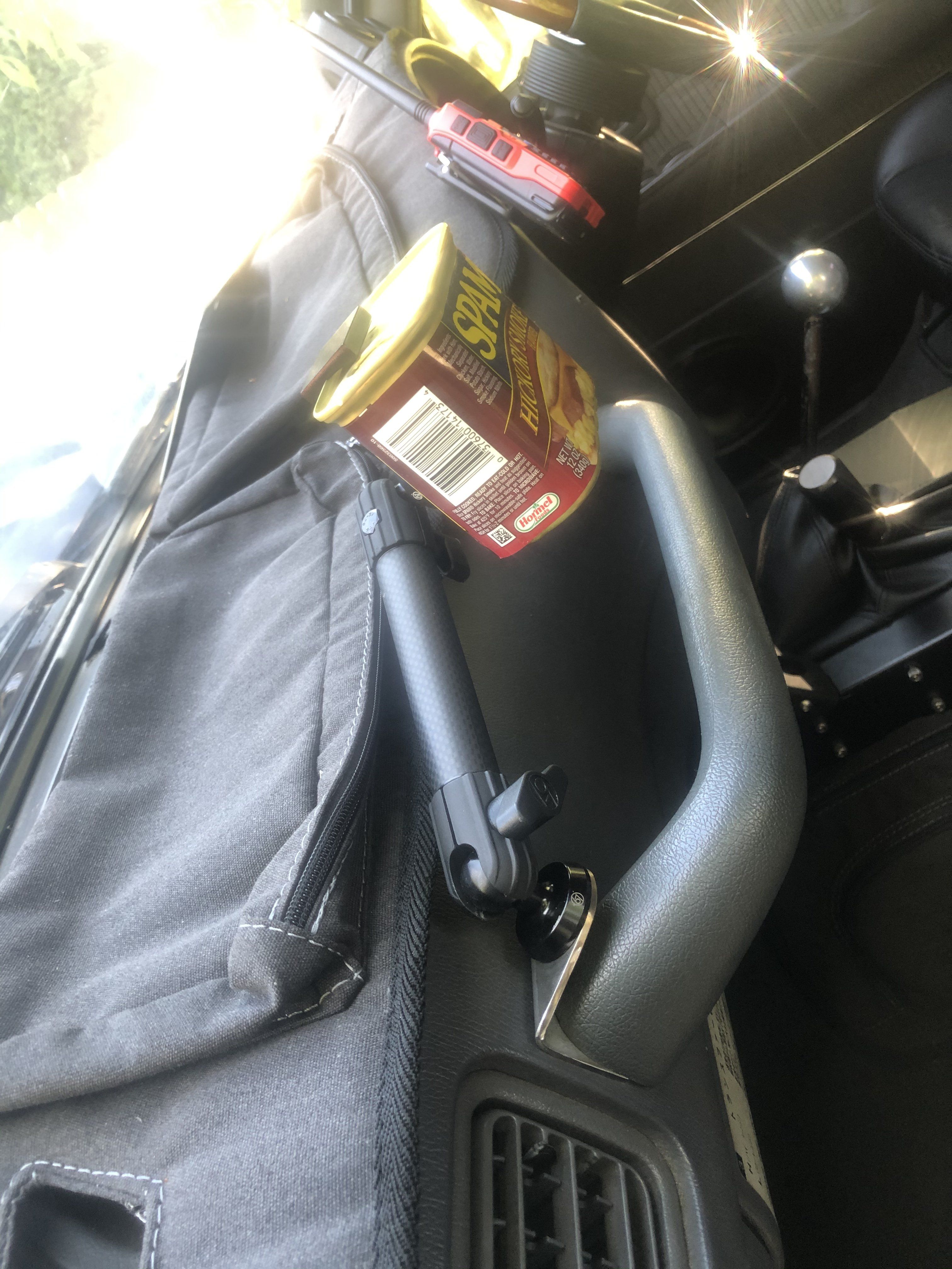

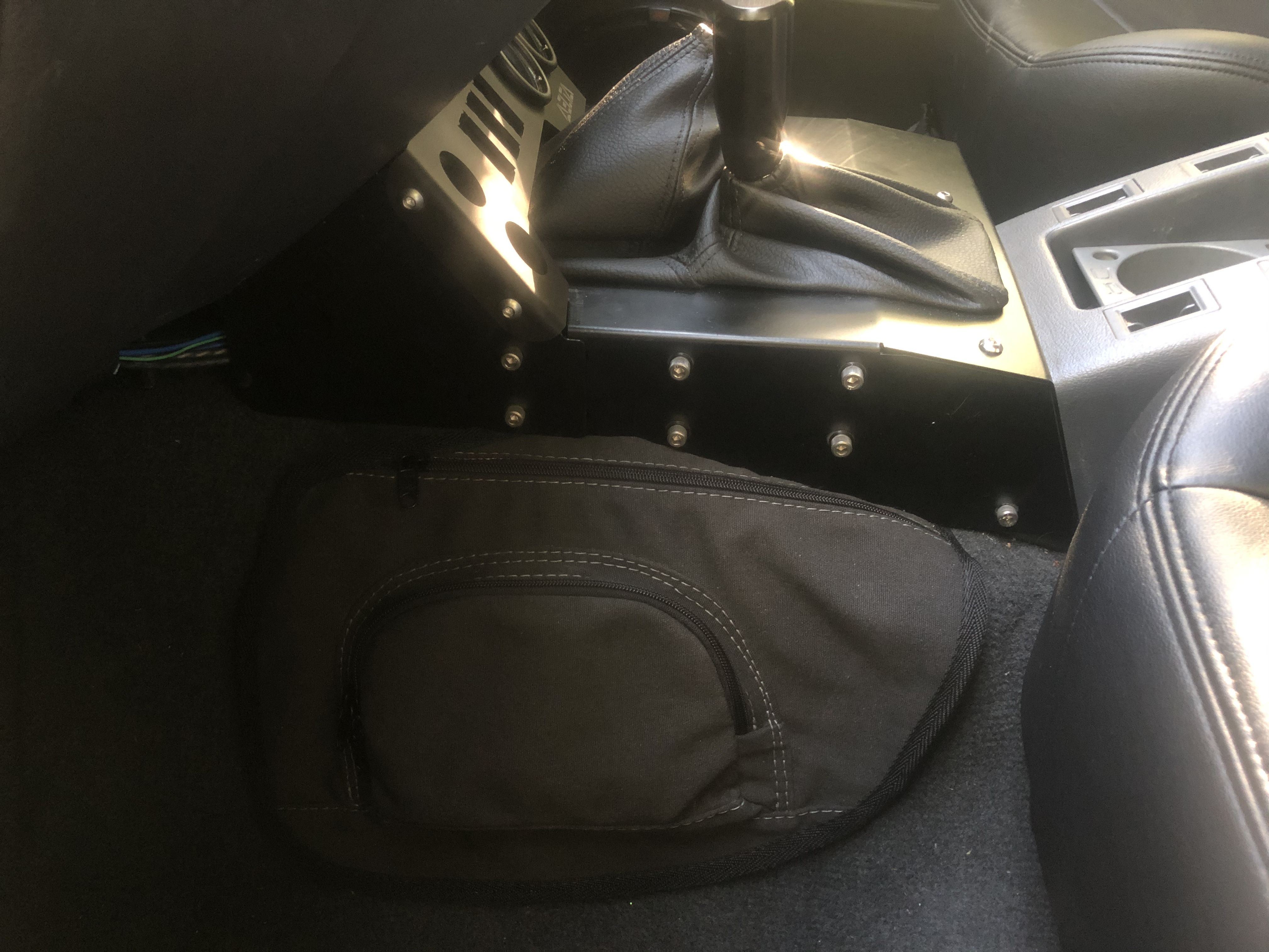

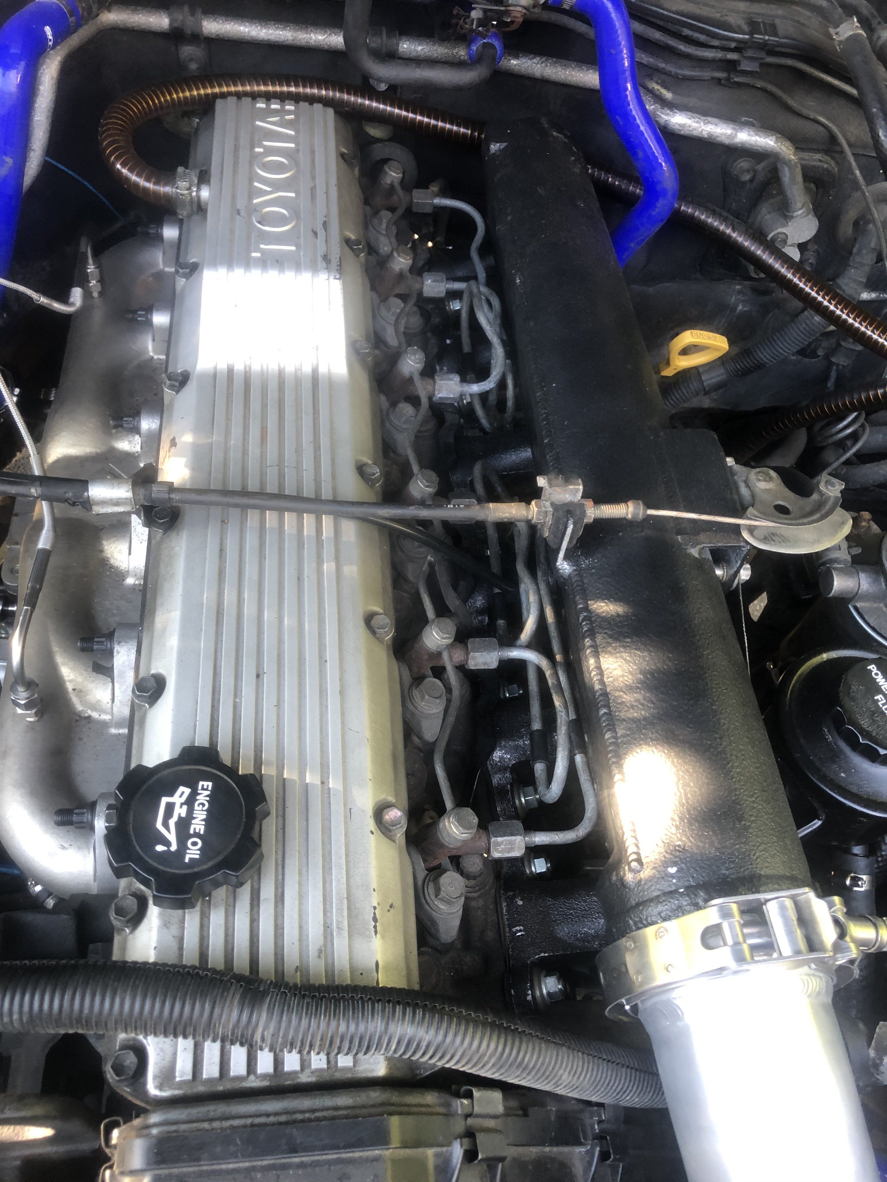

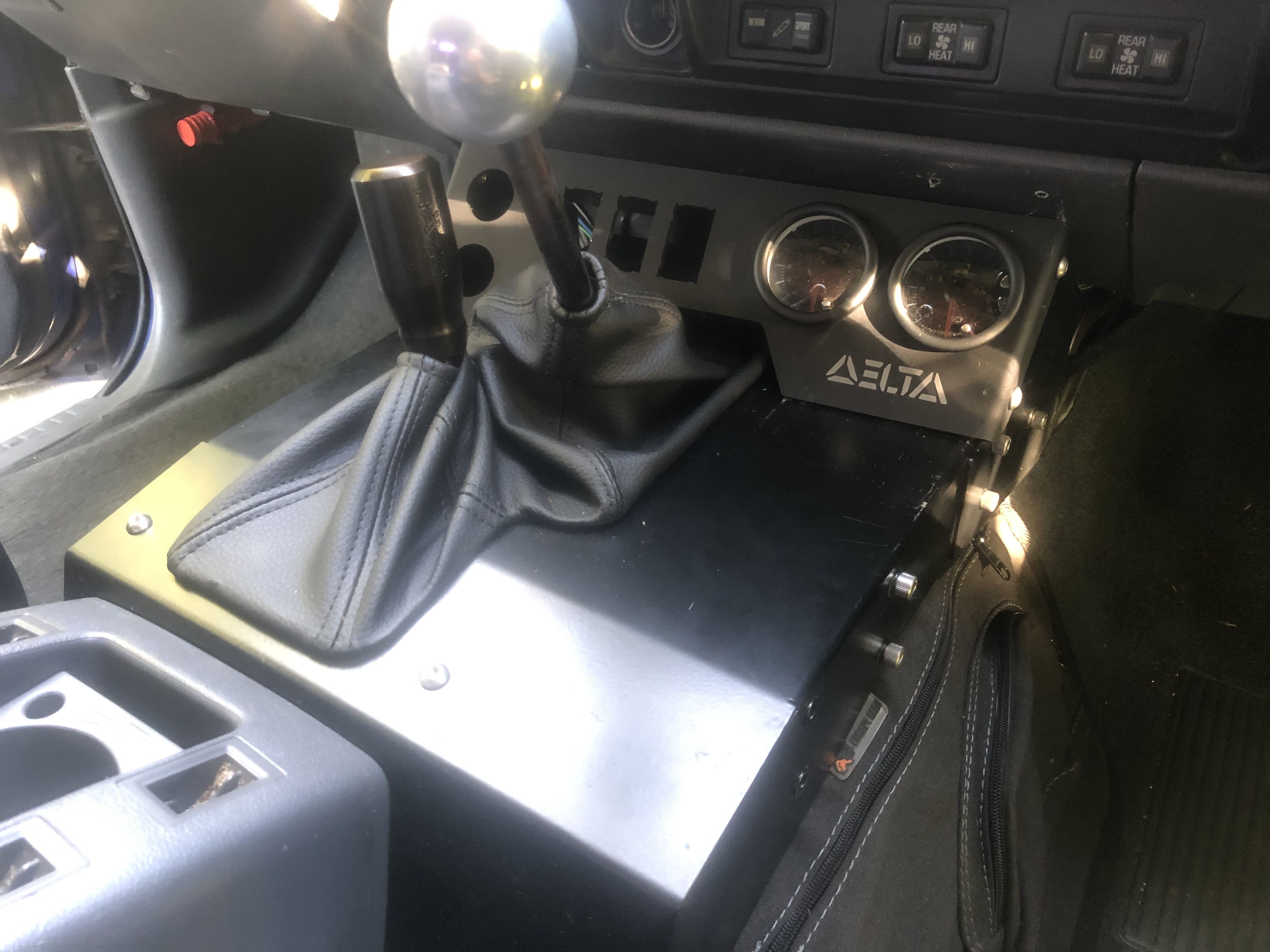

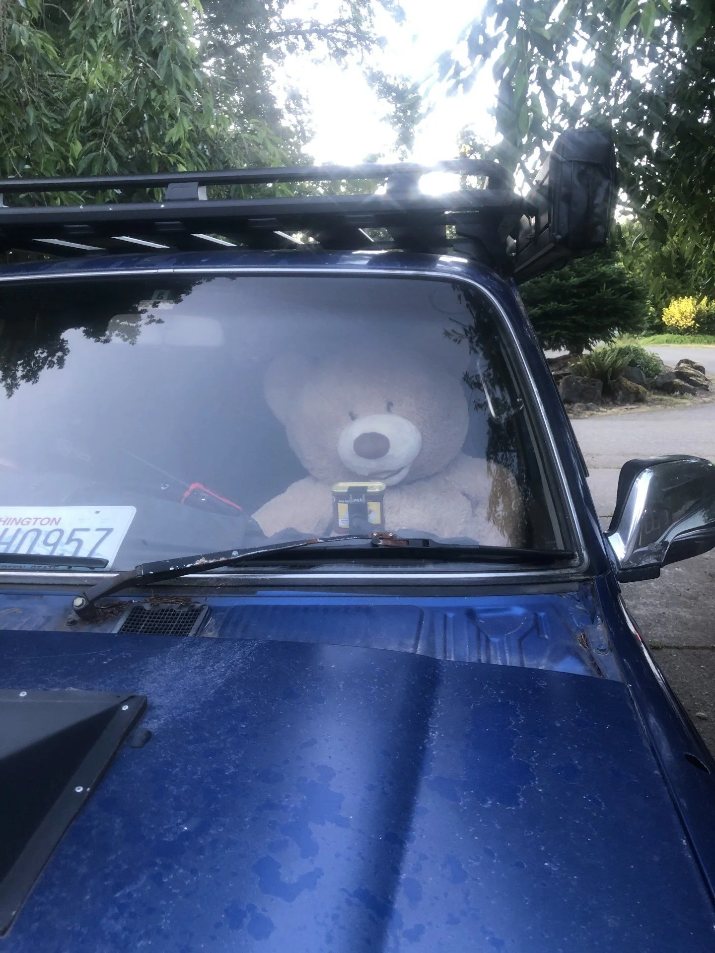

Was a combination of the last few weeks, but new seats, new carpet, Delta prototype RHD manual shifter cover, made a bracket for a rammount on the dash OSH, made some bigger OSH for the driver and passenger, added some gauges (another EGT, water temp, and AFR) put a new turbo on, made a airbox for a panel filter and a new battery tray.and I added a passenger to mess with people
@ItsBavid they sound decent, not going to satisfy any hifi scrutineers but they sound better than the one blown, one disconnected factory units— and I didn’t have to modify the door card for face mounting.

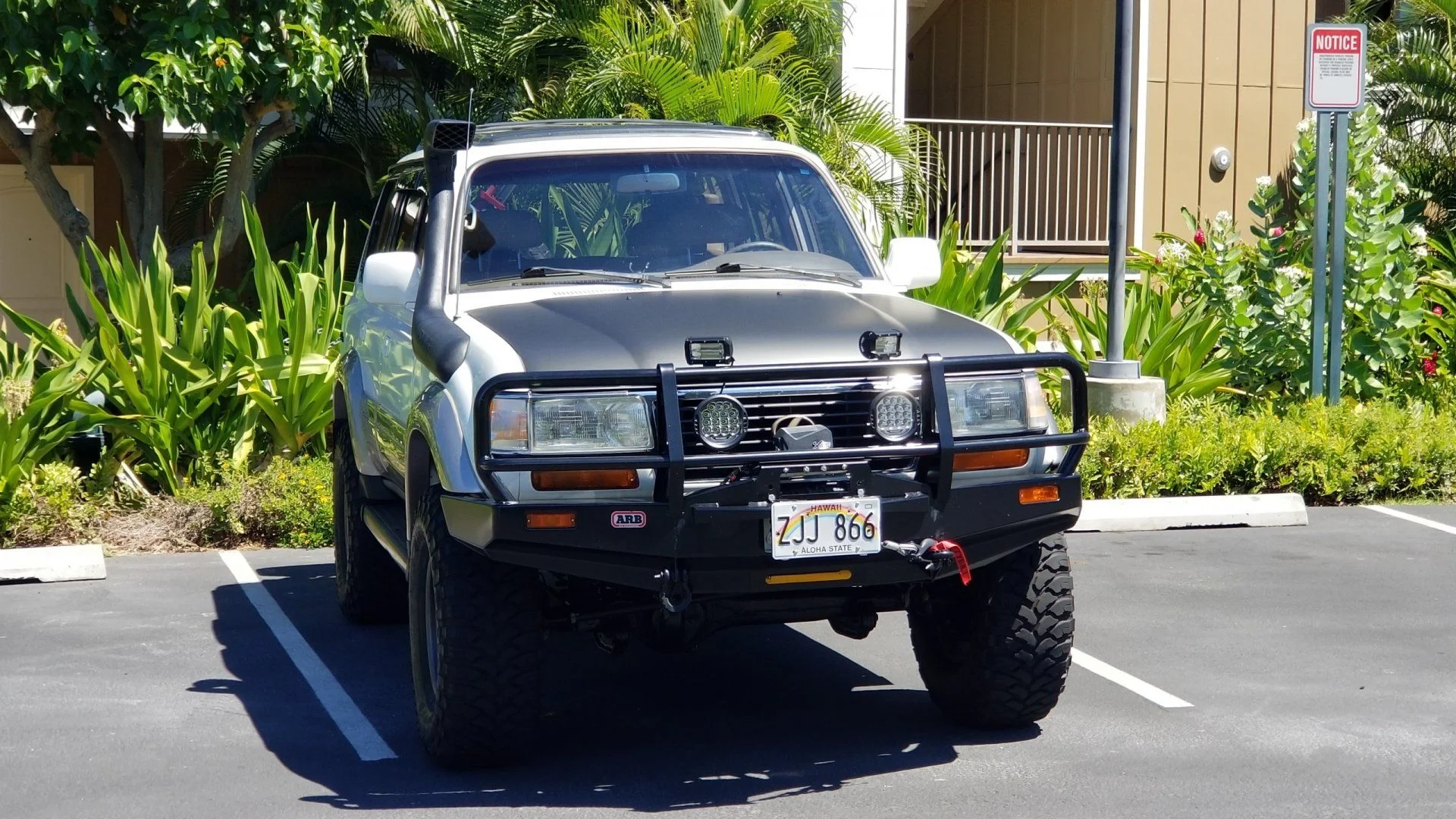

Cut off the lame Mud Flaps! Finally finished base lining, Ironman Snorkel, ARB Diff Breathers, Smittybilt Winch with custom SS bracket for the winch control, Black hood wrap, Alpine deck and all new speakers, lots of Wit's End goodies (Thanks Joey) added Delta Storage brackets for a storage Tray in the back (Now i have a grab handle for the Dirver's side :bounce:. waiting for my GOBI Ladder (Ordered in January) should be here in the next couple weeks :bang:. Hopefully the Uptop Overland rack ships Monday. Now if I could only stop working so much I can wheel the Beast. Only been able to use it for work to drive to job sites. Not that I am complaining, as the money funds my Cruiser Addiction but 3-days off in the last 42 days is getting old. Got more stuff to do but no time to do it. Just got the Lutz speedo adjustment, but too many Honey-dos to crawl under and install. :( oh and the Metal Tech sliders are on top of my paddle boards gathering dust, as I have no time to weld them up and still need to powder coat them.

I added thin foam liners to mine to hold the tools down as I got tired of all the racket. Works great, quiets it right down. I still hear noise from my tools bouncing but it is much more muffled now.
