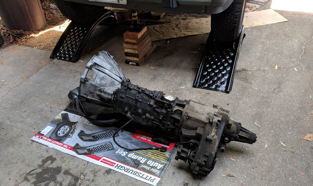

Spent 4 days pulling/reinstalling the gearbox/xfer case out of our jeep to replace a leaking slave cylinder. Having only worked on patrols/cruisers/landrovers I had never seen an internal slave cylinder (what a deranged concept). At least a new pressure plate/clutch plate (may as well replace if pulling the boxes) and thrust/slave combo was only $150 delivered.
Younger son (summer holidays back from college) pitched in to help and learned a lot of tricks on how to do such a job. We built an adapter (have plasma cutter and welder) to sit on our floor jack to support the entire transmission. Made life a lot easier when we had to align and mesh the box back onto the flywheel pressure plate/clutch assembly.
I was boggled to see how tiny the fasteners are that hold the saddles over the prop shafts ujoints. M5 size (8mm head)- really??!? The other brilliant piece of engineering design is the mix of 10/11/12/13/14/15mm size bolts and of course Jeep has to throw in some star heads (female torx) just for fun. e.g. the starter motor has 2 sized bolt heads to retain it. Dear god, madness... Glad our Jeep is basically a city vehicle, can't begin to imagine it out bush and needing some repair - would need a snap-on truck in tow :)
Bell housing cleaned up so we could see and remove the thrust/slave combo on the gearbox shaft. Cleaned up the rest before reinstalling so not having to deal with decades of oil/grease residue.

I discovered the same thing working on the jeep I owned for about a year before I gave up. While swapping in a replacement engine (amongst many, many repairs in less than a year), I was amazed and angered at how many times I had to go to the tool box for different sized wrenches. I decided at that point that there was no way I was going to keep that thing!
