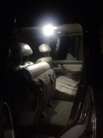

Installed PFRAN's LED kit - doors and backup lights only since the six Crown and Coke's made doing the overhead lights feel impossible. Should've finished in the morning but took my kids 'exploring' instead.

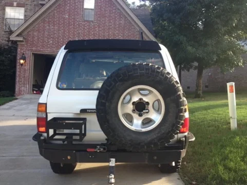

Those are pretty sweet. I like the kick out. Thought they were Hefty at first, but doesn't look like it. Homemade?
Homemade. Apparently Cody C made them! ( I am the second owner of these after a local 80 owner bought an IPOR. They are bolted to the frame, rear crossmember, and also to the section where the exhaust resonator (was). They are incredibly stout.
Previous owner (Tim) carried around his spare 38" Toyo on it:

Pfrans installed inside. Wow super bright!
