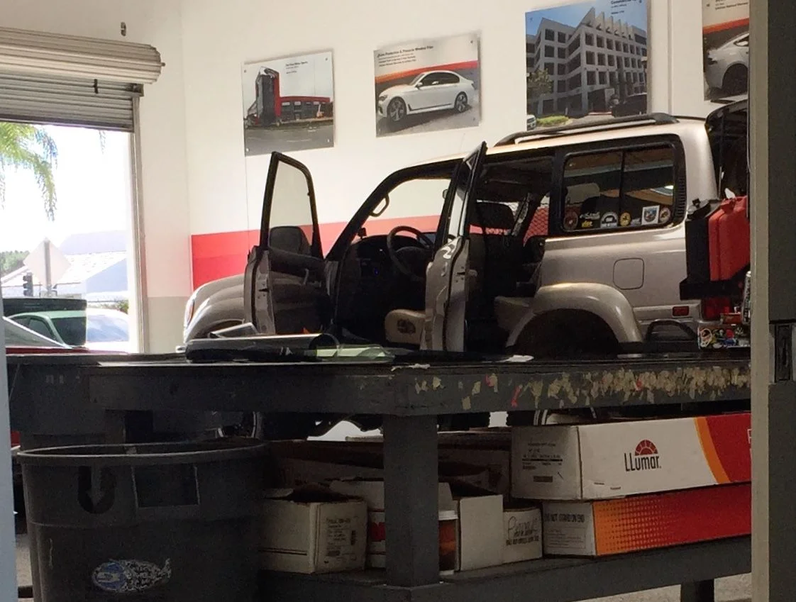

Preparing for another 5 day trip next week to Anza-Borrego. Getting the windows tinted to reduce the in-cabin temps.

I did a UV filter layer on the windshield when I did mine. I'm have very fair skin so need all the UV protection I can get.

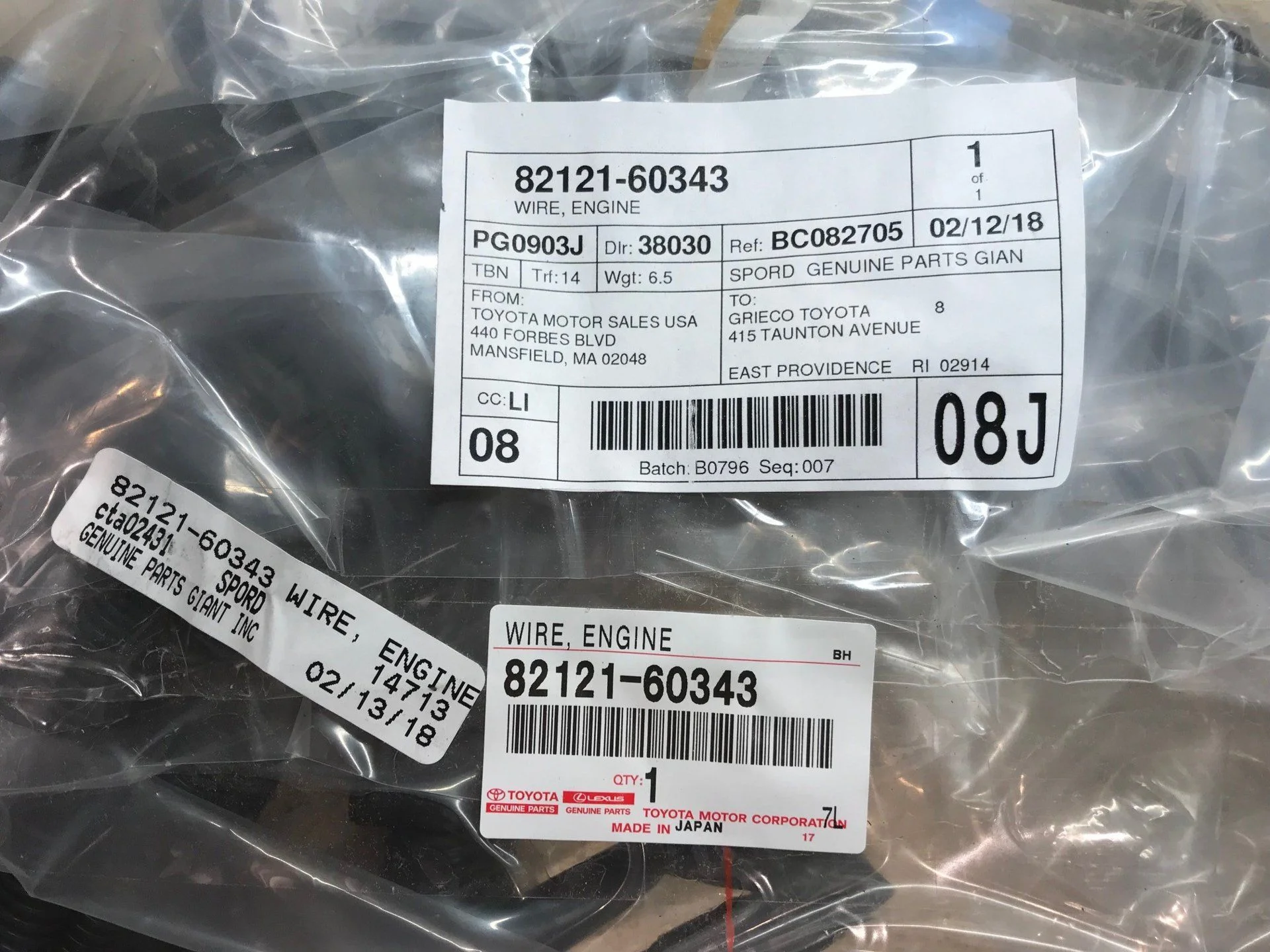

Sold some stuff on Craigslist last weekend that was just taking up space in my garage, and exchanged the profits for a new main engine wire harness. I don't need it yet, but when I eventually rebuild my engine it will be nice to start with all new connectors.
$450ish from several online vendors (just search the part #) and I certainly couldn't build it from scratch for anywhere close to that price. It'll just sit on the shelf for now :).

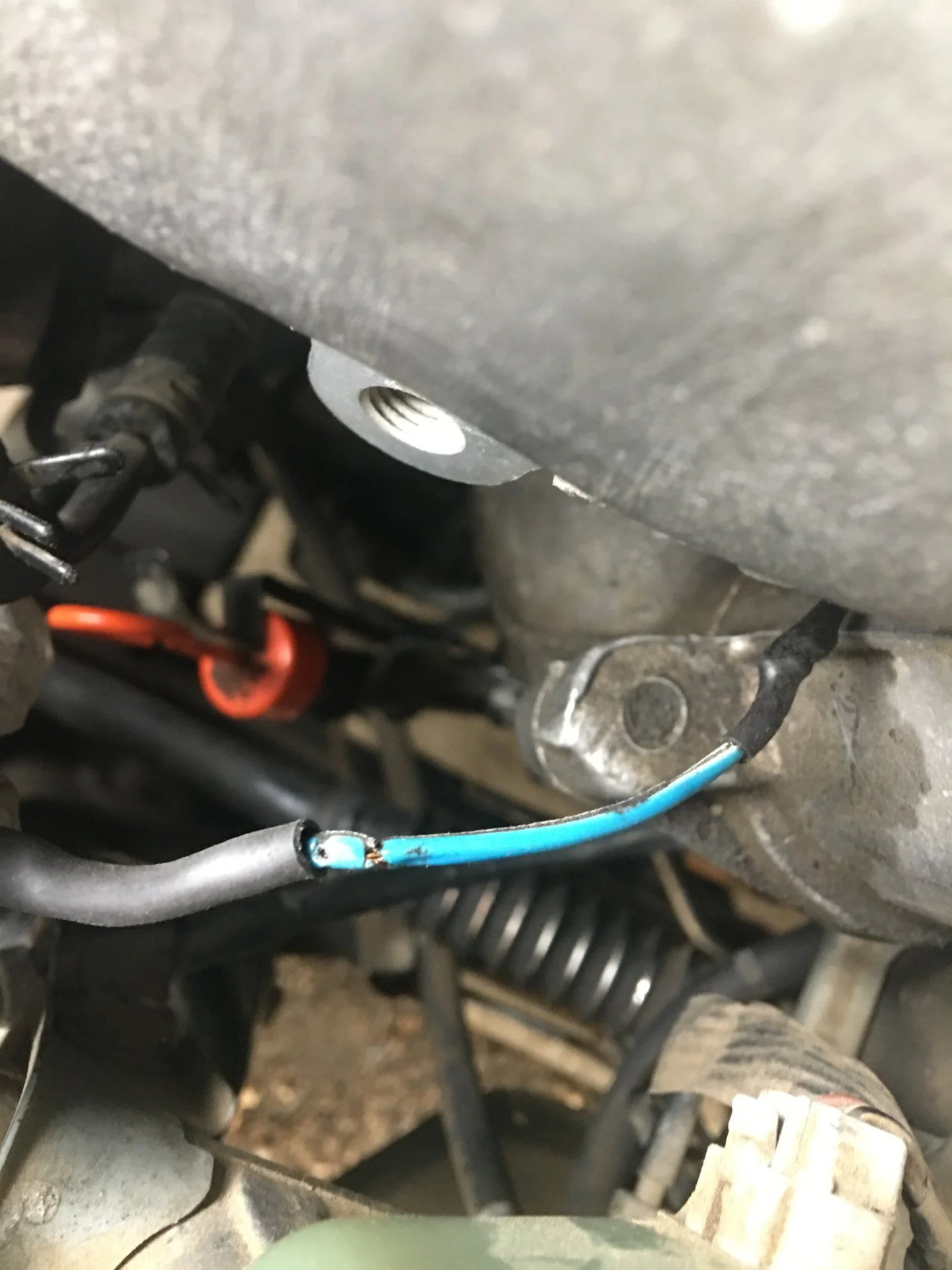

It was a balmy 29°f here in The Ohio so picked up on my quest to sort out a code 52. I think I found the culprit:
Clearly I did a sh’t job on the wiring last time I was in there. And also explains (hopefully) why my code 52 came back two weeks later.
Changing this wire ranks up there with the PHH and perhaps I was too busy cursing that I glossed over this part of the wire. Anyhow I opened up my harness a little to lengthen the visible area, found the above, then cleaned it and dialectric greased it and finally put a little more heat shrink. Fingers crossed this works.

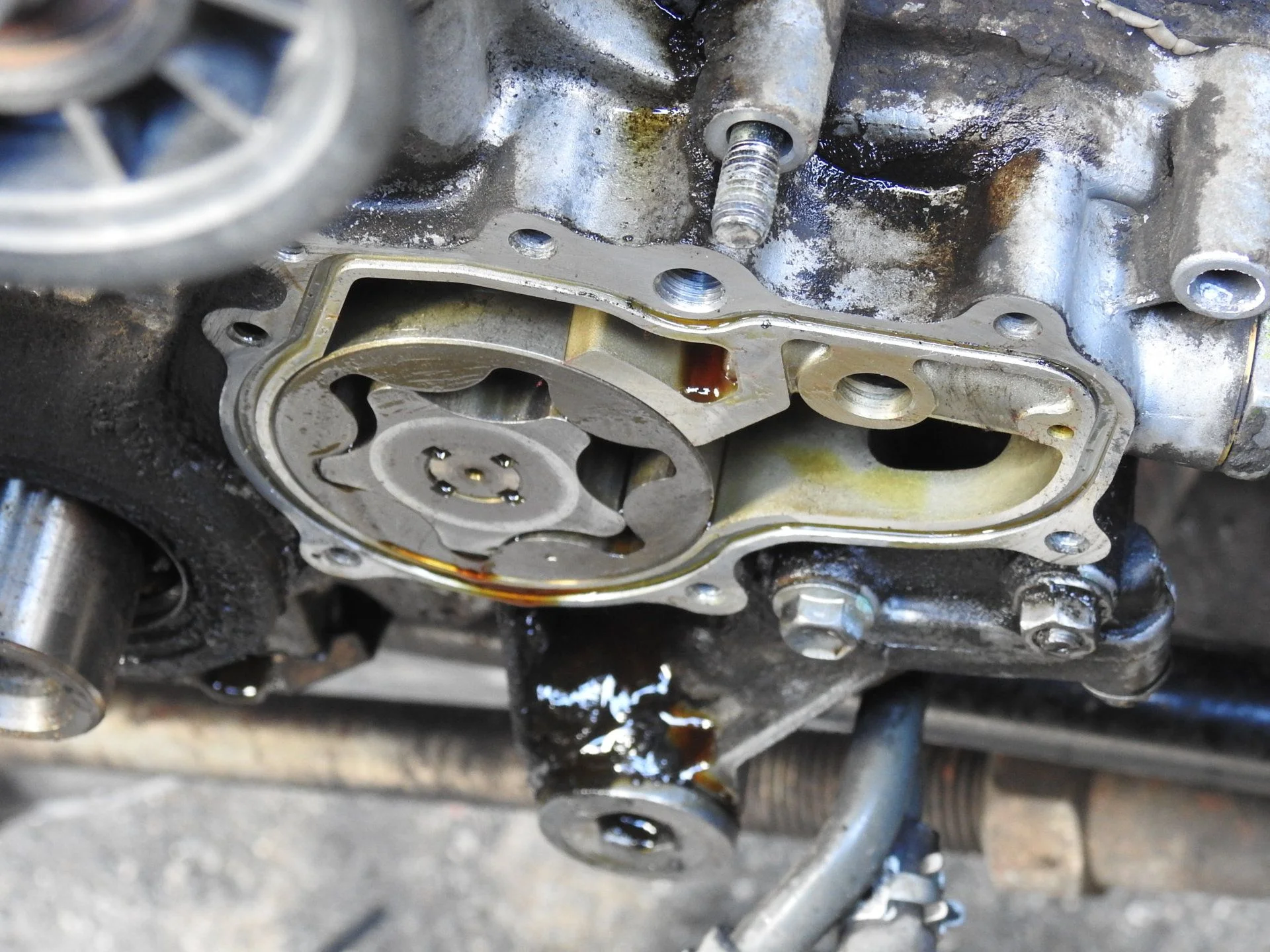

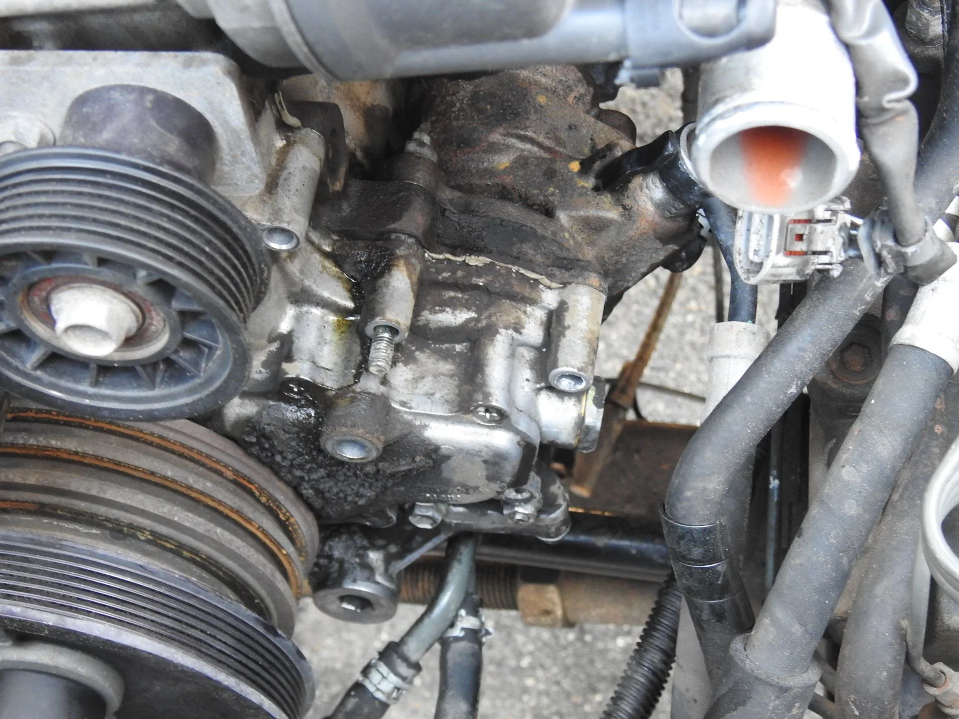

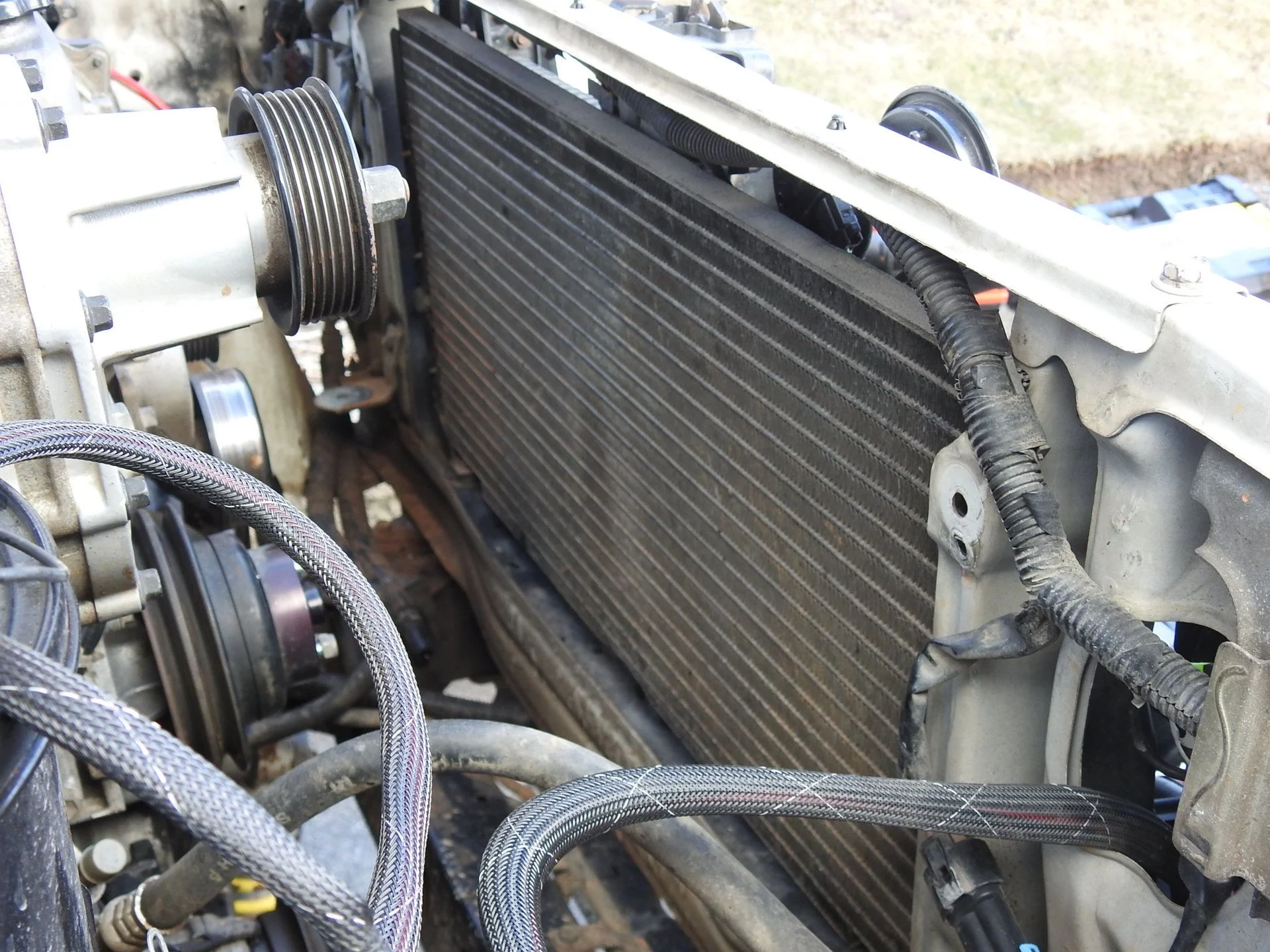

So the weekend isnt over yet, but I pulled both batteries then the shroud and the radiator and then the harmonic balancer and the oil pump oring long stry short I did my crank seal, my oil pump oring my dizzie oring installed new belts,new OEM hoses new OEM radiator and a new to me charcoal can, and Im going to rear mount an odessey extreme 31 series in the rear, the 2 extremes I have now are a total of 140AH with my starter and the 31 Ill have 168AH to burn. So theres that. oh AND I installed the sequoia 150AMP reman alternator with photomans pulley and bracket sweet.

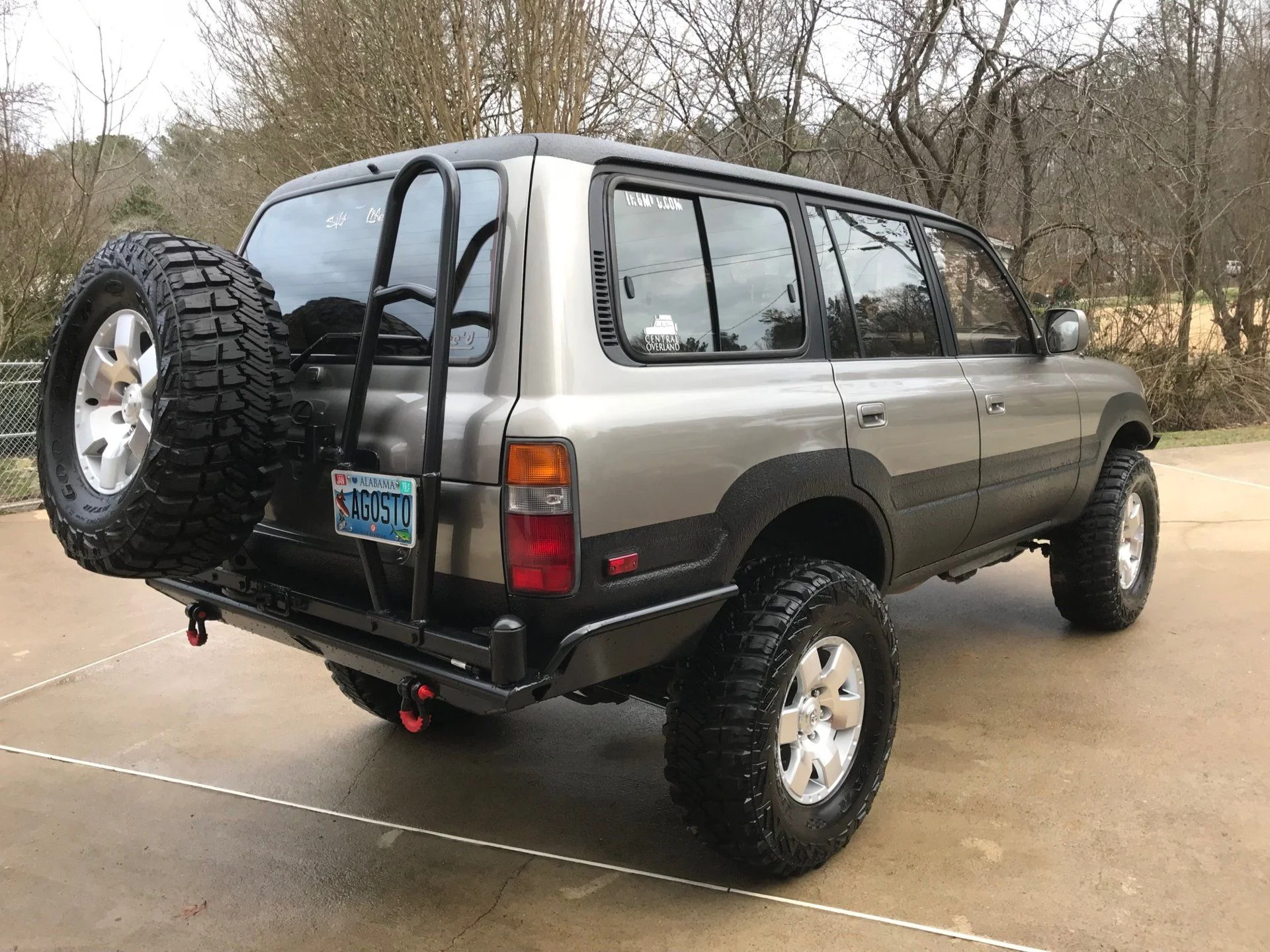

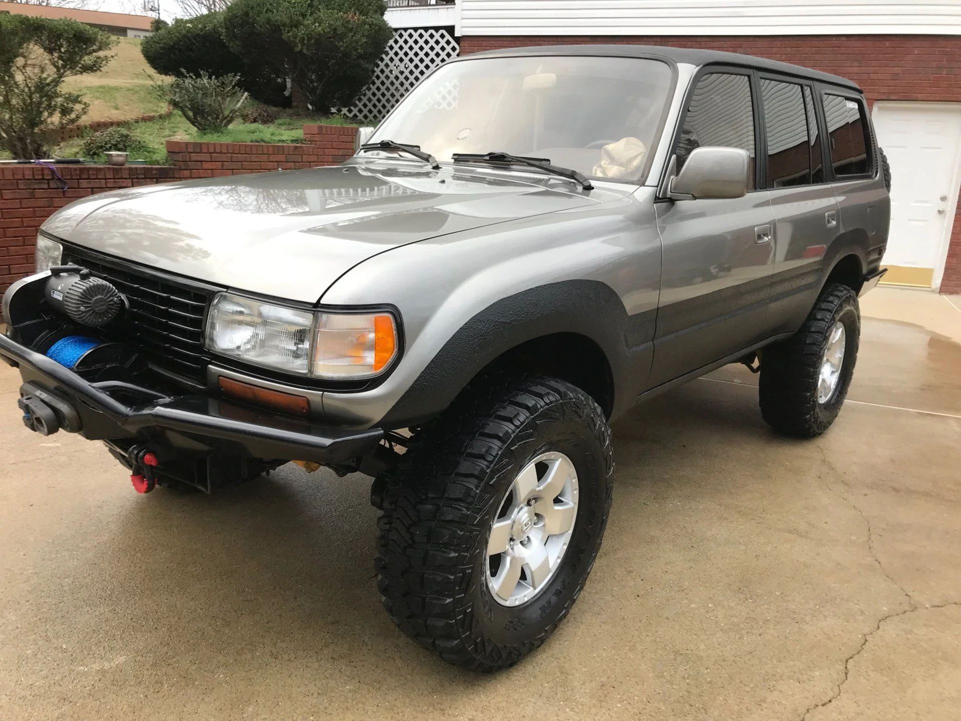

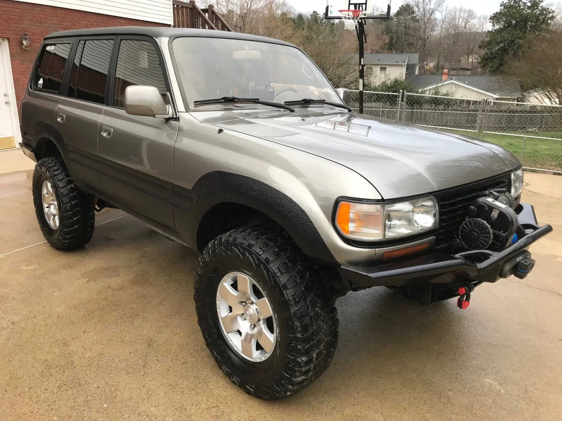

I should say "your 80 looks awesome". I see it's an LX
