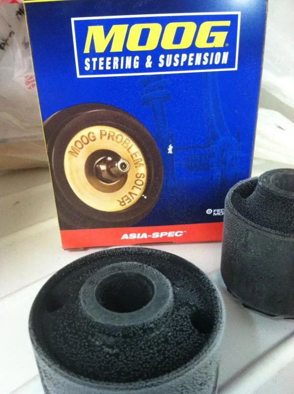

Replaced original 18 year old control arm bushings, and panhard bushings. They were very hard and cracked and very noisey. Amazing the difference in ride quality and noise. The OEM option for the 6 control arm bushings were going to be approx. $200, I ordered the Moog set for $38 a side from Rockauto. They are made in Japan , have Toyota part number on them.... Don't forget the discount code from the vendor section. I think they are the same as OEM, only time will tell if they can last another 240k. Yes they are in the freezer for easier installation. Also remounted my home made "creeper sleeper" inspired skidplate after drilling a drain hole for t-case. Also exterminated the stinkbug with a 1 1/4" homemade spacer for the front.

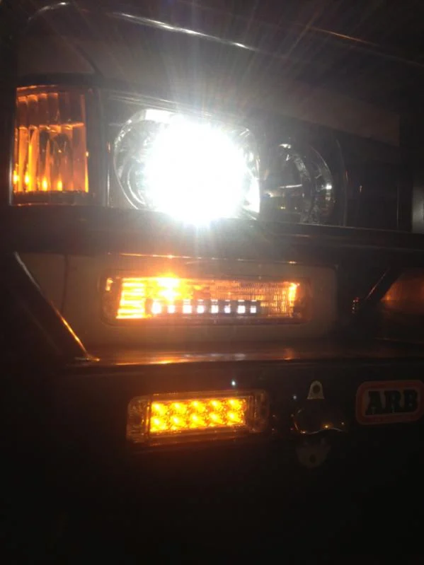

Installed my Slee headlight harness and working on finishing up installation of my LED light bar.
