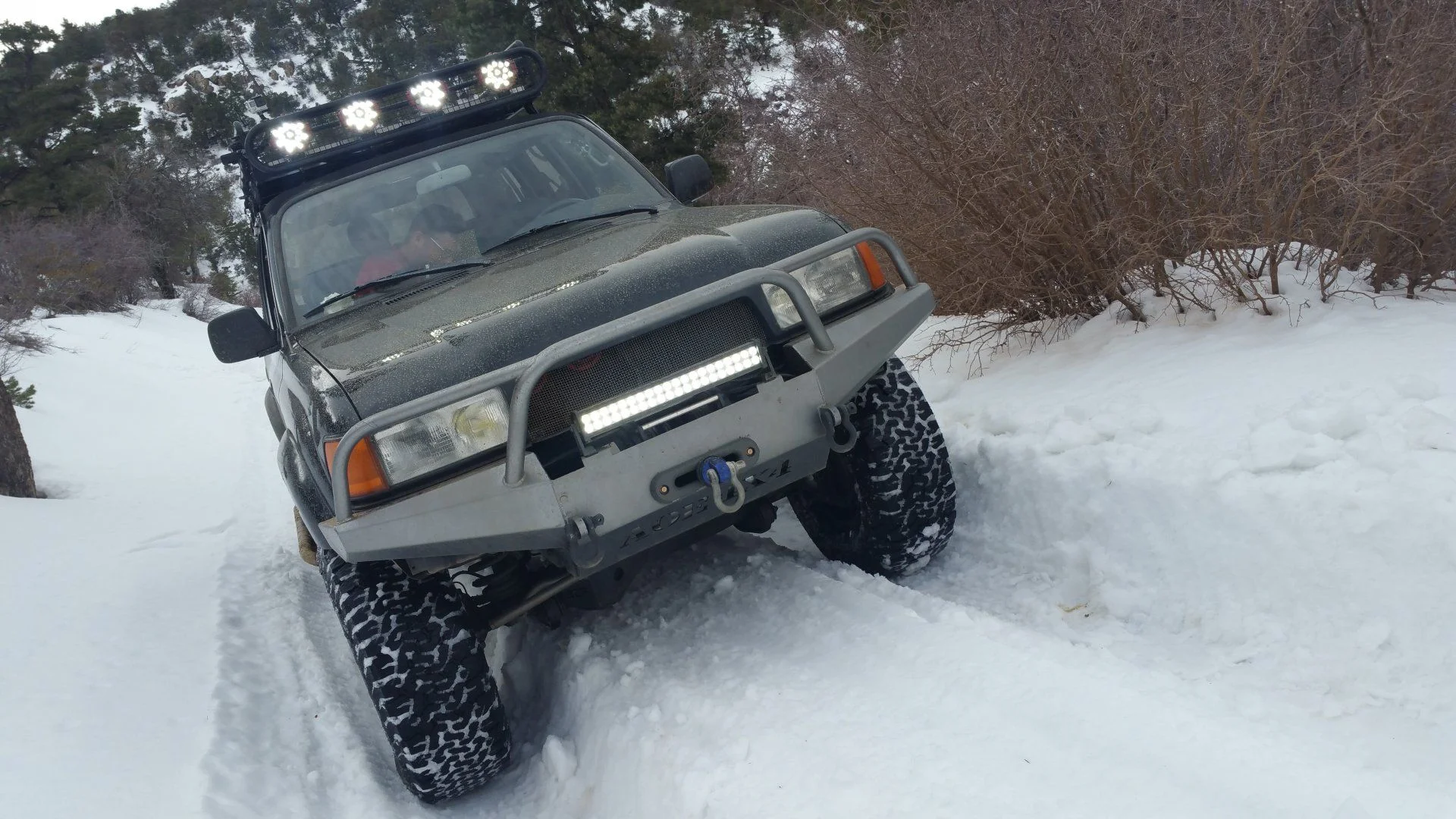

Some wheeling fun in Big Bear this morning.
Came across an old mine with great views of the frozen lake.

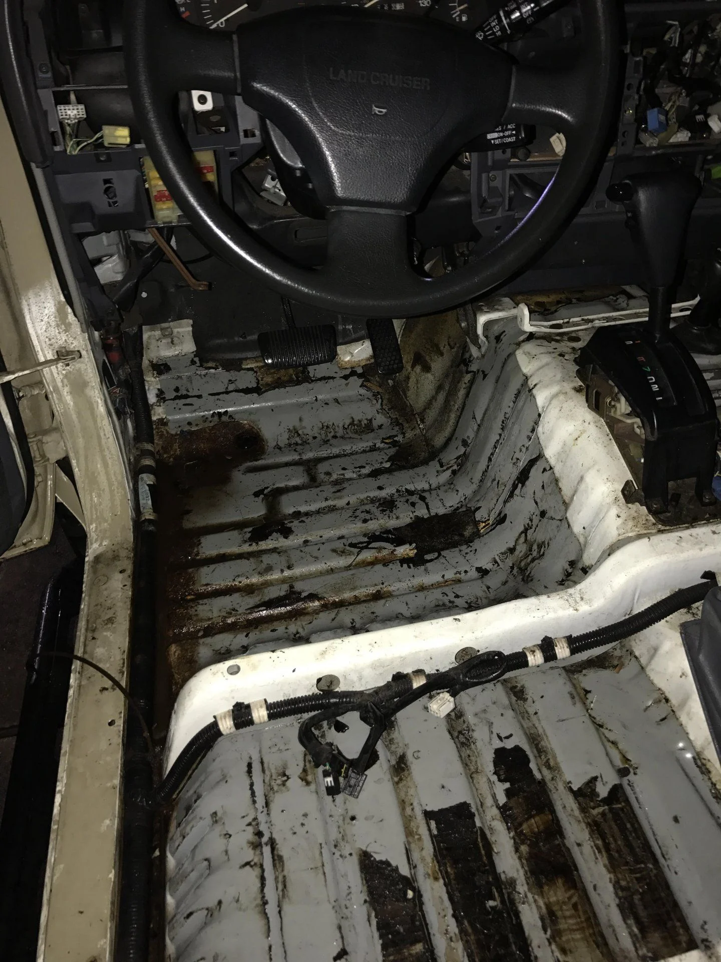

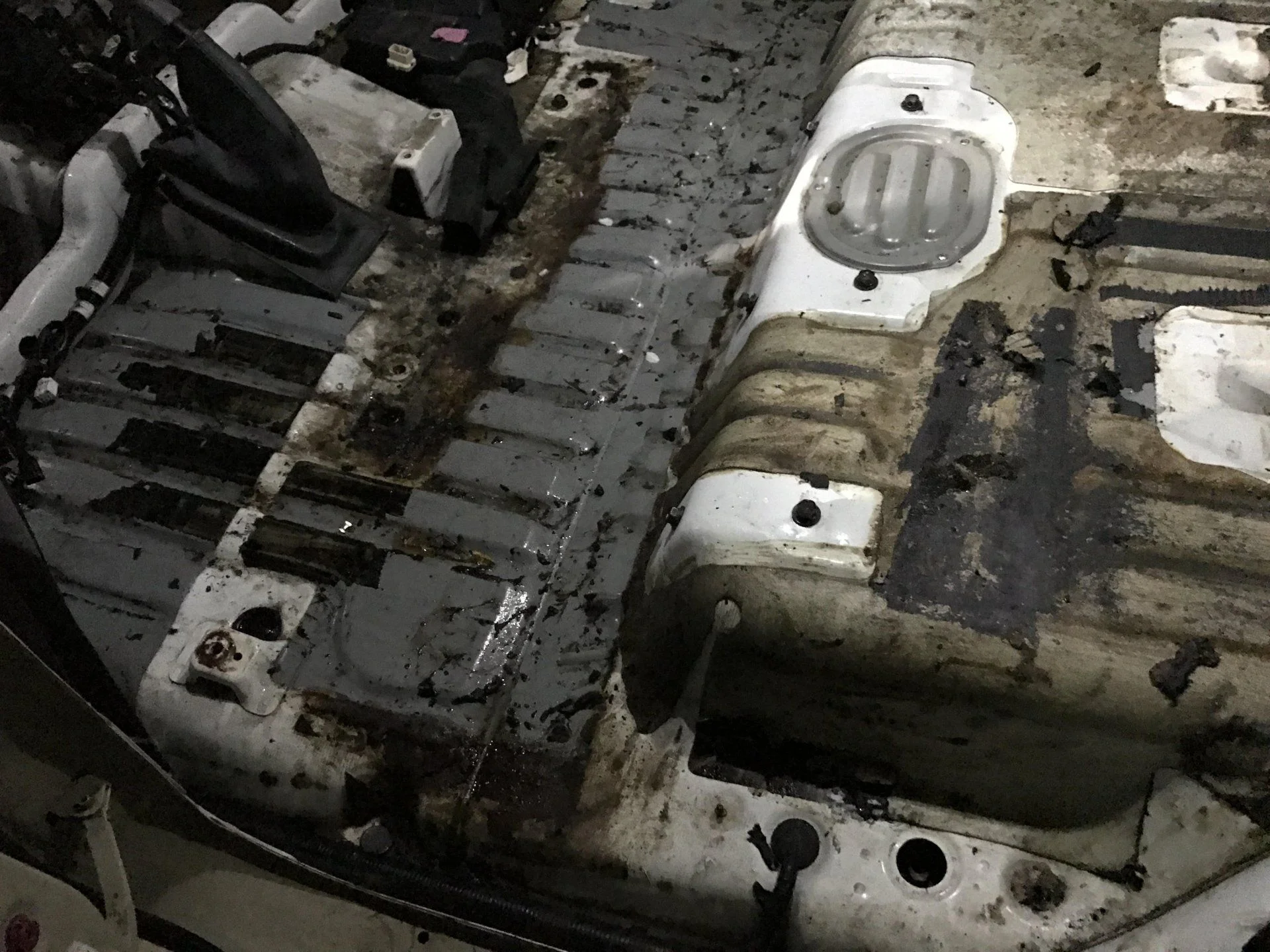

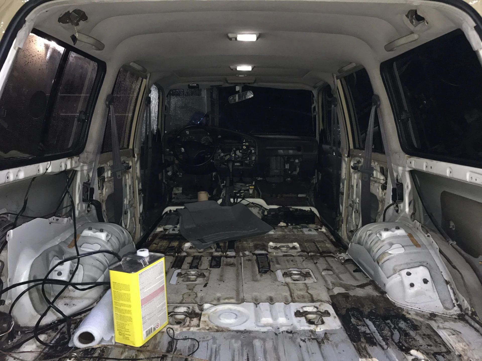

I've been driving my vehicle as a DD for the last 2 weeks. Decided this weekend to dynamat and dynaliner the interior, pulled up all the seats and rugs! Ugh, the more I got into the interior, the more I ended up pulling out more and more stuff! The carpet is gone and I'm gonna have to find me some replacements (vinyl would be nice, any leads?). Aftermarket wiring for electrical mods and add-ons were all pulled, pulled the dash panel, everything. Needless to say it was fun and quite a learning experience!
As for the deadner, I tried the old-fashioned chisel and hammer (you'll see evidence of that below), then degreaser (again more evidence below), and, finally the dry ice with isopropyl technique (YAY!). Dry ice worked like a charm and I was only out about $60 something and some change after my purchase from Publix down the street.
Now time to dry ice the deadener (did some of that tonight), clean it up (looks like I have some sanding ahead of me since I found some rust spots), dynamat, then dynoliner, think out electrical accessories and connections (dual battery installed but needs to be connected to 7622 blue sea and fuse block). Will be doing headliner in dynamat and dynaliner too! Gotta figure out how to clean the dash panel area and will be adding LEDs to the instrument cluster panel this coming weekend.
Props to all those who posted info on dynamats and blue sea installs, I've been doing my homework and will post some more pics perhaps on my own thread!!! Looks like I'll be driving another vehicle for about a week before I get to work on this again, can't wait!

@PIPA nice work. For vinyl check out Jason at Trail Tailor. @reevesci on here.
Hey @jfz80 thanks for the recommendation! I messaged him a few days ago, he just recently got back to me and we are go, but it will be a few until the next order goes out. No rush, it looks like I got a ways to go with removing the old stuff and putting the new stuff in. Meanwhile, I'll just use the old carpet and refurb it (plus removing the old carpet pad that has grown onto it) as a substitute! It's good to hear from members of the community on here vouching for one another, looking forward to working with @reevesci
