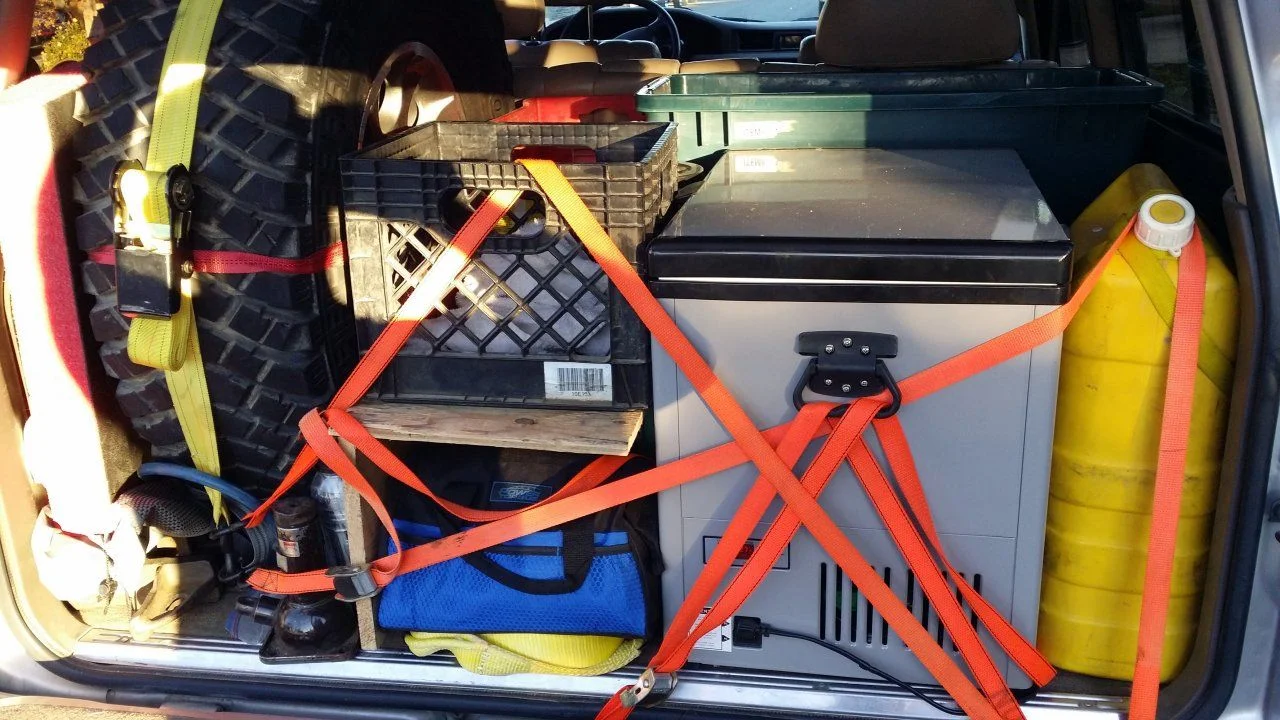

Just a while back got the dual battery & fridge in... now feeling real cramped for cargo space in the back. I seriously need to get the tire & water outside.

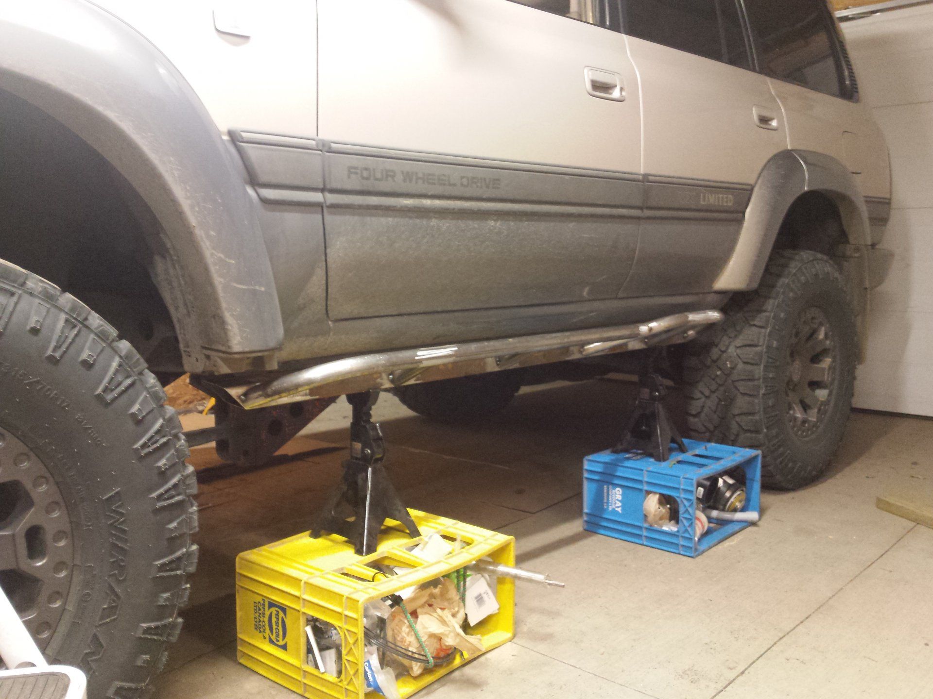

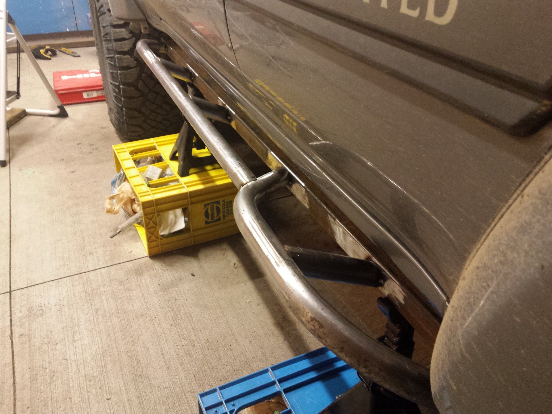

Got started on these, and only got the passenger side mocked up. Not going to be finished anytime soon, think I'm gonna remove the cat before getting the driver's side mounted and brackets built.
full
full
Also discovered a clever way to use bungee cords to keep my random junk in beverage crates while I turn them sideways so that I didn't need to find a new home for said junk.

You have a cat on your HDJ81? Must have been something they added to the 1HD-FT's, as I've never seen a 1HD-T that had factory cats. If you're doing exhaust work, 3" turbo-back run inside the frame rail leaves lots of room for slider mounting on the driver's side!

At least I figure that thing right after the dump pipe is a cat, and not some sort of pre-muffler mini-muffler. Either way, it's getting removed. Could be that the HDFTs have a catalytic converter to go along with it's EGR system, because I don't think any of the HDTs had EGR either, correct?
I picked up some 3" mandrel bent stuff already to do it. The section from the turbo to cat is still original, but everything after that was replaced with 3" already over in the land of the rising sun.

Ya, that's likely what it is then. A 3" dump pipe and cat removal should wake that thing up, and drop your EGT's a bit!

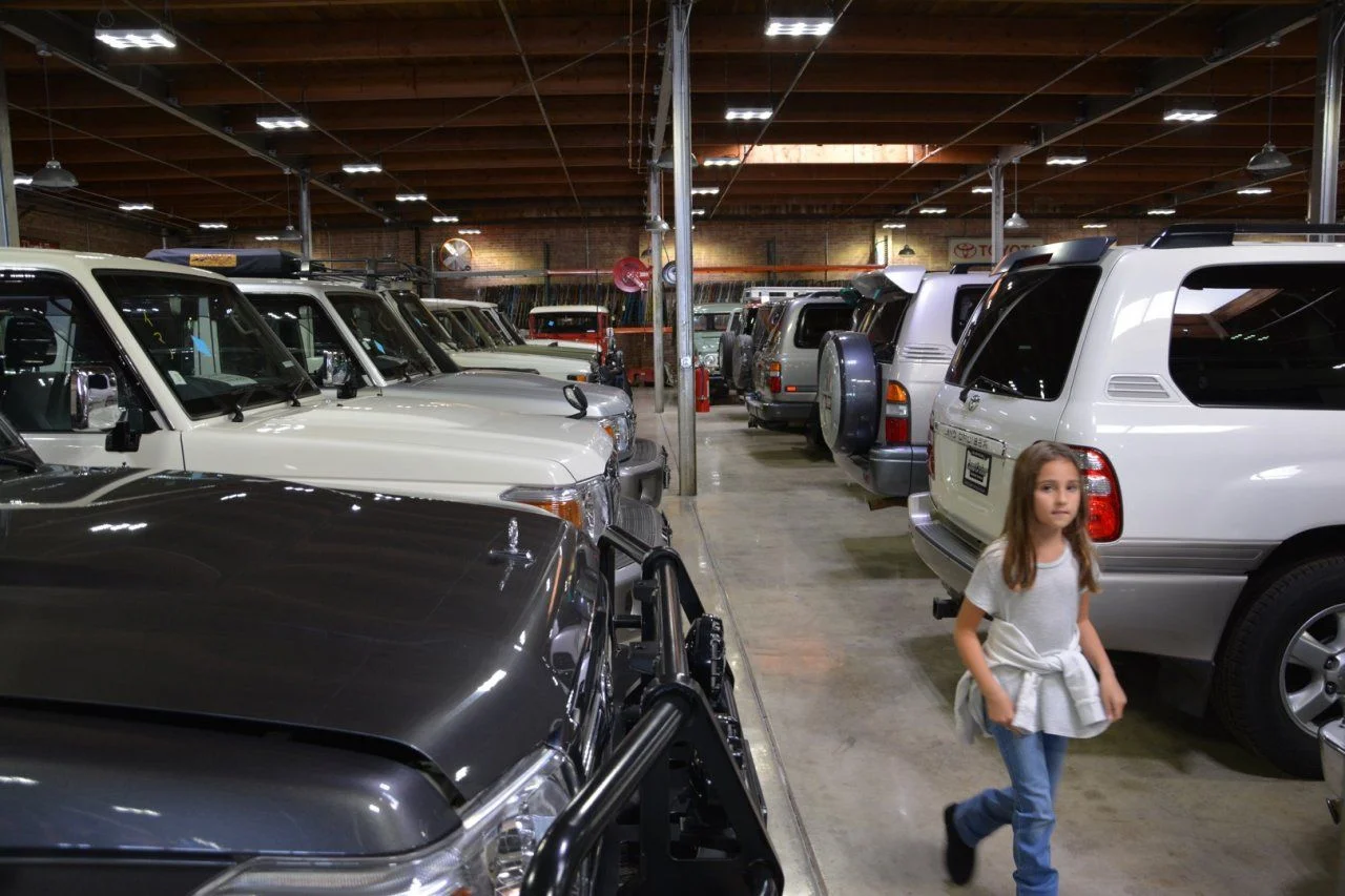

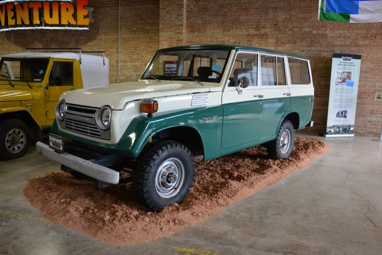

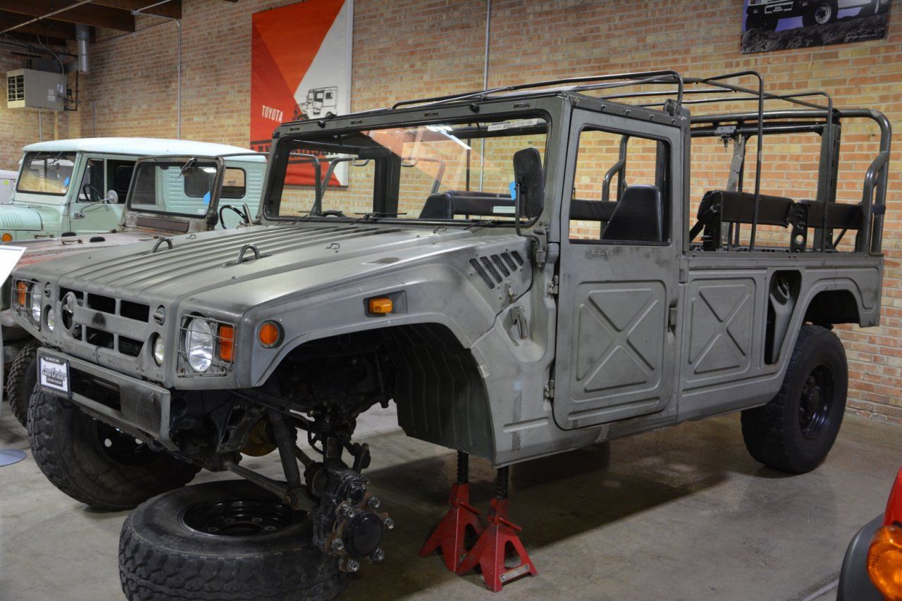

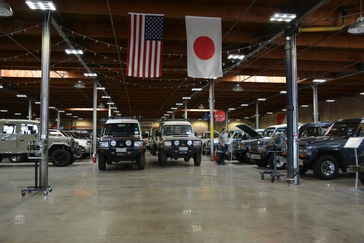

Not the weekend, but over the holiday week while visiting the in-laws in Utah, I got a chance to visit the Land Cruiser Heritage Museum in SLC.
@cruiserdan was an incredibly gracious host/tour guide and really knows his stuff, obviously.
The amount of unicorn Land Cruisers here is almost overwhelming and I could have spent the entire day drooling and looking over the entire collection. The 30th anniversary 70 series cruisers were my favorite and made me extremely jealous that almost everyone in the world gets the 70's except us.
If you're ever in SLC, I cannot recommend the museum enough!
View attachment 1358583 View attachment 1358584 View attachment 1358585 View attachment 1358586 View attachment 1358587
The family and I will be driving through SLC next year on our way to Redding, CA. We have set an afternoon aside to stop at the museum.
