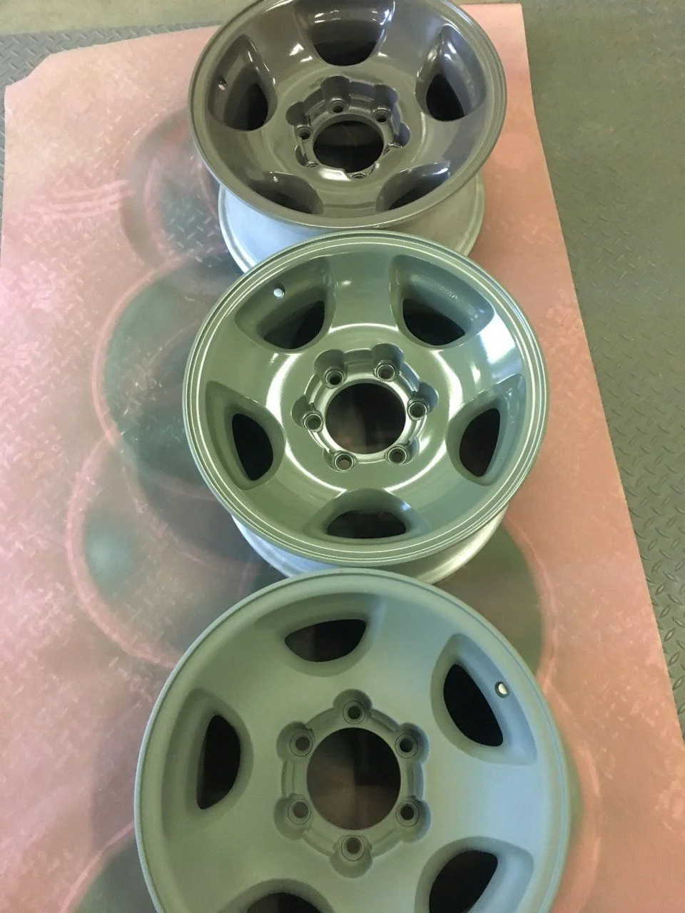

I like the browner one in the back, would look great with a white rig?
I think the lighter color might go well with a white body. I know i'm not a fan of blacked out rims on 80s, nor chrome!

I'm with @TexasJack on this. The darker browner rims.

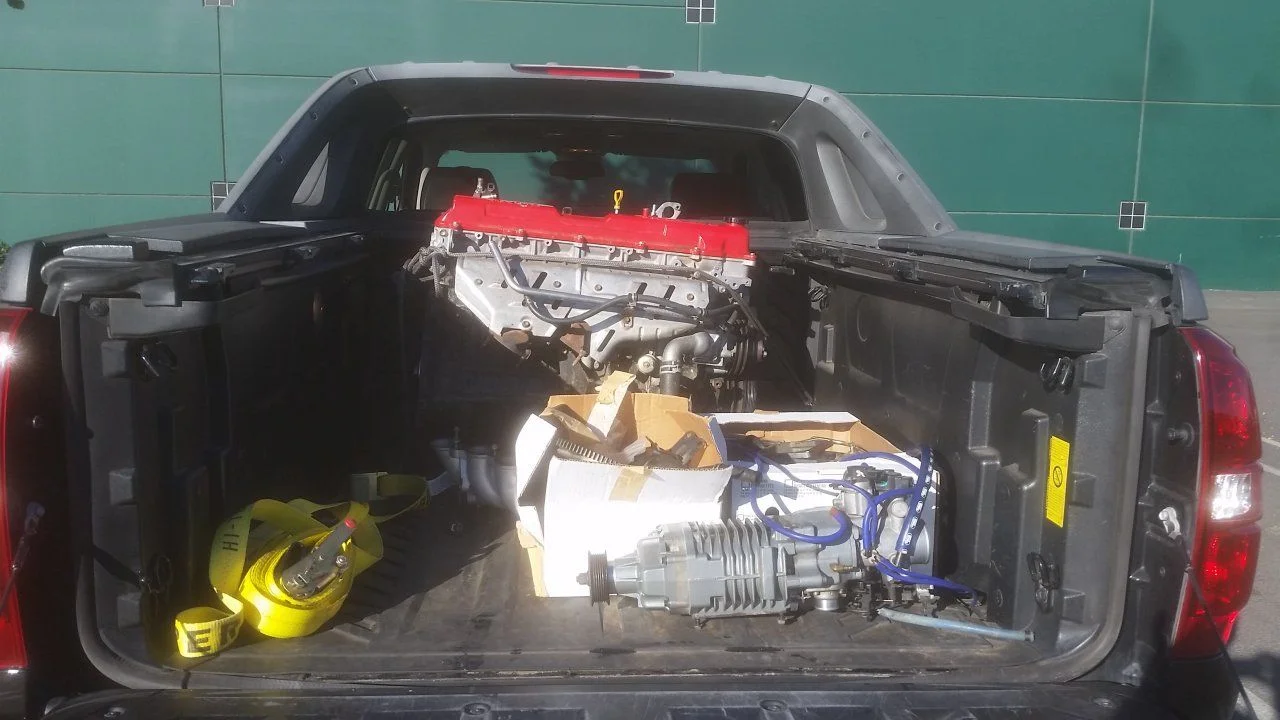

Get a SuperCharger. Don't have to touch the TB :flipoff2:
You SC guys are on the struggle bus WAY too often (and, er, at length) for me to go there. :flipoff2:
