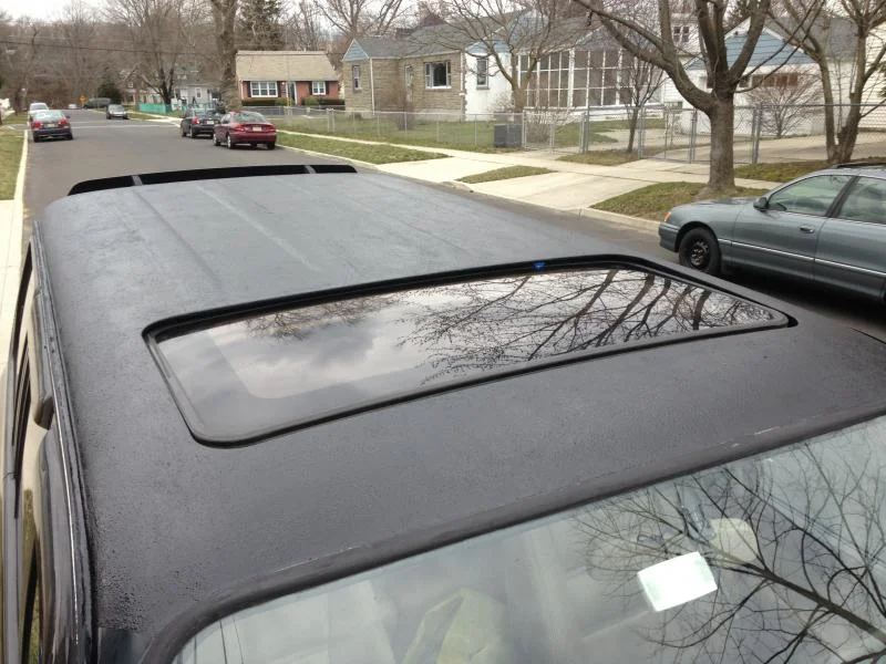

Hurculined the roof today. Put it off for a while but got to it today finally!

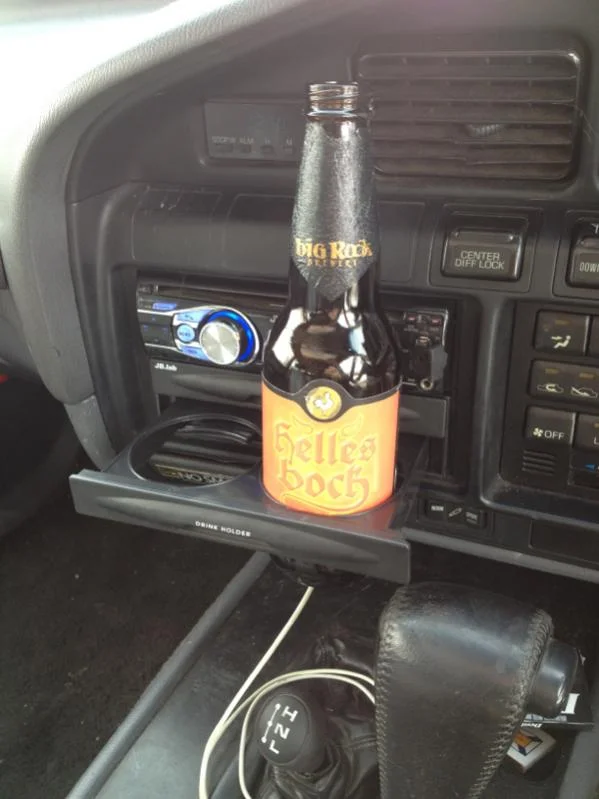

Where did you get the cupholder for that mod I pulled one from a 90's taurus but I have a 97 so the dash gets in the way.

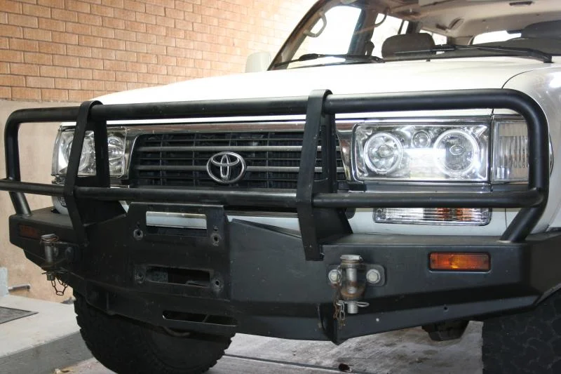

Installed depo clear lenses and hooked up my halos while I was in there.
Nice rig.. What are those tow points... Where did you source them and how are they secured..
Thanks Stu
