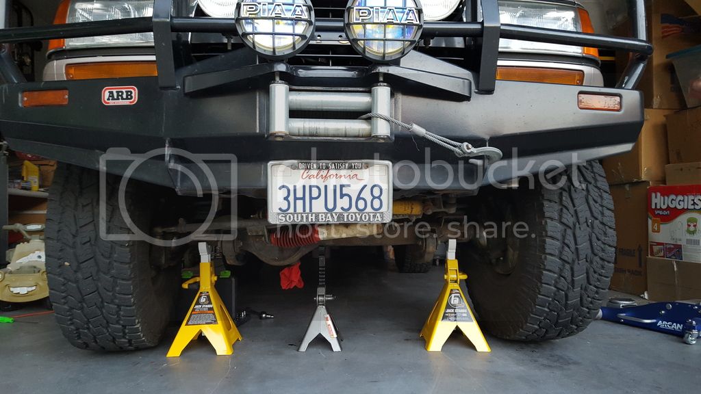

2 ton stands on the front end of an 80 is incredibly scary! You don't need 12 ton stands, a good set of 6 ton is plenty. Look at the difference between my 3 ton redundant HF stand in the center of the axle and the yellow 6 tons on the end. Also...I do like my performance tool 6 tons Amazon.com: Performance Tool W41023 6 Ton Heavy Duty Jack Stand set: Automotive

I was thinking about the 12 Ton ones mainly due to their minim height being so... high.
Look at the min height on the pic I embeded...it's only 2 or 3 teeth engaged...pefect to lift an 80 with 35s.
