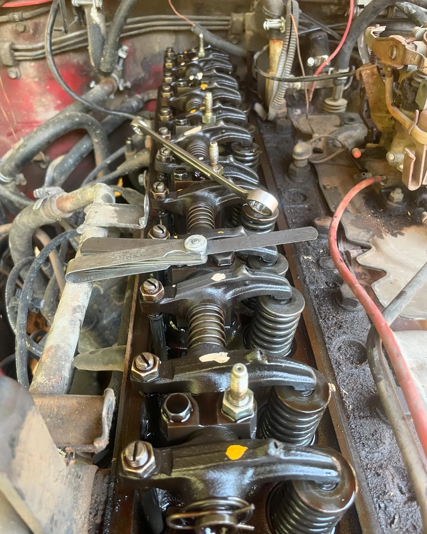

Valve adjustment

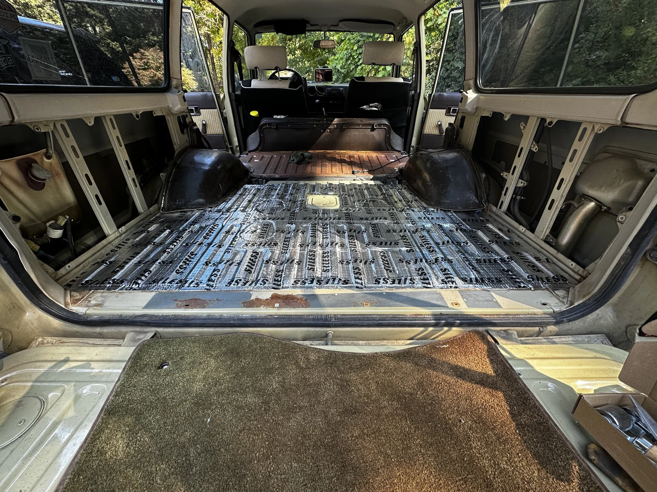

Got the rear cargo area sound proofing laid out, along with a good dry fit of he cargo area rug, kit courtesy of @dnp . I also installed a wireless winch controller from Warn. I love this setup as I use my winch around the property to drag trees etc so not being tethered to the truck is great. This rug, really ties the cargo area together😀

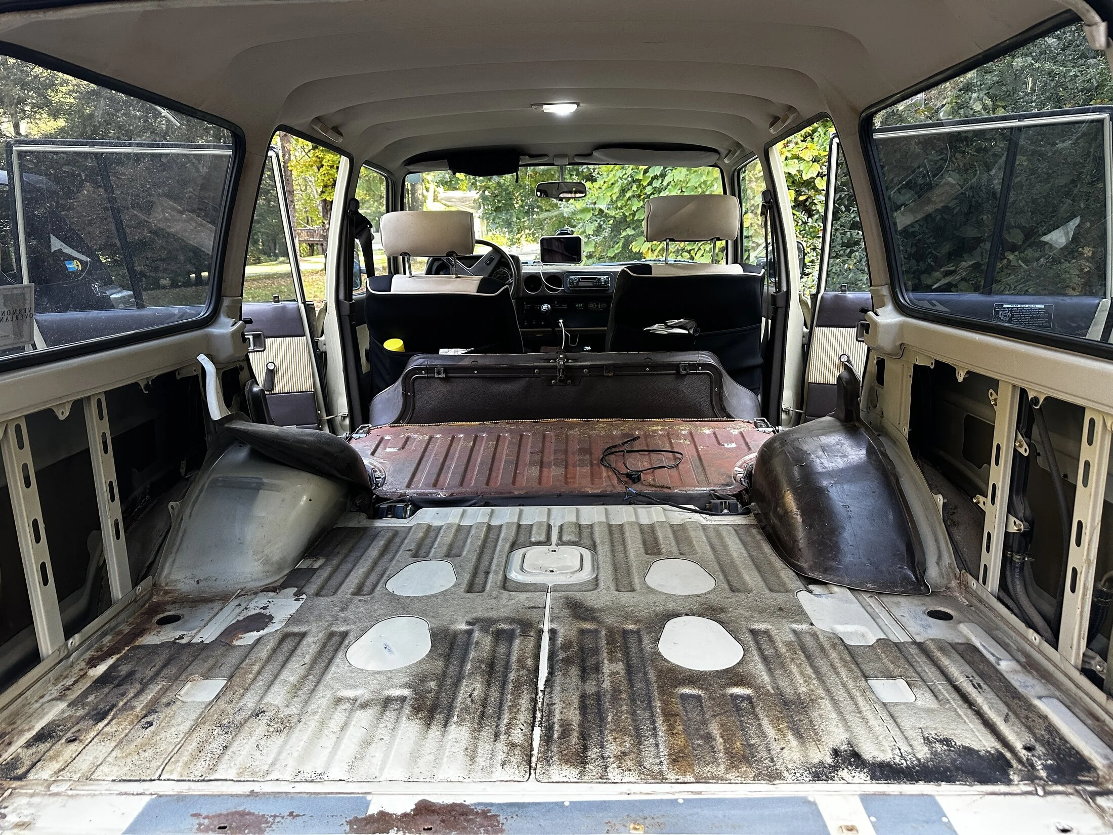

I over did the kilmatt and insulation on the rear quarters and bed just to find out I still got a lot of road noise mostly coming from the tailgate area. Besides the old weather strip leaking air and noise, there is a bit of a gap between the upper hatch and tailgate.
Thanks for the information, good to know! I took it for a test drive and definitely notice the improvement. My tires love to throw big pebbles into the wheel arches and the damping made for less noise.

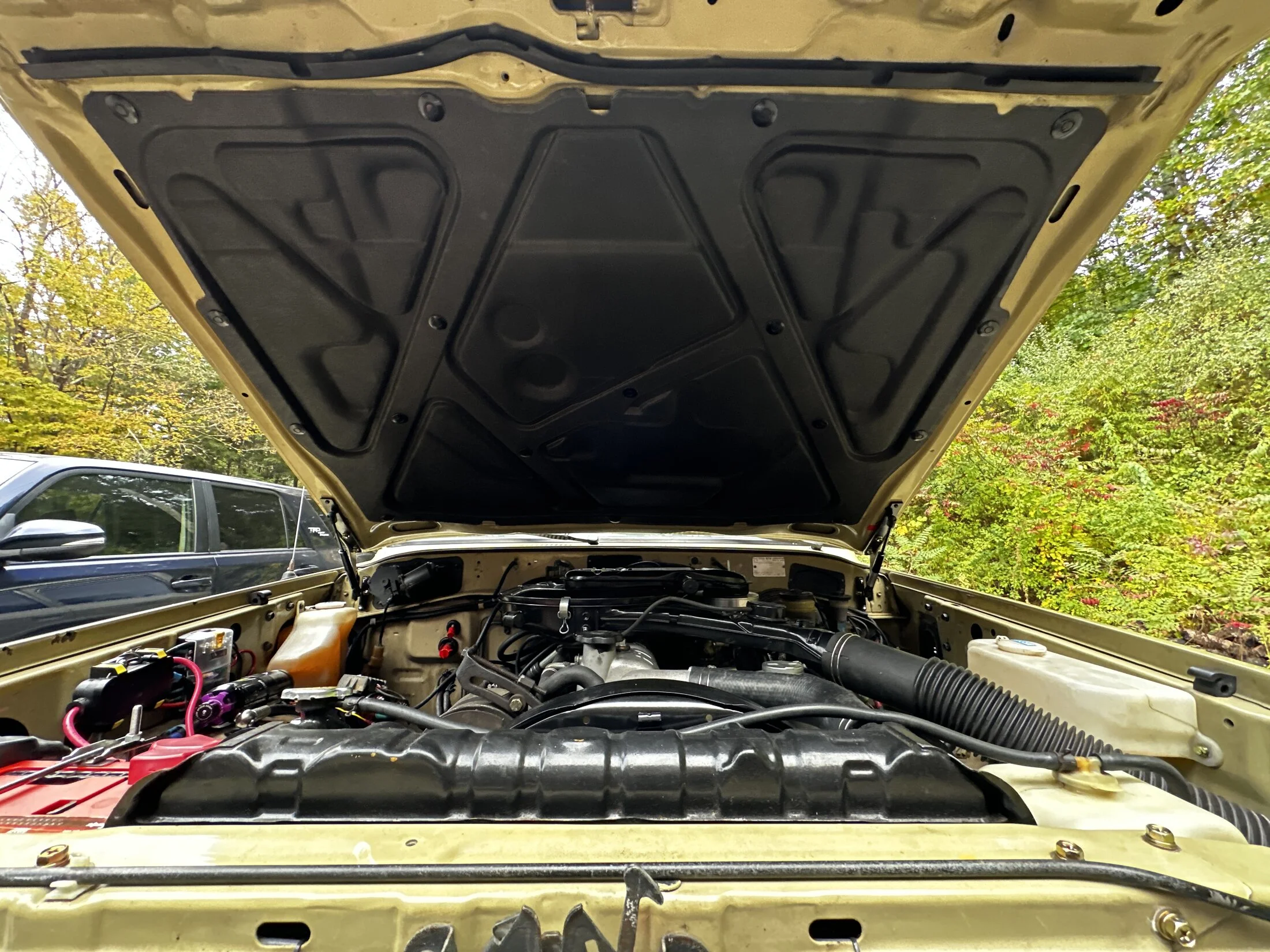

How does the new hood liner compare to the old? Same thickness, etc? Also do you have the part number and a ballpark on costs?
Thank you!
Thank you!
My old hood insulator was in pretty bad shape. The thickness on the new one is slightly less but I attribute that to almost 40 years of use and moisture absorption for the original one. Here is the part number for reference. I got mine for ~300. Prices are all over the place but be careful as many will ship them but fold them up :confused:
@DrRock that looks outstanding! Happen to have the part # for the push on clip holders?
Thanks.

The new hood insulator is a game changer on the appearance under the hood!
