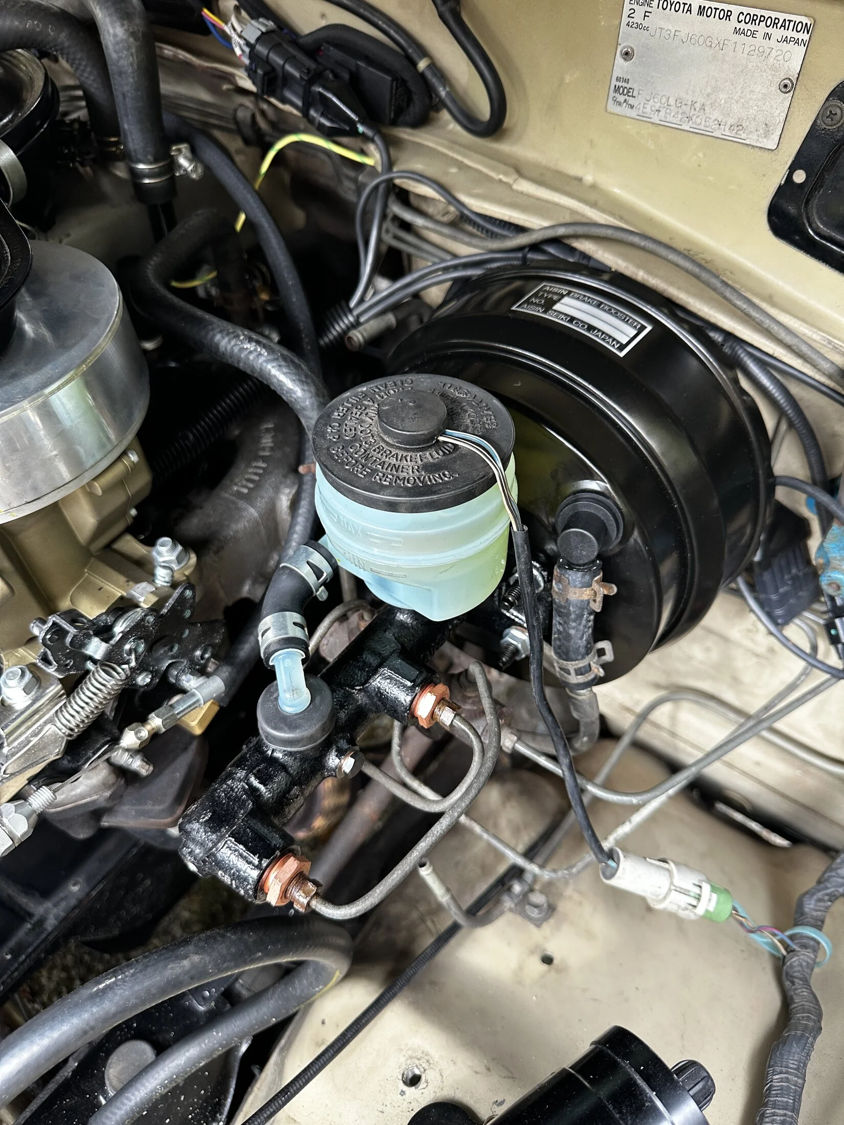

Brake Day! Got my new master cylinder, brake booster and a dodgy front caliper replaced. Nice to get rid of more crusty, rusty stuff out of the engine bay! The new @Racer65 booster is great, nice power and modulation!

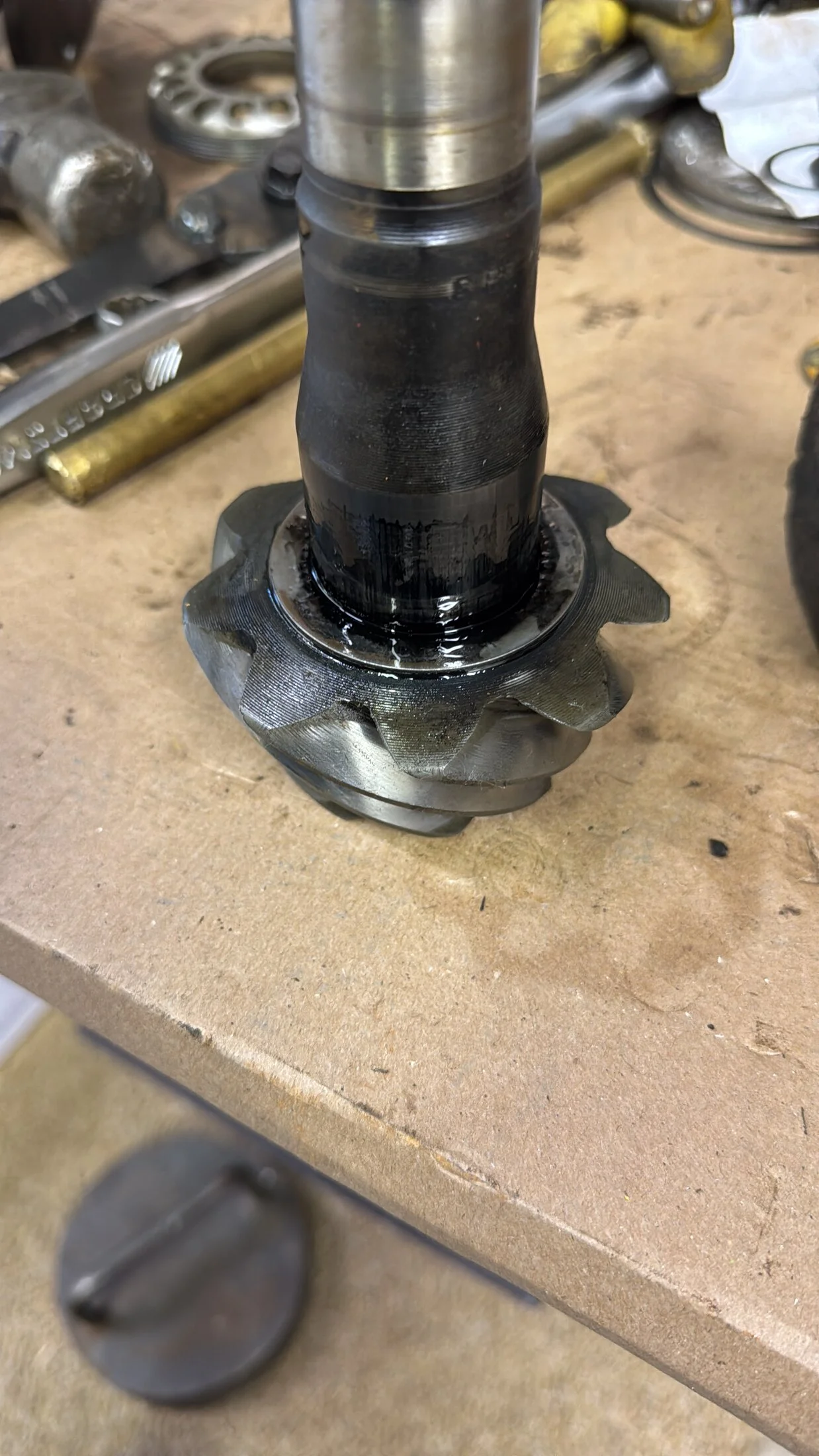

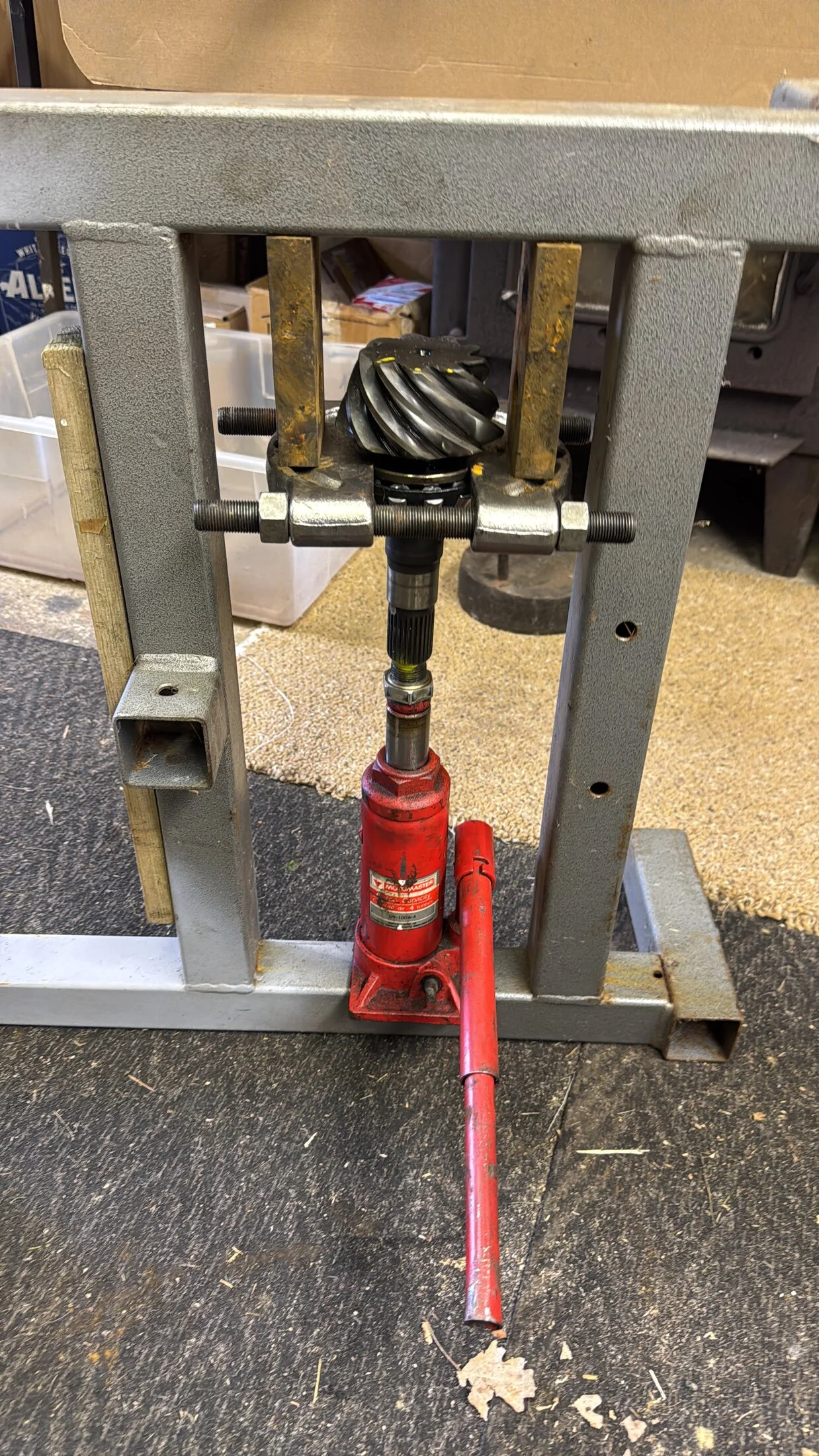

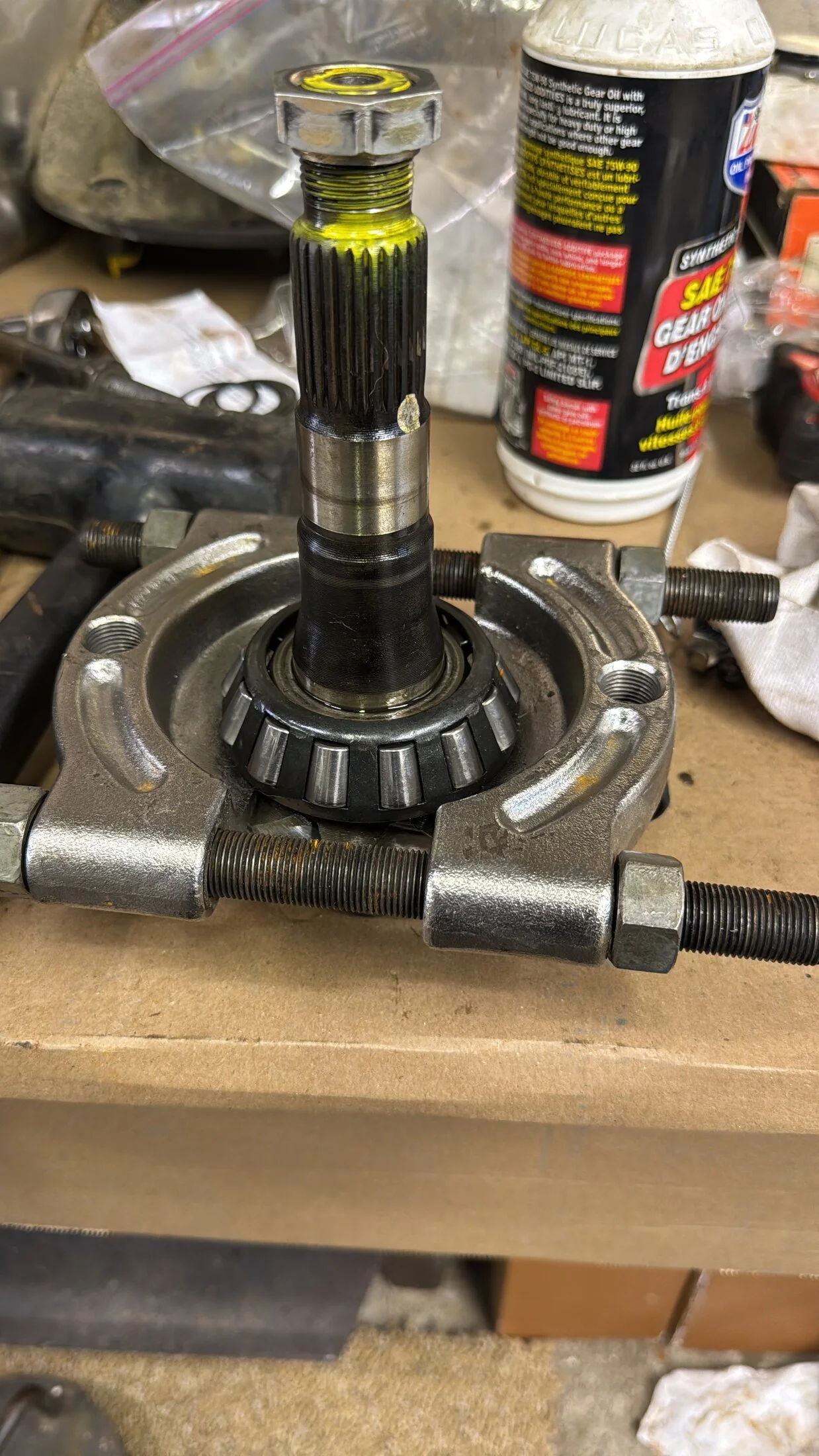

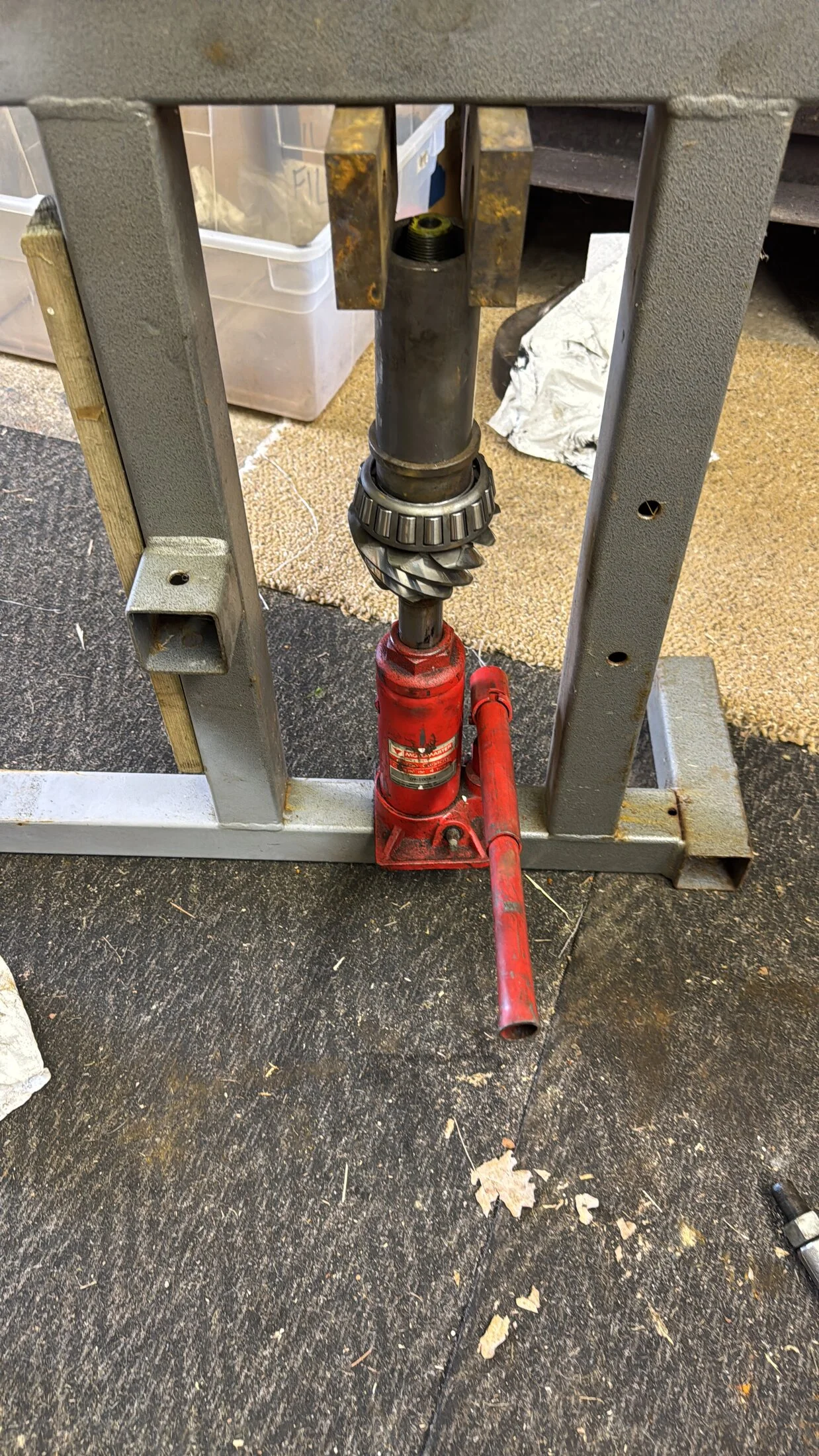

Today I made a press to show it can be done cheap! It’s an old bench press bench. Pushed and then pressed the pinion bearing on today.
Remember, just like the knuckles there are generally shims under the pinion big bearing to set up pinion depth, make sure you put them back!!

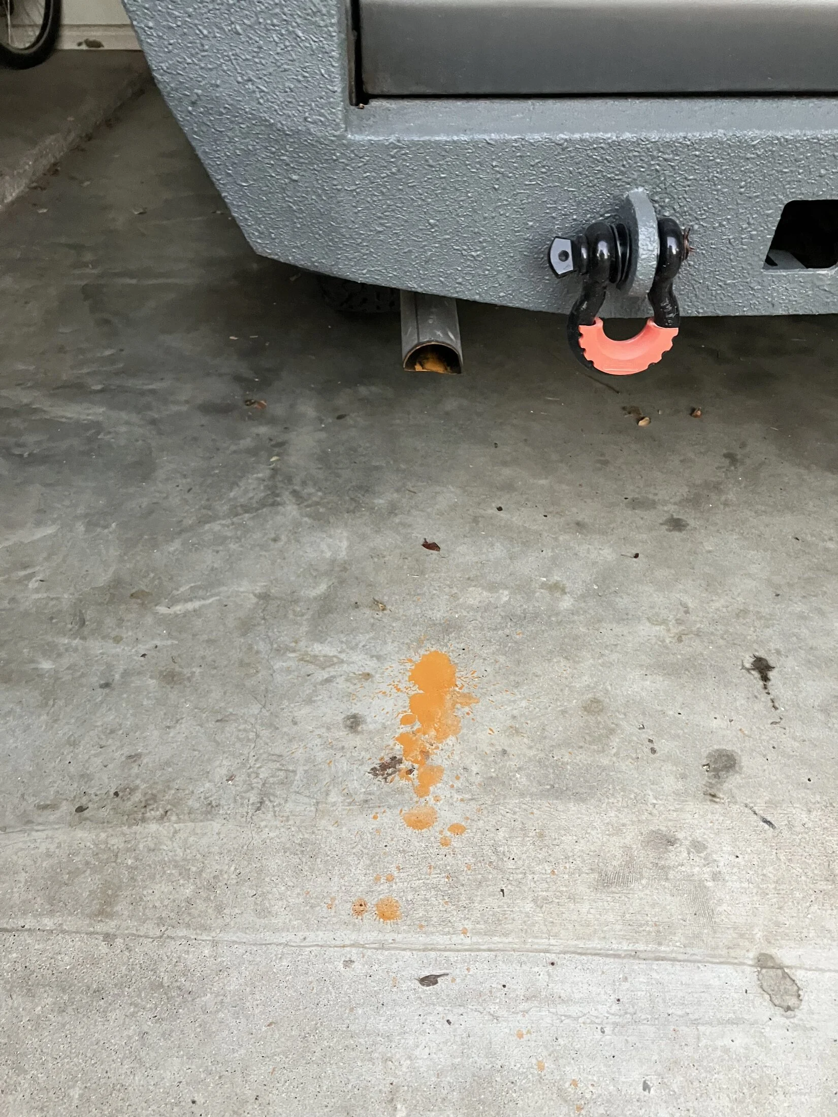

I have been so frustrated trying to find my coolant leak on the Landcruiser. I have to fill about an inch into the reservoir after every drive. I put dye into the coolant and found a small leak on the rear heater coolant lines. Tightened those and then pressure tested the system at 17 PSI yesterday. Couldn’t find a leak after crawling all over it with a black light pen for 1/2 an hour. Pressure stayed at 17 for the whole 30 min. I changed the oil and ran the truck for a few minutes yesterday. THIS MORNING, MY WIFE DISCOVERED THE LEAK! She said “Is that rust n the floor?” Nope…. Know a good head shop?!
Found my coolant leak….View attachment 3739443
I'd start by not buying fuel at that station? Do you frequent the same fuel place like we all do? If they don't tend to their
tanks water accumulates. Took a few months to get water out of the system on my '07 tundra after I bought it. Not sure
where it had been fueled but I suspect the same place every time.
If you think you have a coolant leak, look under the cap for oil in coolant. Look in overflow to make sure it's consistent.
Go over all the hoses and fittings, especially by firewall and under carper inside behind the heater core. Look for drips
and dye staining along the rear heater lines and under the truck. Especially look under the bottom of water pump.

Done all that! Check out my new post titled “she’s hotblooded!”
coolant/oil mixed on dipstick or in radiator?
is the exhaust white? smell like coolant?
does the exhaust clear up once the engine is warm?
does your overflow bottle feed back to the radiator or have the external drip line?
Oil is fine and no visible steam in the exhaust but this was immediately after my pressure test. Check out my new post titled “she’s hotblooded!”
