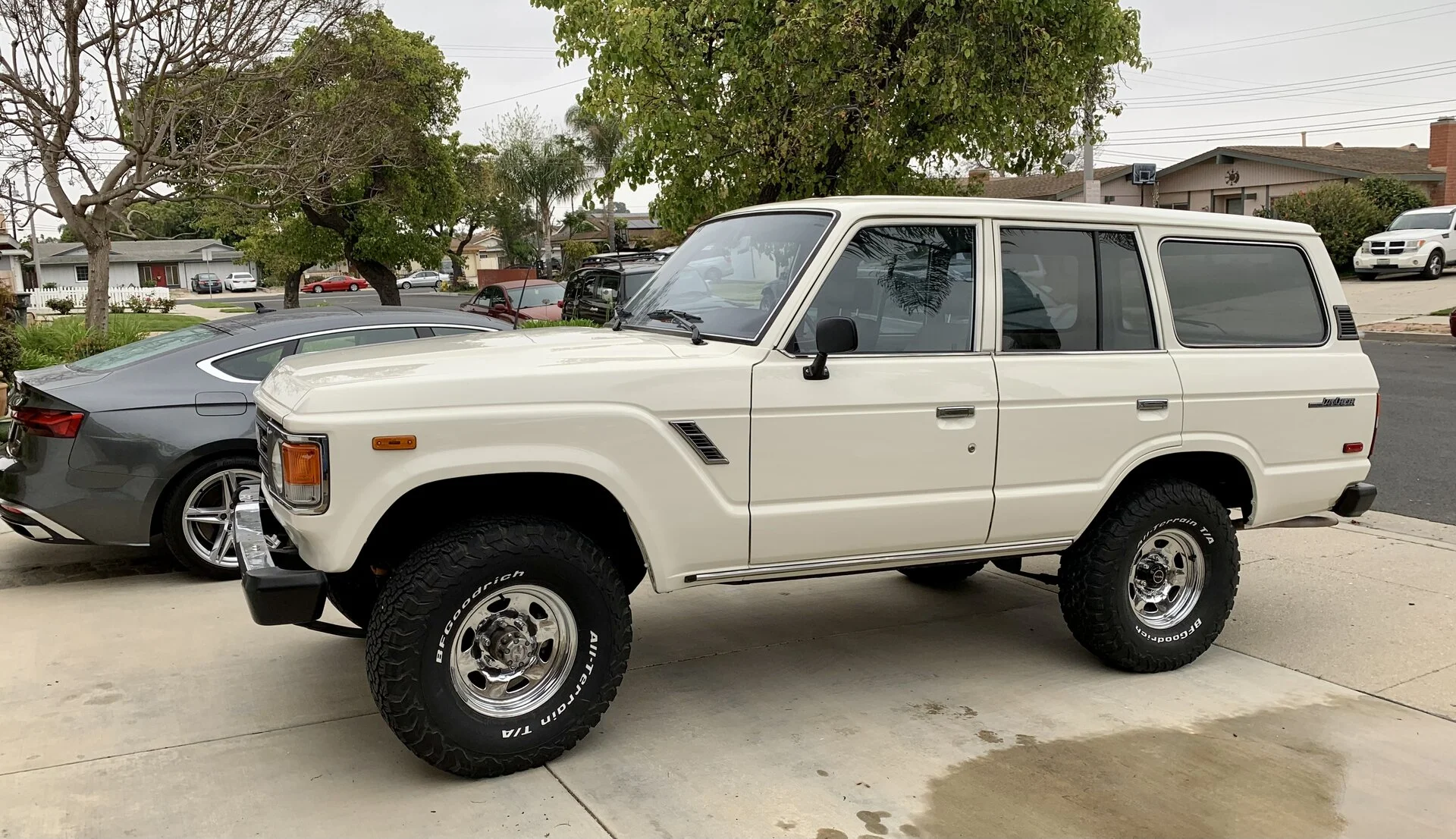

Back to original wheels. Before and after pics…

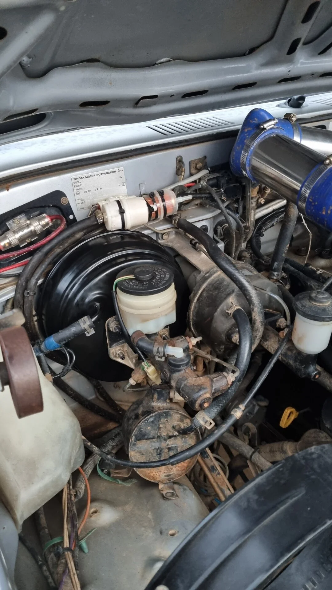

about to be weekend, a friend recommend an a brake upgrade for those tires so I decided to go with fZj80 beake booster form Advics “from Aisin” and rebuild the front caliper.
Installed an 80 series brake booster in the quest to get a bit better stopping power - this is 44610-60570 which is for a HZJ80 and puts the vacuum hose pretty close to factory for an RHD FJ62.
Its very tight with the clutch booster but does fit.
good to know about this part number, as you may saw mine has different vacuum hose location.

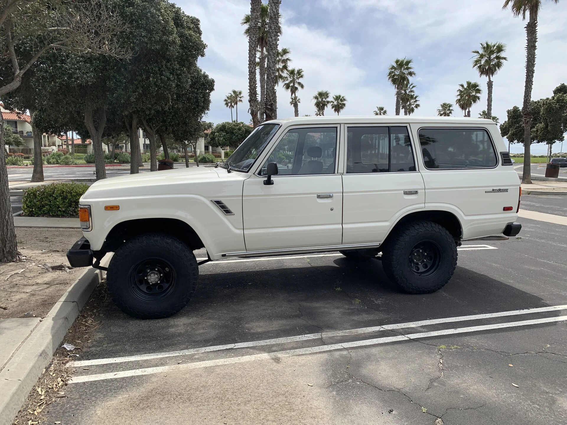

Got my wheels and tires mounted up and pulled the tranny to rebuild the t-case and prep for the H55.
they are fire for the 60s, but did you play with the gas pressure or you kept it as is?
I kept mine as is from the factory. Will tinker with them later. Out of the box, the ride was markedly improved.
