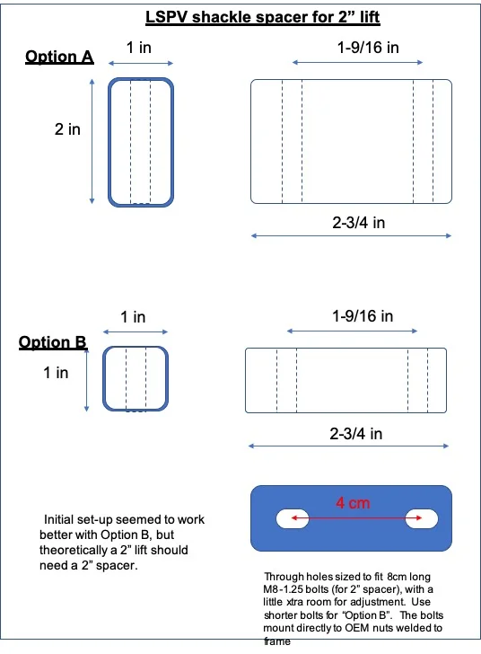

I need to add a spacer. Do you happen to have the spacer you didn’t use handy for measurements? Do you recall what size hardware?
Hi NearJetties...I was away from the house and just saw your post. Sorry for the late reply. I do have the hardware, but I had a drawing I used to make the part which might be better. I made a 1" and 2" tall spacer, but the guys that installed the LSPV seemed to like the shorter spacer.
Theoretically the 2" should be correct for a 2" lift ...at least you'd think that. I've not yet gone out to test my brakes to compare the before and after stopping distance, but they feel OK. Honestly, replacing the rear drums, booster, master cylinder and LSPV help just a little for the brake feel, but I'm not sure the brakes will stop better than before I started this job. I have new front calipers and rotors which I hope make a noticeable difference.
See picture below:
Amazing. Thank you!

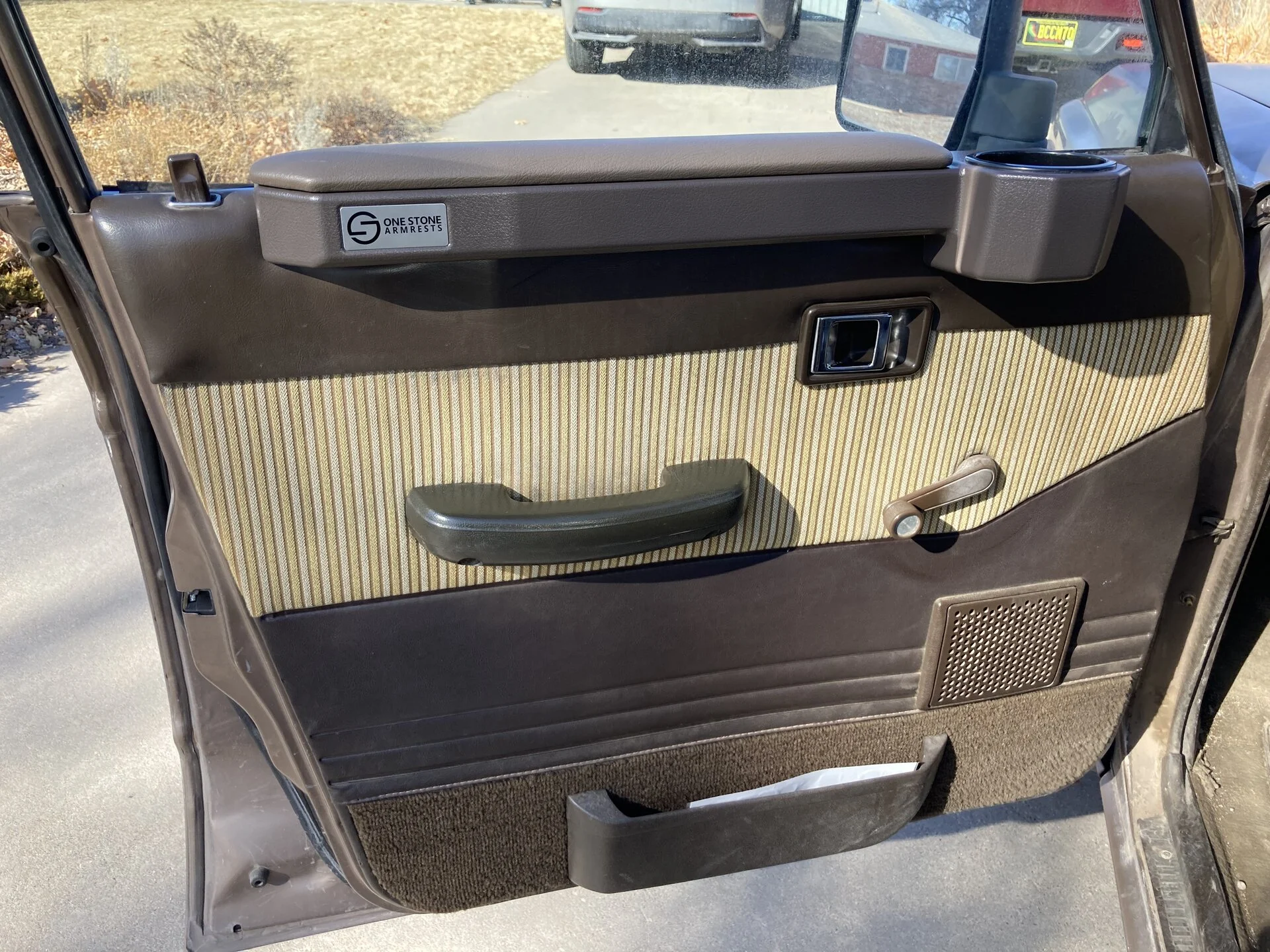

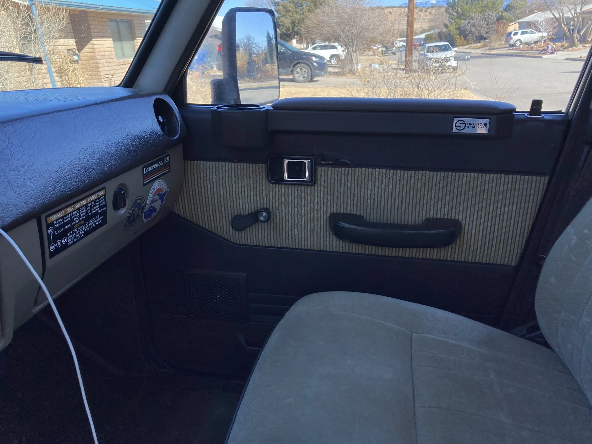

Do those require modifying or putting holes in the door cards?
They sure don’t! Only had to make minor modifications to the bracket that rests in the window track. Took about 15 minutes total, the armrest is actually held on by 2 big magnets- pretty clever!
